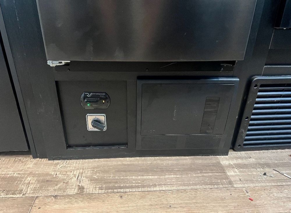

I dislike all automatic transfer switches. They're an un-needed, relatively expensive, and sometimes failure prone, item that I just don't see the added convenience in. I put a manual transfer switch in my inverter system (the silver backed switch in the picture below).
Position 1 (as shown) is shore power, position 2 (straight up ) is all off/ everything disconnected, position 3 (turned the the right ) is inverter power.
So I always know what power source is feeding my camper and it won't be constantly switching back and forth as the shore power flickers during a storm. My exterior surge protector (Bluetooth readable from inside the camper on my phone) tells me when the campground power is back on.
