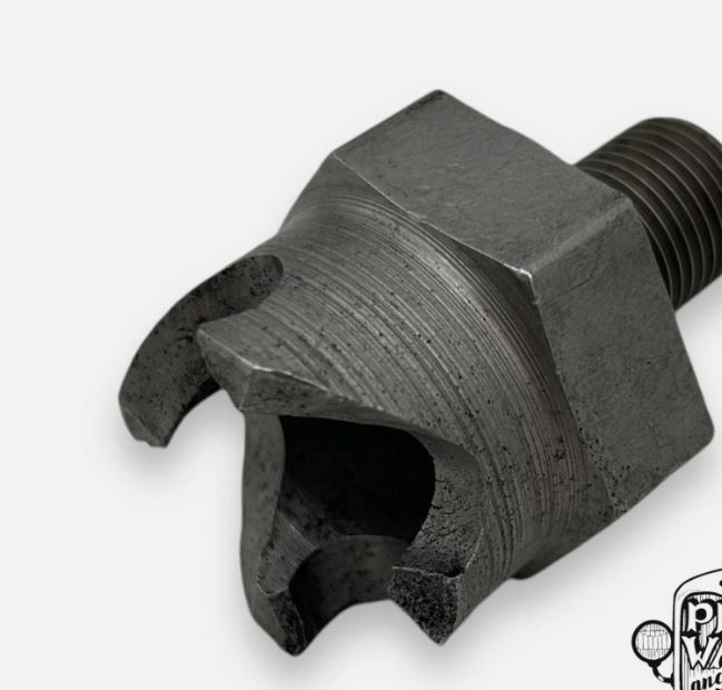

Wish to turn the crank of mine F1 49 engine 226 to adjust valves but do not know the measure of the pulley bolt to fix a socket. Hard to enter with hand/view the bolt with radiator in place.Somebody knows?

If the engine has the provision for hand cranking, a deep socket is required.

I got it: 1" or 25,2mm socket for the hand cranked nut.
Thanks to all,
- Keep dreaming on find a hand crank to use my original nut when battery is down or motor starter brokes.
