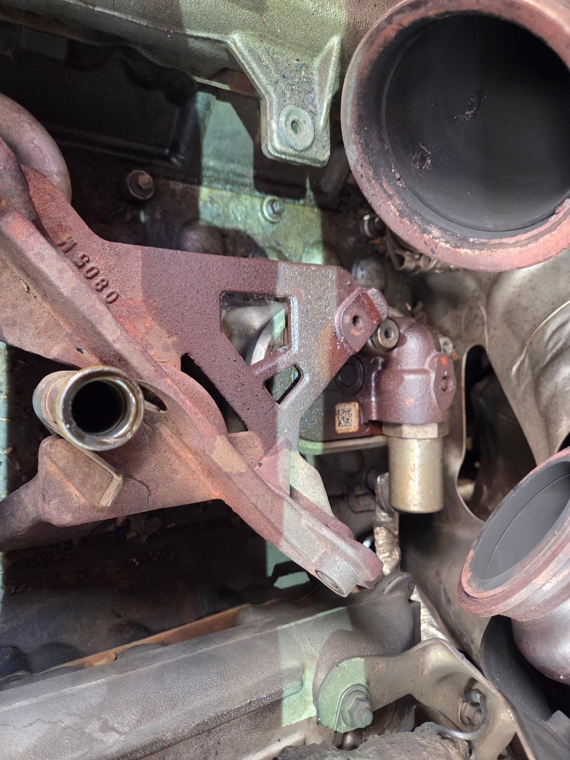

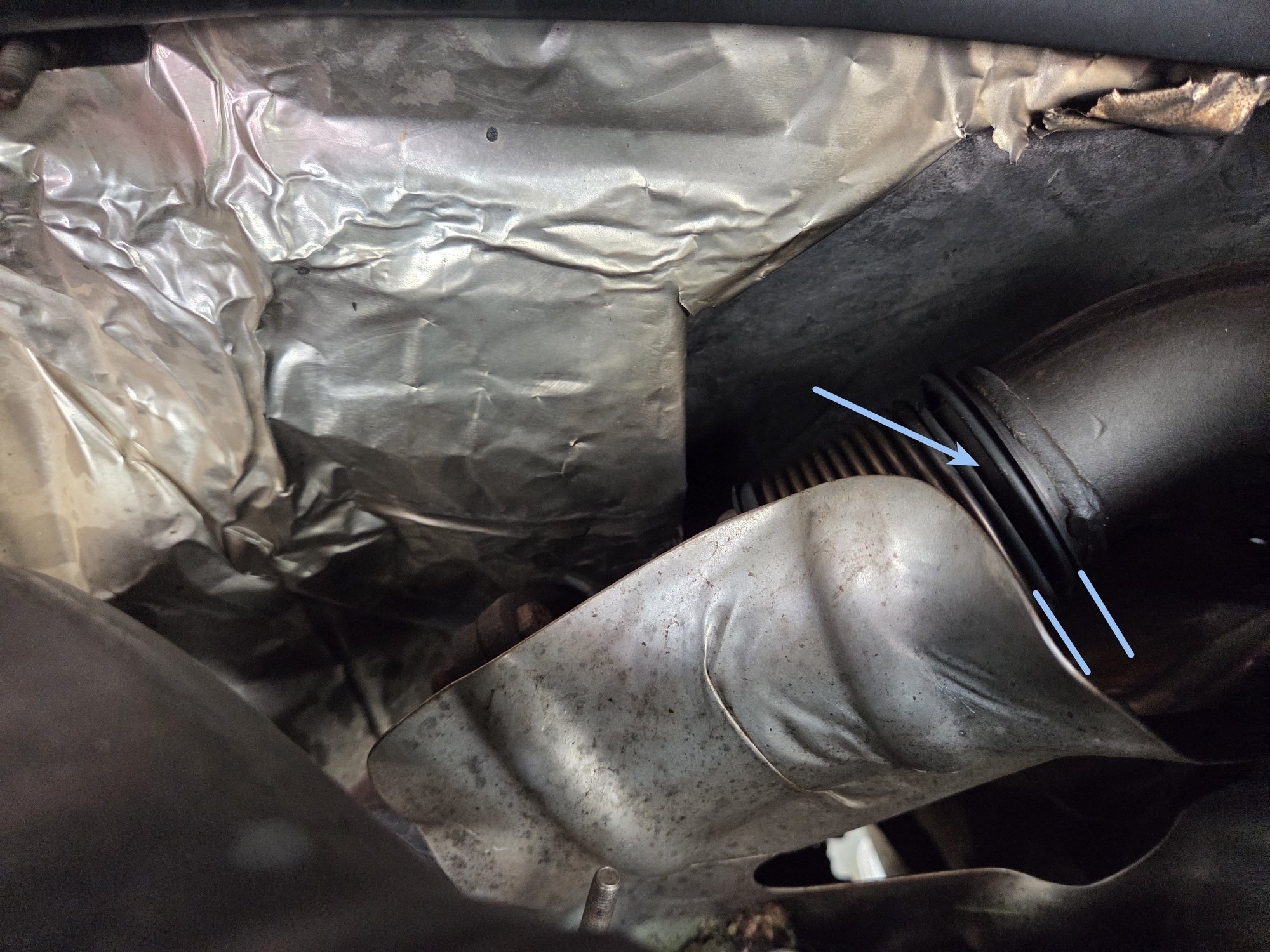

Okay well I definitely found a problem! Also a thanks for all who assisted and helped figure out how to get the back bolt off the turbo, yes I was laid flat over the front of the tuck but it worked!!
The bellow on the Y pipe is totally separated.
Broken up Pipe
Broken up Pipe
I am still at a loss, and have a question no one has answered on: Would this make the truck stall and not start for ~5 minutes?
Also I have new questions:

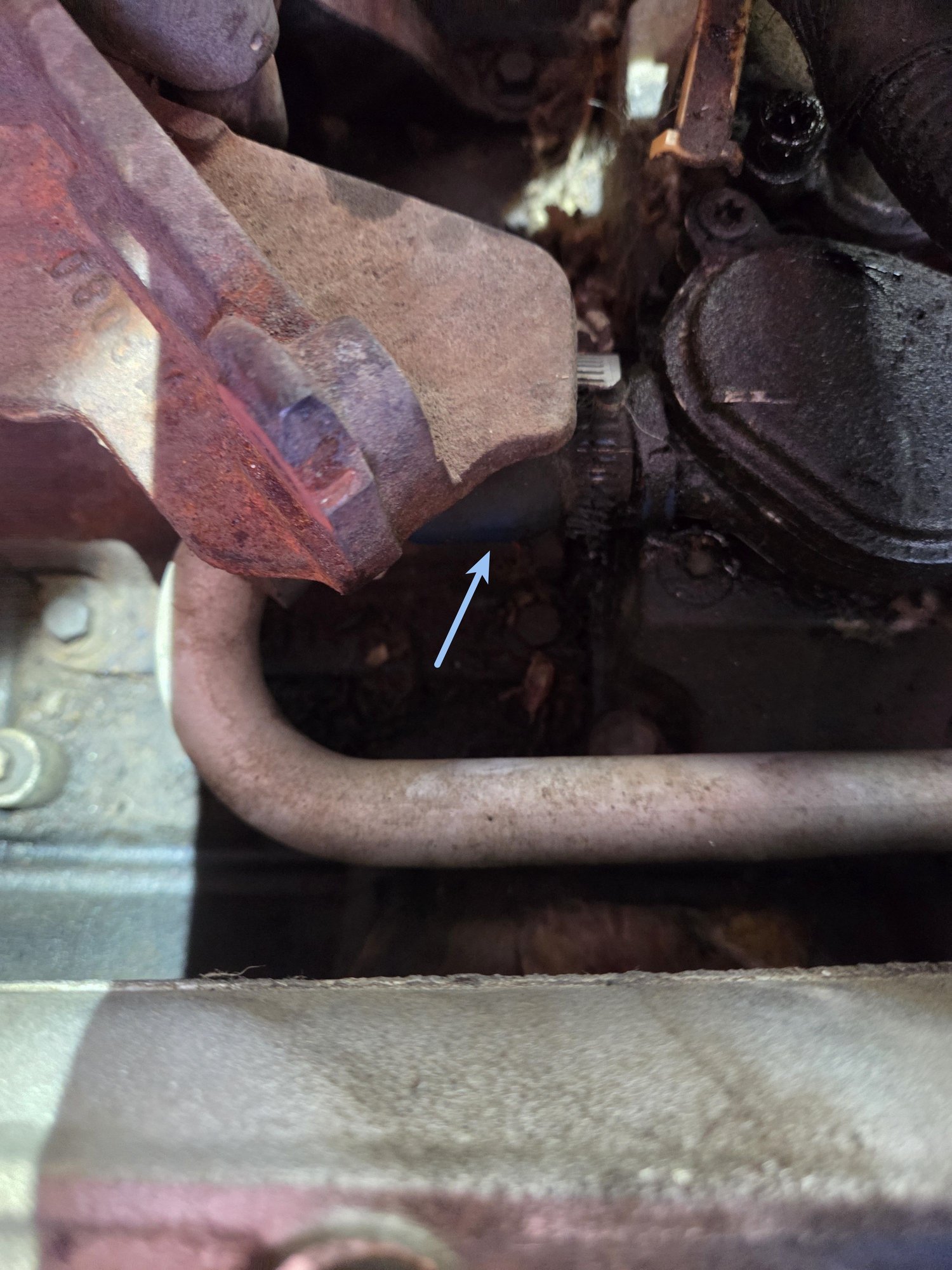

1) There is a blue hose, not sure if you can see it, but looks stressed to hose clamps being tight, I would like to replace this if possible, it this a special hose? what is it called?
2) Near the hose there is sometype of plate or device that is oil covered? What is this, how do I fix that?

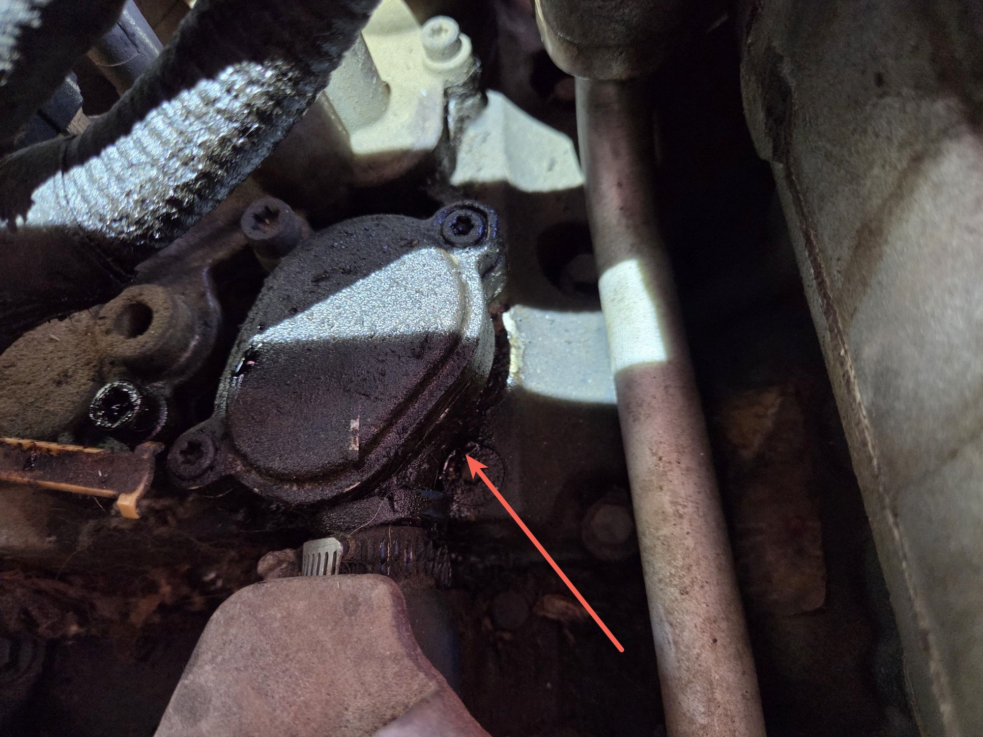

3) This is a 2005 - I heard that I should change the STC connector, not sure what it is but it is supposed to be on the HPOP, can I tell if it has already been changed? and if not should I change that while the turbo is off as well?
4) Last question - I am not sure if the Turbo is bad or has an issue, there is oil in the housing etc. I have a new not reman Garret Turbo on it's way, do I use the old Turbo and send the new one back or go with it? The truck has an unknown but hard history, picked up from used car dealer, they picked it up from an auction and CARFAX shows it was auctioned after a total loss supposedly from hail damaged but that make zero sense to me.
Thank again

Looks like your oil cooler needs to be resealed. That blue hose is the oil cooler to EGR cooler coolant hose. People use those and they don't grab on to either end well as both ends are two different sizes.
You'll need a Motorcraft oil cooler seal kit. You'll want to backflush the cooler while it's out.

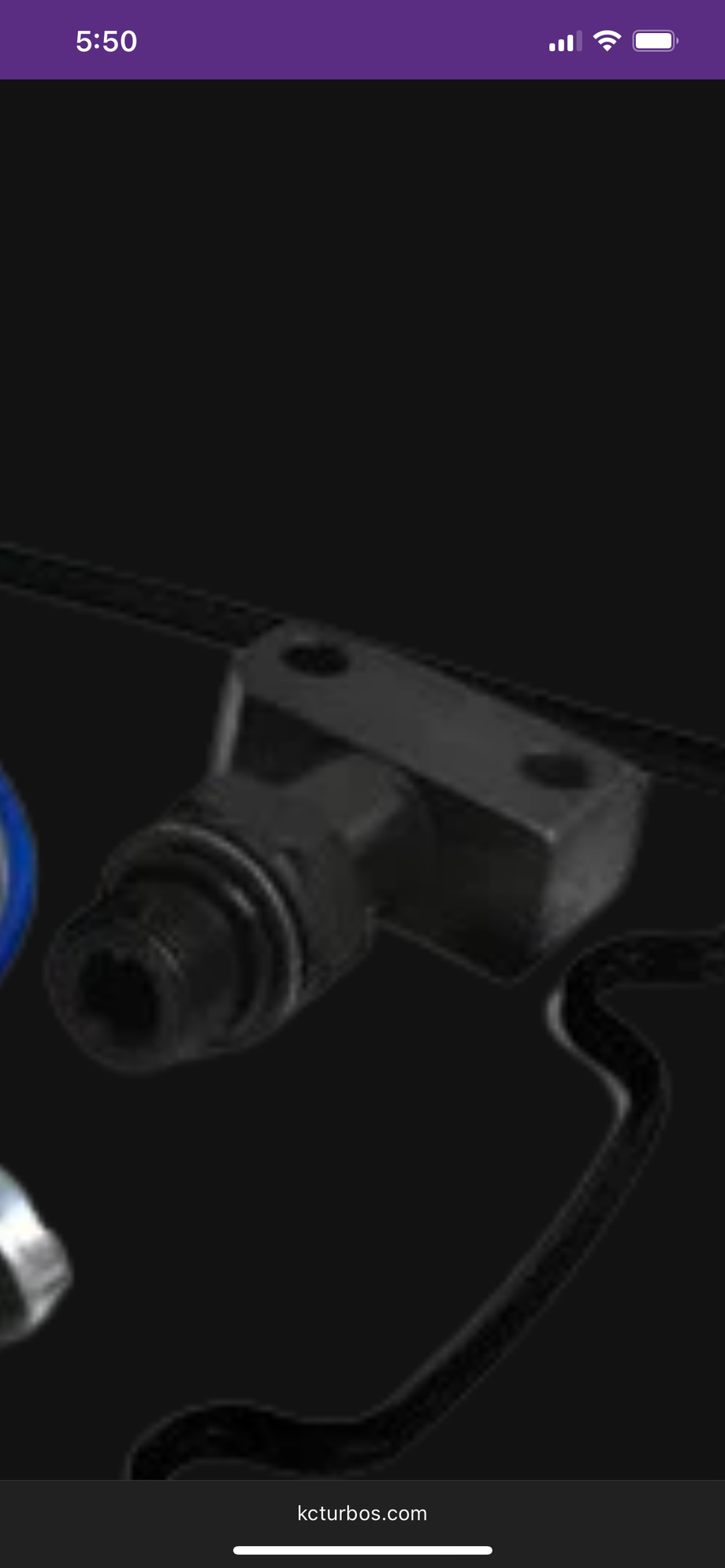

3. The STC (snap to connect) fitting is on the back of the HPOP. The update is a one piece fitting and comes with an alignment aid. They have been known to leak and under high pressure come apart. Not a great picture but hopefully you get the idea.

2. You'll use the blue Motorcraft oil cooler to EGR cooler hose that doesn't leak like the blue hose in your picture.
