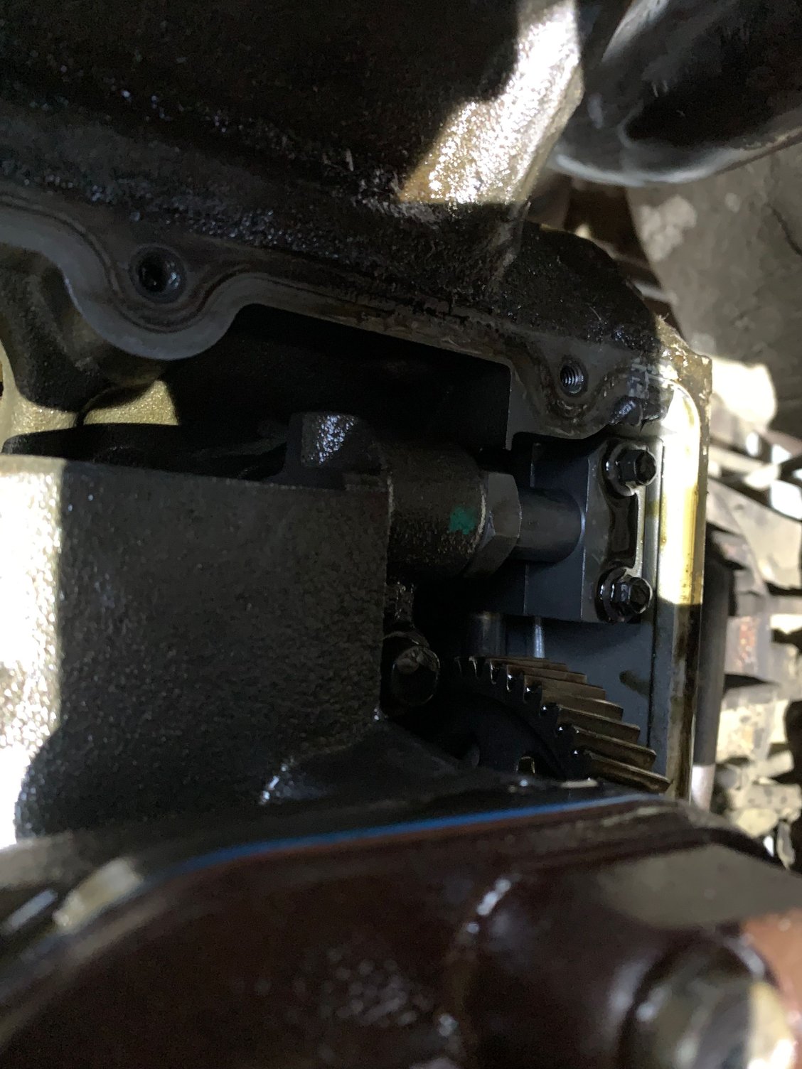

Removed HPOP Cover - New Style Fitting
It appears it is a new style fitting? Do I change anyway or just seal the cover?

If it were me, I’d make sure it’s tight and move on.
