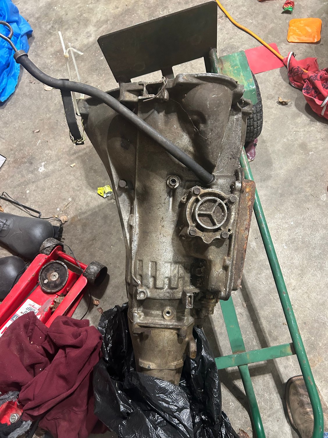

I will post a photo in the moments tonight when I get home of what i bought I and hoping the gentleman bought it from was wrong in telling when what i came out of what i know for certain is its a floor shift.

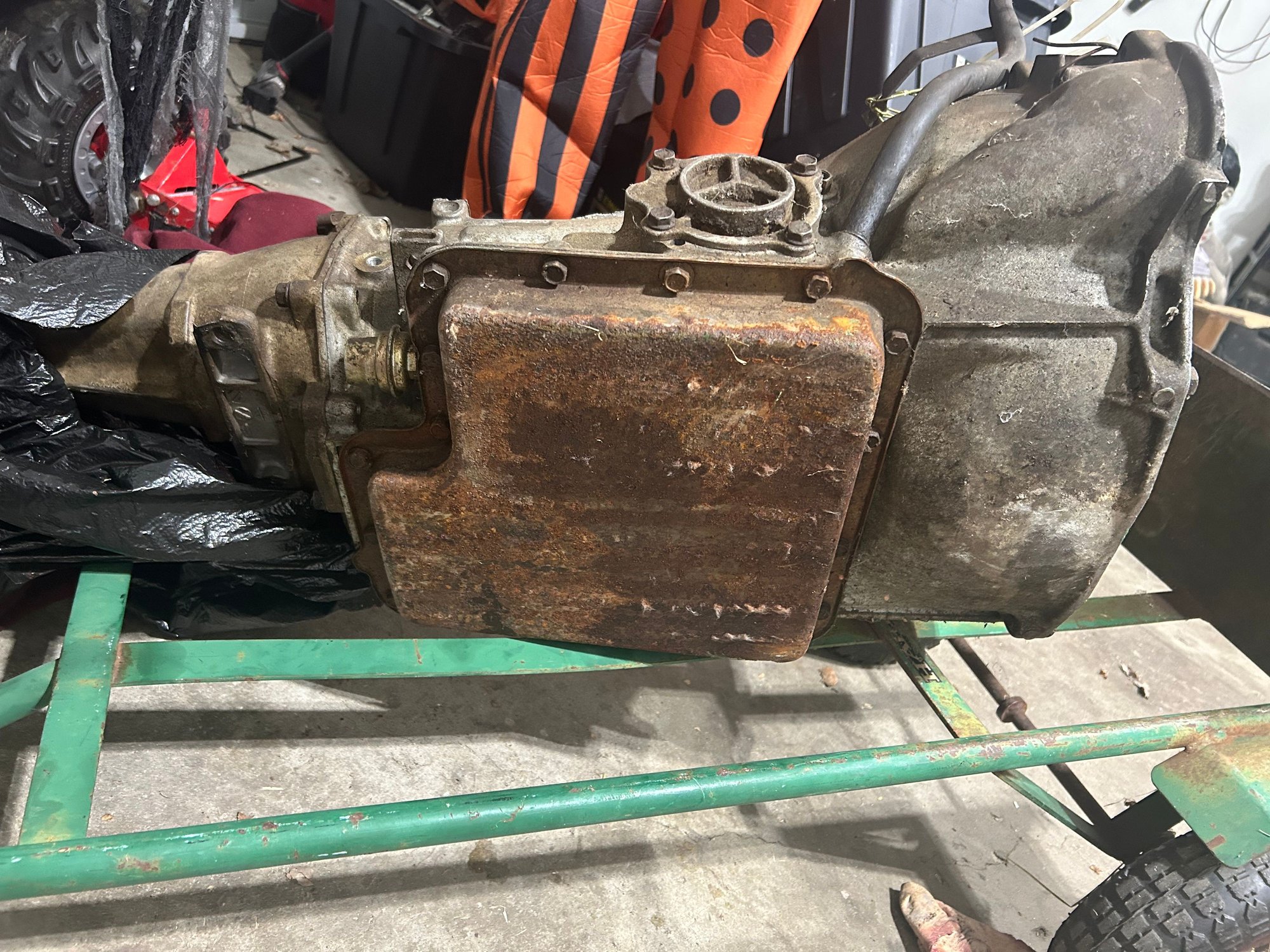

Old Oct 20, 2025 | 09:05 PM
Jdrain's Avatar
Jdrain
Trailering
Joined: Oct 2025
Posts: 23
According to the information I have this is a small block c6. I just need to know what i have to do to make this work.

The E4OD is longer than a C6, so you'll need to lengthen the driveshaft and modify or move the transmission crossmember to make this fit.
That does look like a C6, but the C6 wasn't available in an '87 Mustang.
