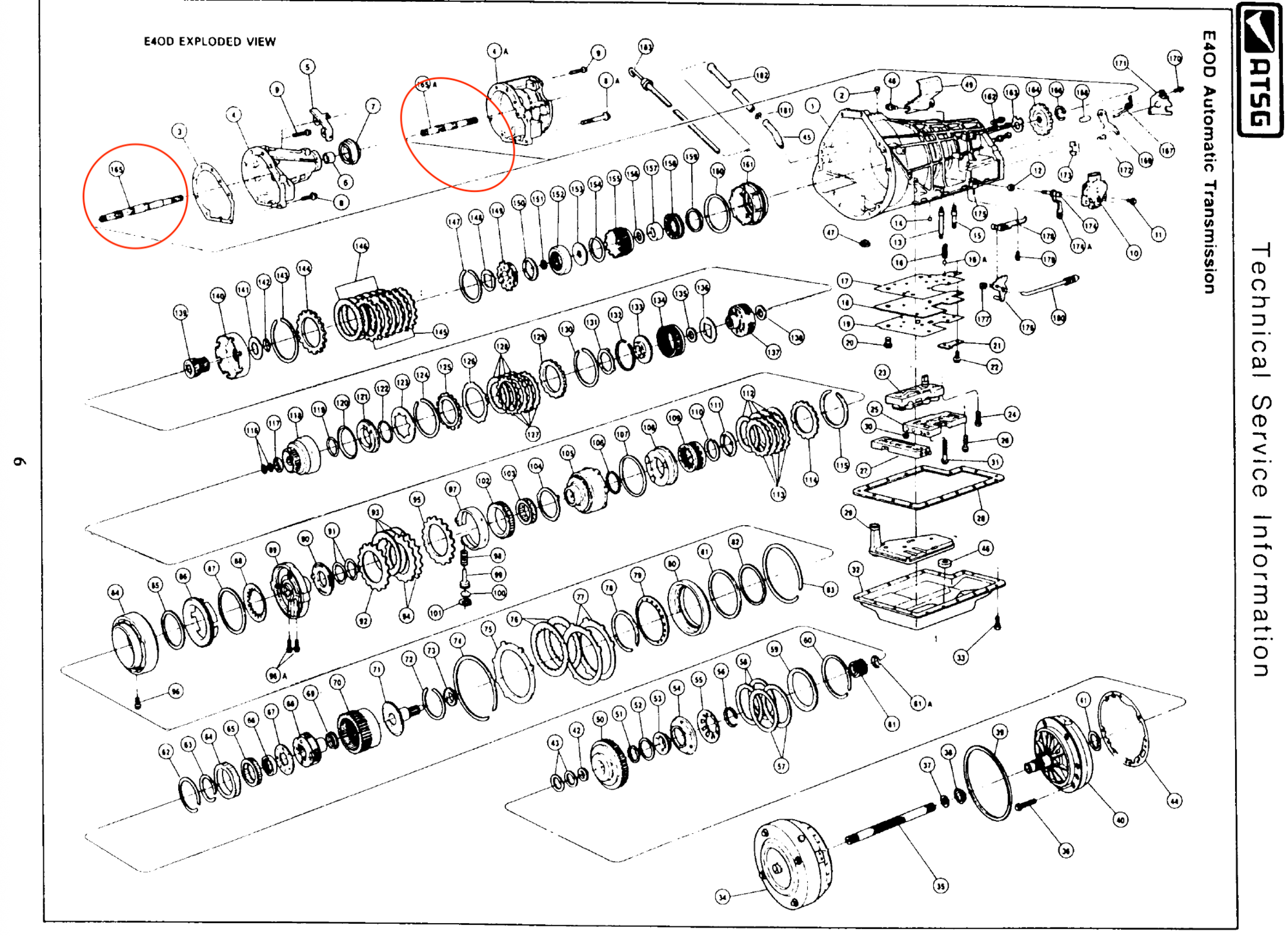

I want to thank everyone who posted and gave me the information and insights. i have decided to to rebuild my E4od/ just replace it with one I find locally. has anyone rebuild one before? on the difficulty scale were does it fall for someone who has never rebuild a trans? i do have someone picking up the C6 i bought tonight so I'm not loosing money thankfully. I can find good 4x4 transmissions all over my area. could i just swap output shaft and be ok or should i keep searching for a 2wd and avoid the hassle?
I would say difficult to extreme, not easy.
The hardest part is sourcing custom tools. I made mine.
If you get a 4x4 trans, you have to take it 100% apart to change tail shaft and housing.
I have only ever rebuilt one trans in my life, a few years ago, still going strong with over 50,000km.
Here is my E4OD rebuild thread: https://www.ford-trucks.com/forums/1...now-apart.html
Details start here: https://www.ford-trucks.com/forums/1...l#post18550983
I think it is well documented, could be summarized. Have a look and you decide.

Find the 2wd trans as swapping the output shaft usually requires a complete teardown.

By compete tear down meaning I cant pull the shaft out with all the clutch packs on the shaft and just slide the 4x2 shaft in place of it?

It all loads from the front end.
A brief comment from a former Ford transmission engineer who worked on the E4OD:
Correct, you cant, can't, cannot.
Everything needs to come out of the trans to change the output shaft. It's the last part out, and the first part in during the rebuild.
Cirlced in red, 2wd vs 4wd
