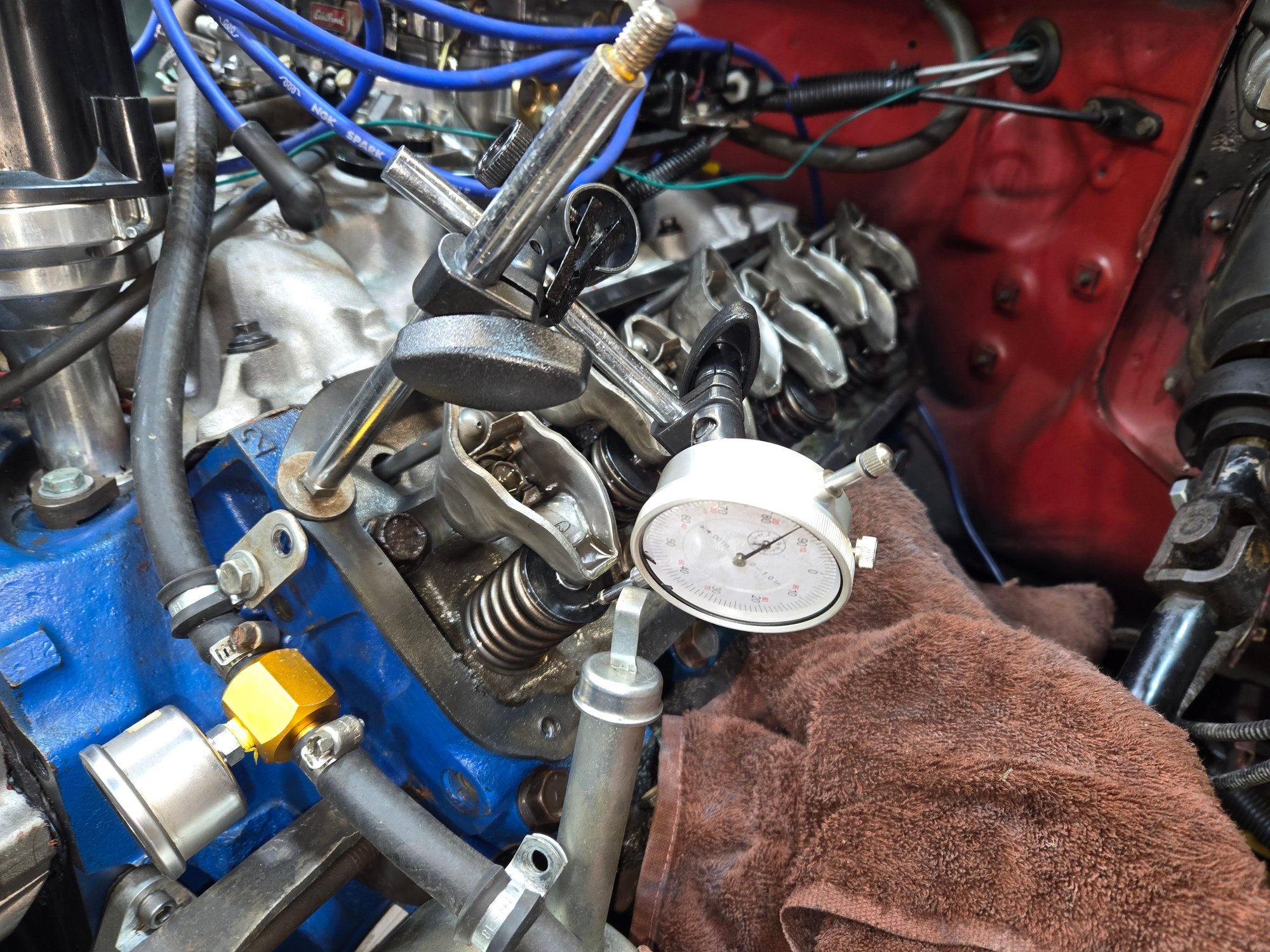

Alot of good input. Much appreciated. i modded my dial indicator so i could screw it into the valve cover bolt holes. I took some measurements; see photos. None of the lifts are correct. Of course the lifters aren't pumped up but where I was expecting at least .45, i was getting .2 or .3ish. i took a close up pic of my re-used lifters. Im going to pull the the cam. I was reading alot in Tom Monroe's book. Can anyone confirm that Ford made a conn rod change in the 351C's to +..060 inch pushrods? To something longer than 8.4" (which mine are). Won't help my situ but I'd like to make sure i've got the correct pushrods when i redo this. I guess the bottom line is about half the lifters cannon be torqued to remove looseness at TDC of the given cylinder.
Someone asked about break-in. I used high zinc oil, ran for 25 min at about 2500 rpm. Have done this a few times with other engines; no issues. The engines all had adjustable lifters. I got too careless with this non-adjustable setup. Break-in was on an engine stand and seemed to be ok. It's my inexperience that kept me from doing a post break-in detailed checkout on the stand before I installed in truck. Anyway, i'll update all when i pull cam and lifters.. Thx again for all advice. There was a suggestion about checking for rotation; i'll try that tomorrow after work. FYI this is a mild rebuild w/ 351 2V heads, keeping the manifolds, Edel Perfomer ink and 650 vac sec carb.
