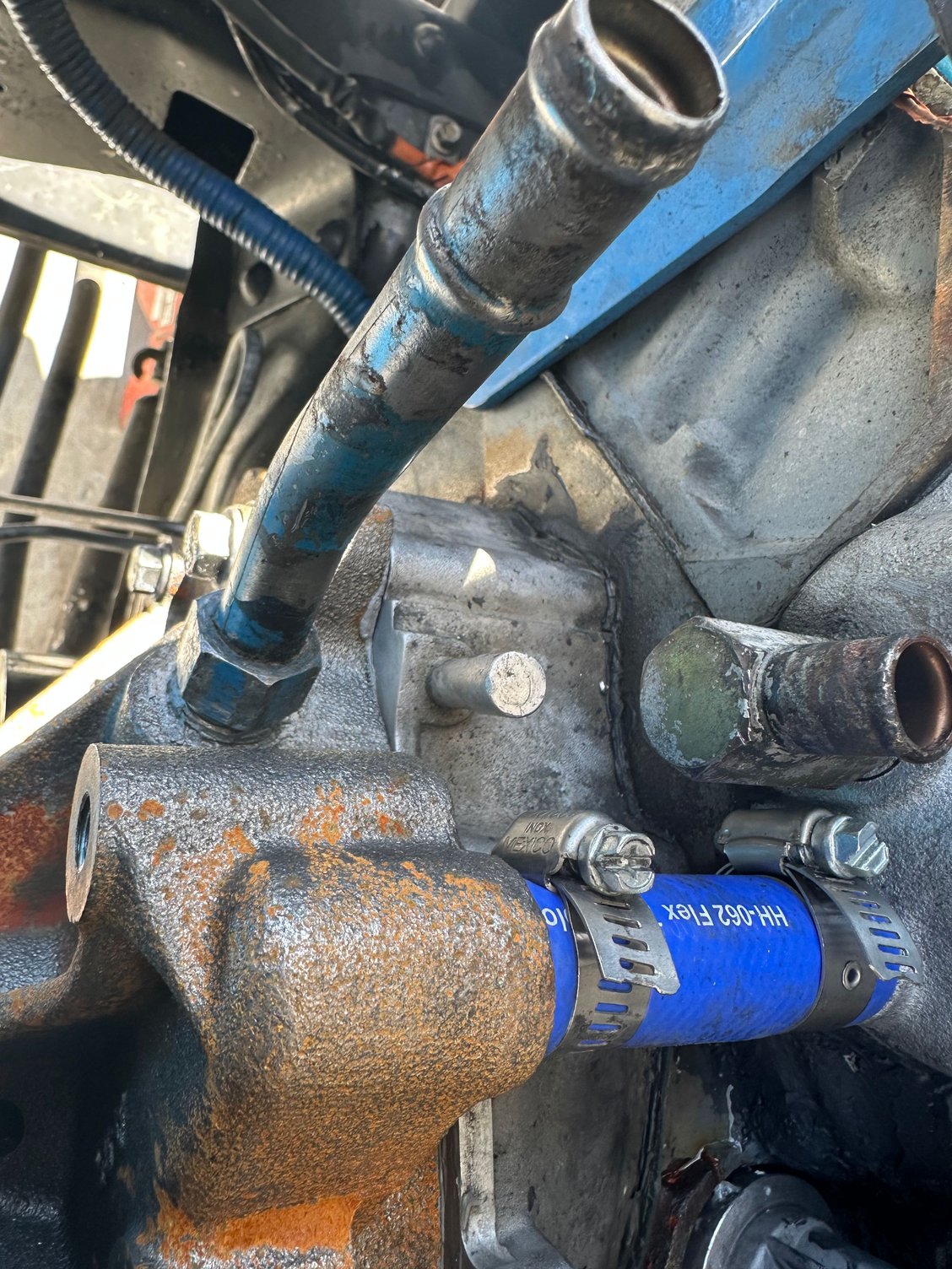

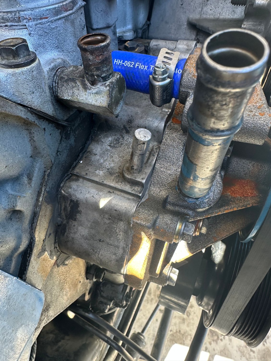

94 F350 460. My Son’s truck has a block off dowel in his timing chain cover on the top. It’s definitely not the original cover. What was supposed to go in the hole that is blocked off?

Dipstick for passenger car front sump cars.

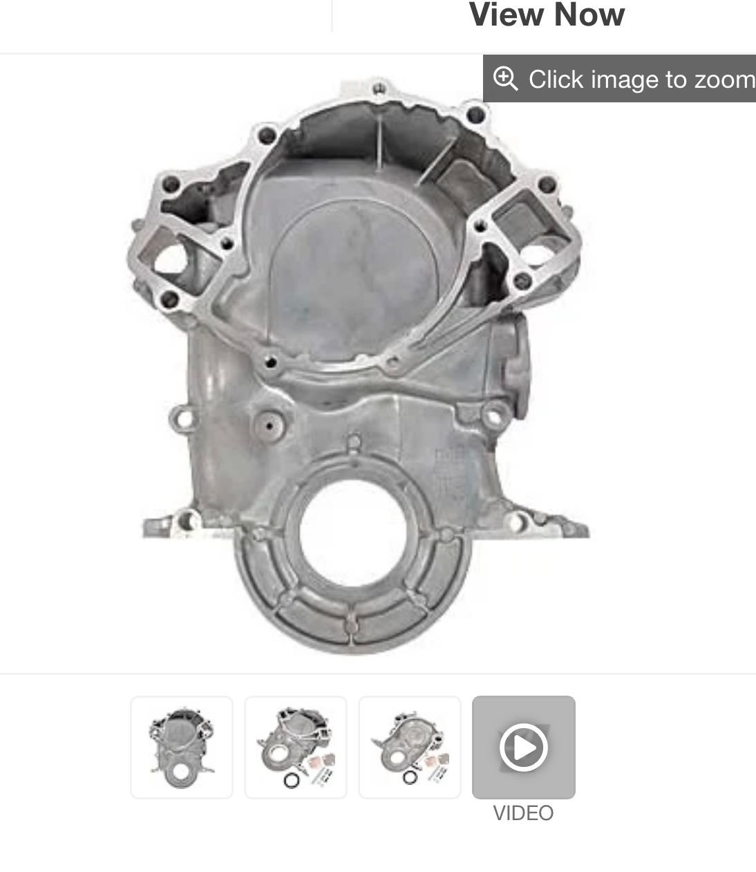

I don't think there was ever a reverse rotation water pump for 429/460s. Even the 2-belt faux serpentine (flat ribbed belt) '90s trucks were standard rotation.

Mine looks exactly like this, so I would the rotation is the same
