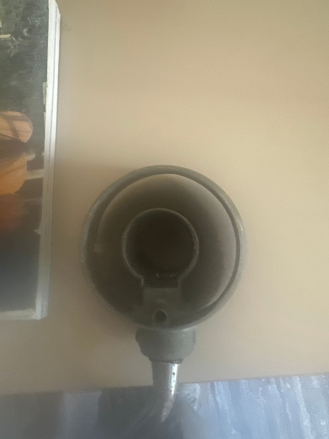

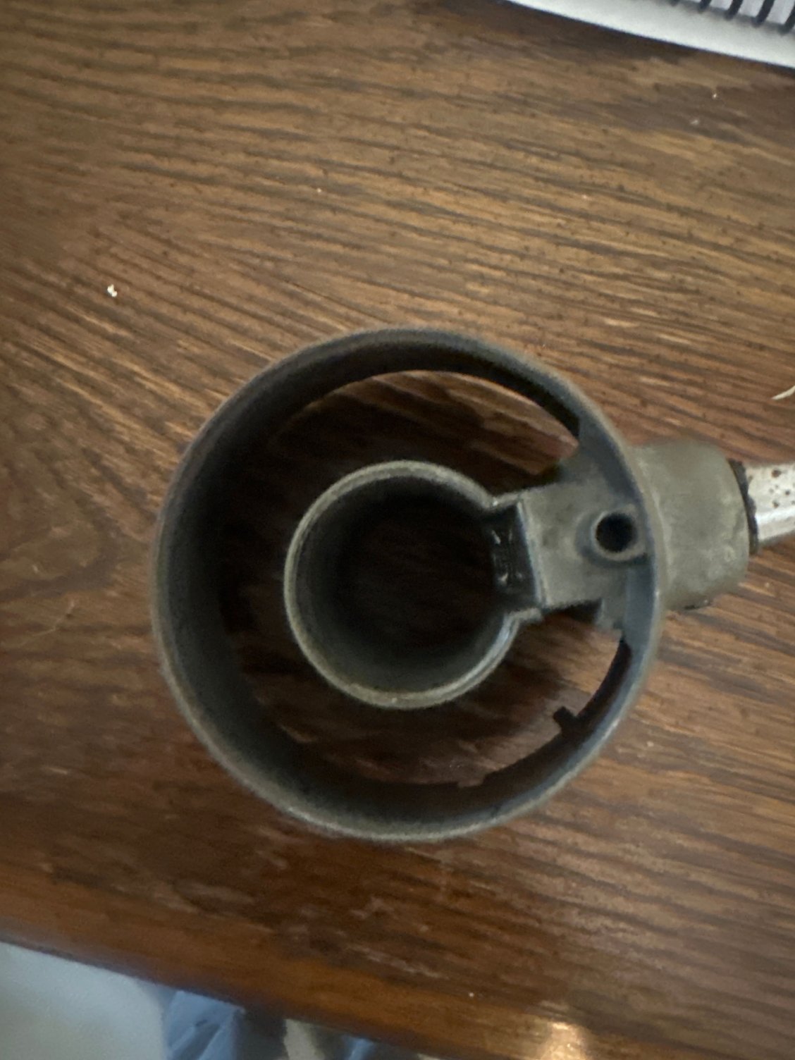

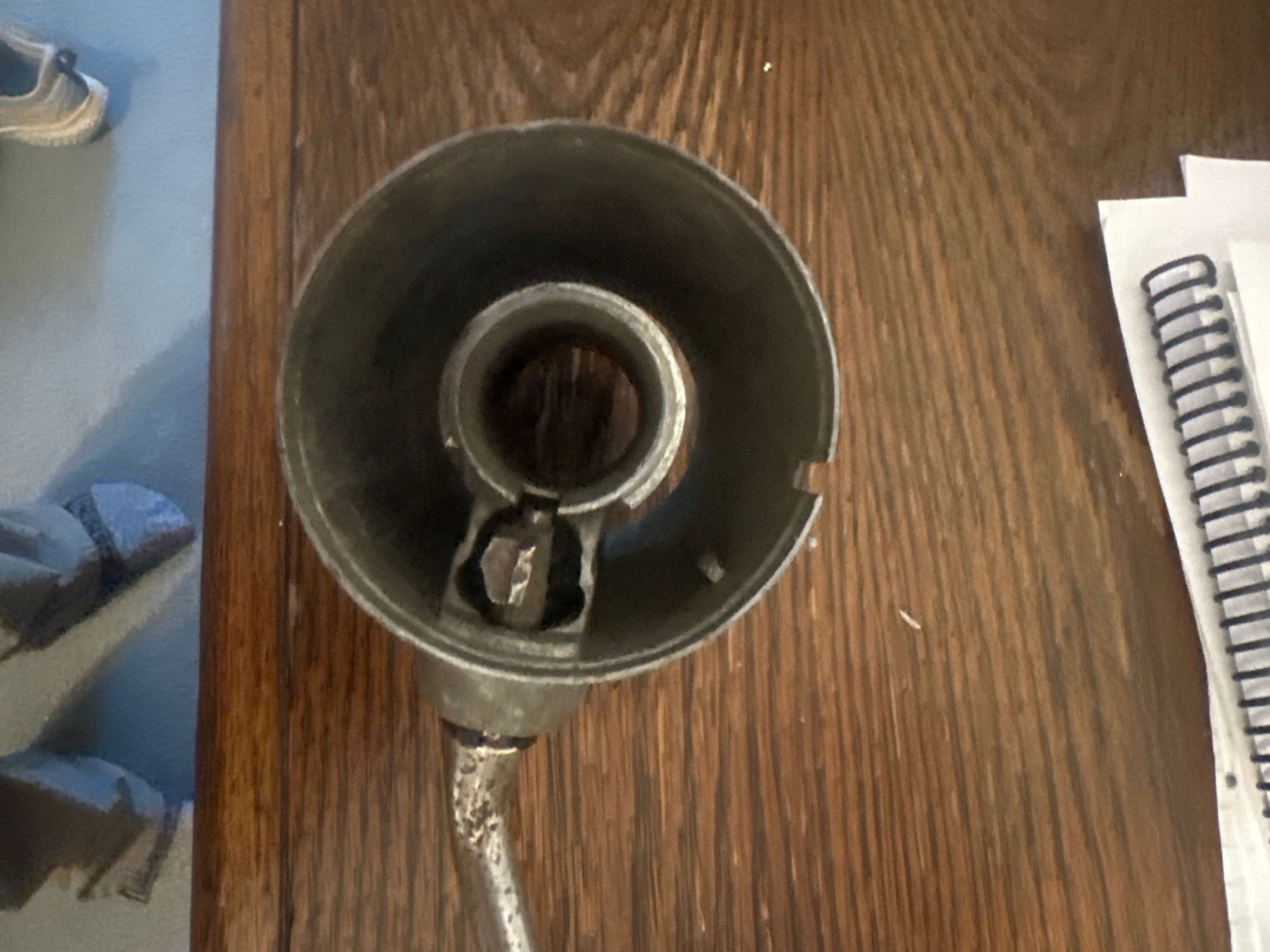

The only things I got is what’s pictured. And none look broken. Worn, yes, but not broken. I think you might be right though. I do remember hearing something falling down the pipe as I was pulling over. And on the bottom of the collar there is a piece that comes out when you depress the shifter. Any idea what that piece that broke off is called. Maybe that’s all I need.

There is a "detent plate" that is the long curved piece, the two screws .... and the collar has the lever, a roll pin, and a rubber trim piece.
If you have a long skinny magnet on extending wand, might "fish" for parts? I don't recall any other pieces. If I find a pic I'll post it. Without the curved plate, you will not any "positions", you can see the teeth on the lever that engage it.

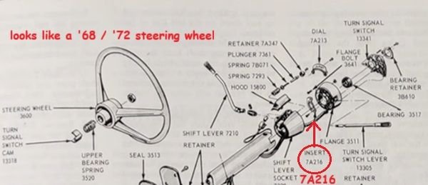

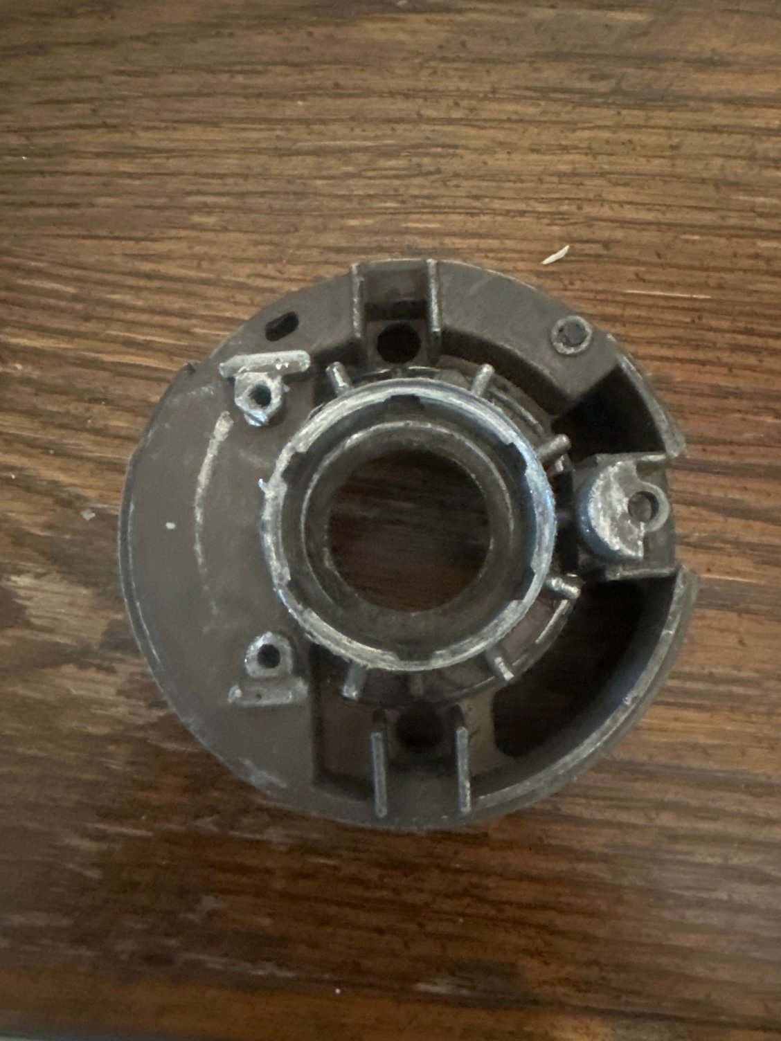

Is the part your talking about in this picture?
Looks like a 1968-1972 bump side steering wheel, the indicator light in a hood is a little different, but yes ....
On the back side of the flange piece above the shift collar across from the turn signal lever, #7A216 .... they called it an "insert". Located in the right place where yours just had two worn screw holes (see post #4 above). I saw I did mention mine being loose long ago, pretty sure that I Loctite-ed the two screws too.

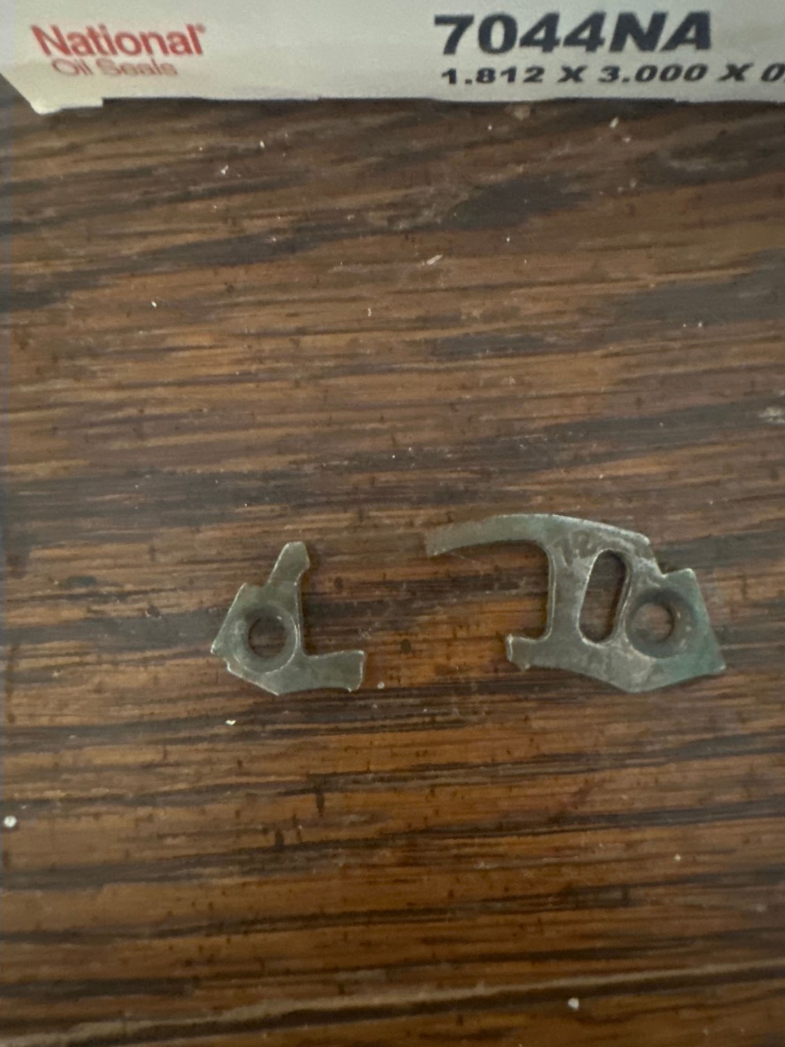

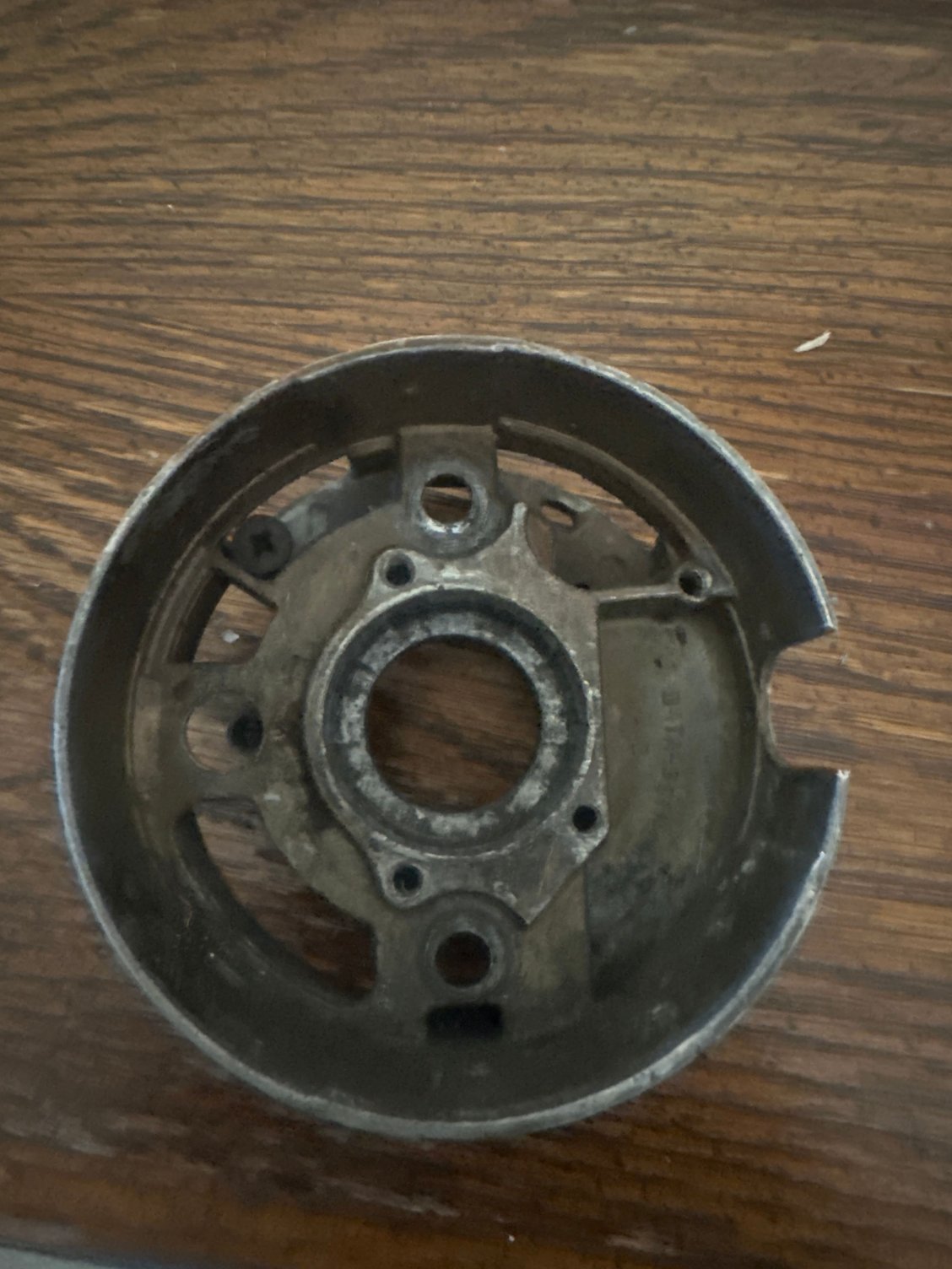

I put a magnet down the pipe and found this. Now just gotta find the piece online. Looks like you were right. Thanks for the help.

Glad it worked out. Was a long afternoon for me doing it as I recall.
