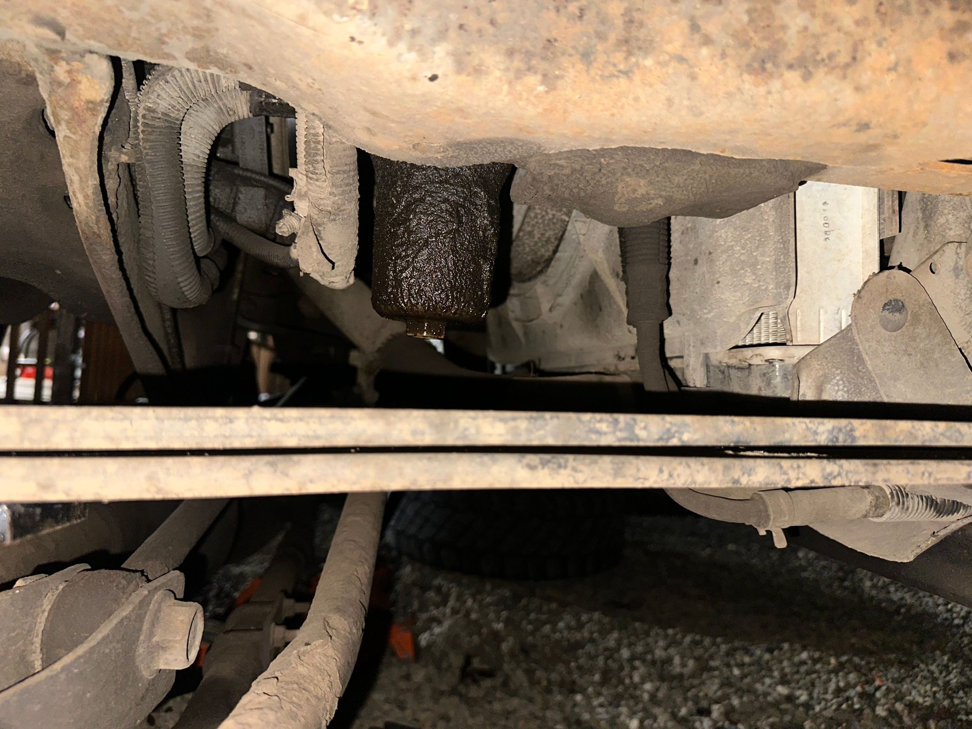

What is this?
Found this oil soaked canister thing while doing my brakes. 04 f350, this is on the passenger side, I was hoping to figure out what it was and if I should give it some immidiste attention. I’m new to diesels

see below. looked like engine oil at my first glance ....
What a mess.

Dirty secondary trans filter housing

As mentioned above.
You have an engine oil leak the should be addressed before it starts to damage rubber components (hoses, belts etc).
Degrease your entire engine, drive it a bit and find the leak.

It might be a trans fluid leak, but with a lot of dirt.
Note to OP: If you try to take off the cover with a hand wrench, you may bend the bracket, or worse, break off the hex at the bottom. The best way to remove them is with an impact wrench and a 6-point socket.

Probably so. Once I had a somewhat significant leak there after a filter change, and it does collect dirt quickly. That said, I could always see a bit of red in the fluid (hanging drop, etc). Mine never got that dirty though!
With that looking so bad, I am thinking we might also see an aftermarket oil filter in the engine compartment. Not necessarily related to the leak, but related to the lack of quality care and knowledge in general.

Thanks for the help guys, so its an oil filter for the transmission? Here is the video I took
