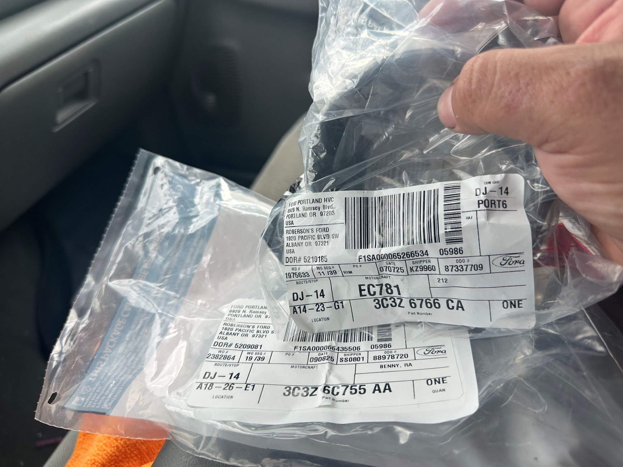

Ok, got the parts ordered. Should be arriving tomorrow. Will be nice to get the old boy back on the road. Thanks again @bismic , Ill post a vid when its done. Im also going to need to address that tranny filter soon. Tranny oil is full and bright red, doesnt smell burnt. Not really sure why the filter housing looks so nasty. Im going to clean it all up and see if I can spot a leak.

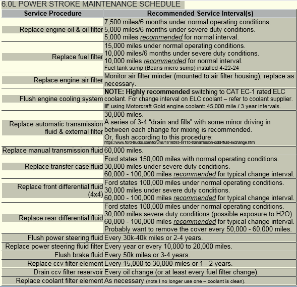

Routine Maintenance information attached.

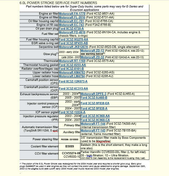

Service part numbers attached

Ready to rock
