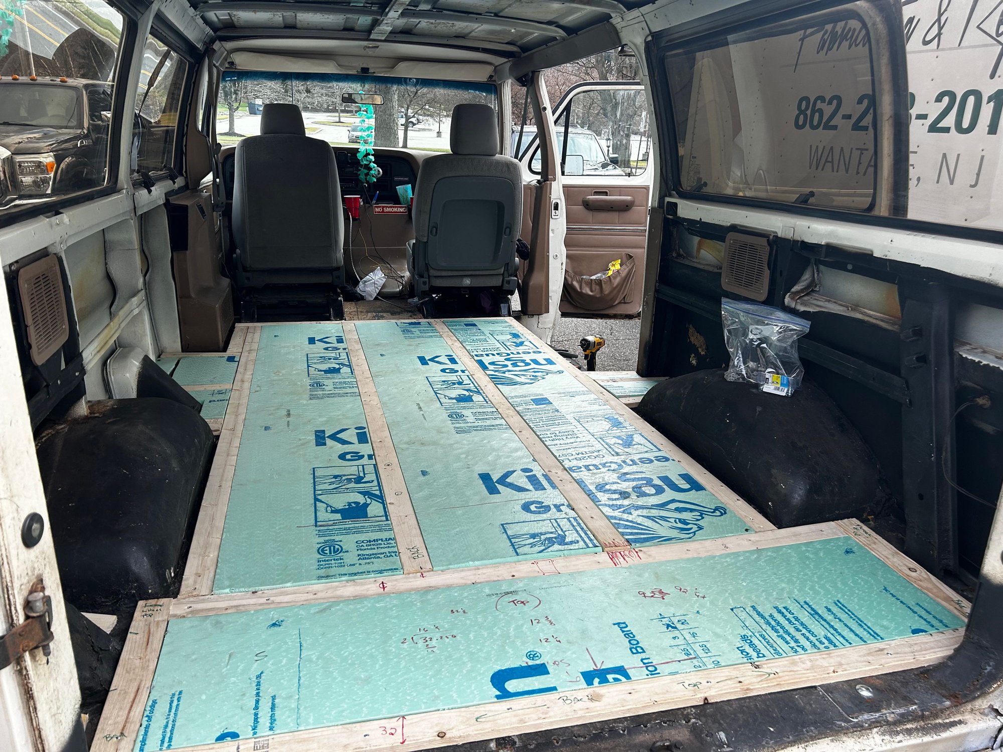

Next I got some 2" thick insulation to go on top of that, it's rated at 7.5 R value, for walls and ceiling. I also installed 1" on the floor.

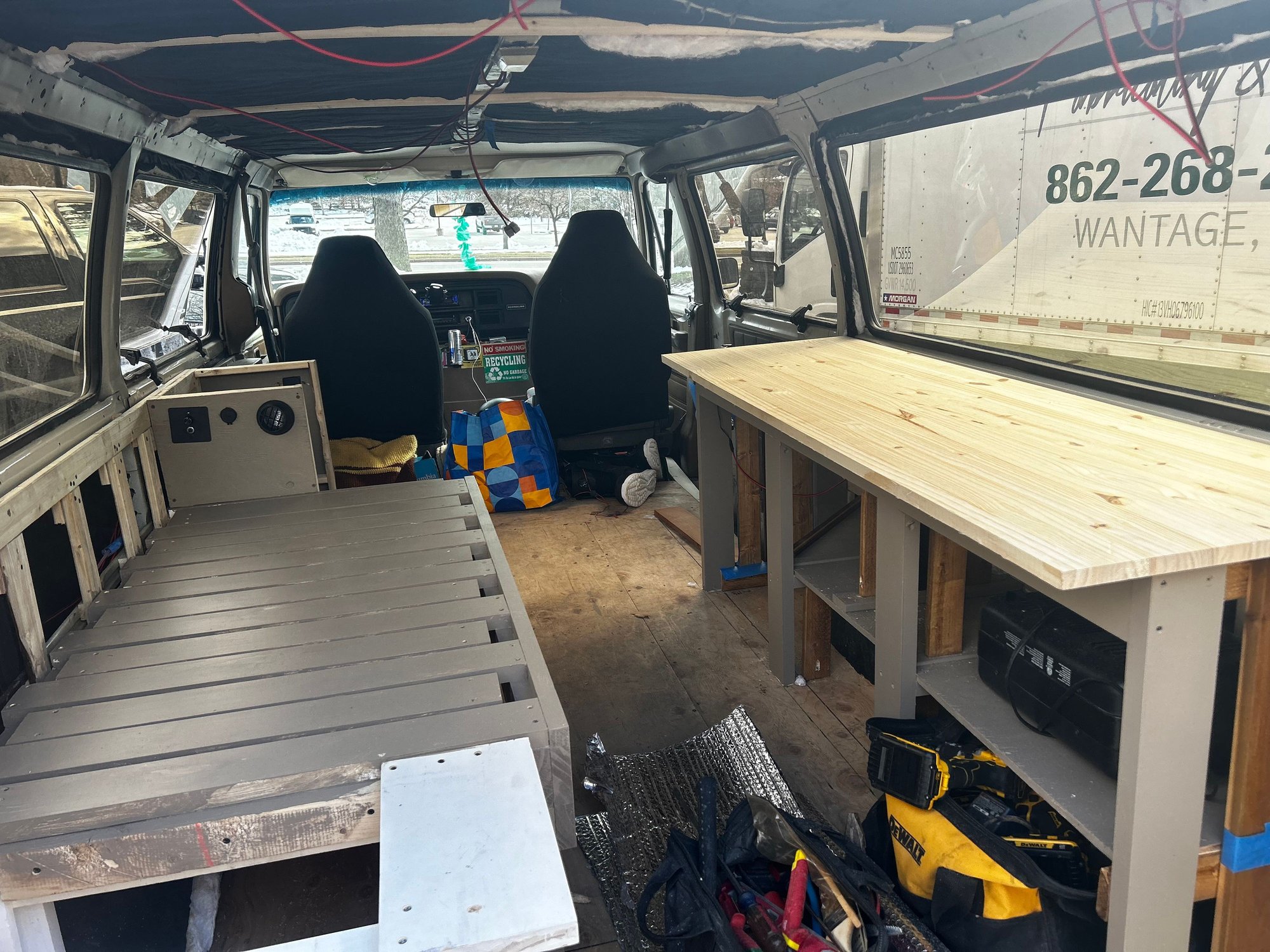

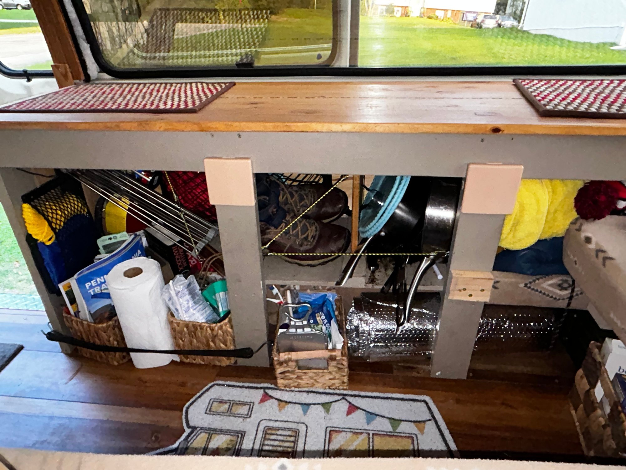

Here's some of my build pics, not much, I can dig up some more if you want some more ideas. On reddit, r/vandwellers and r/vanlife have a lot of great info and resources that you can pull off, and there's also a lot on YouTube. I did 3m thinpsulate in mine no vapor barrier. I recommend a diesel heater, not as bad of an install I thought it would be and I've used it plenty of times. And I recommend trying to build your electrical system instead of a power station, also not too complicated. Also my couch slides out into a bed.

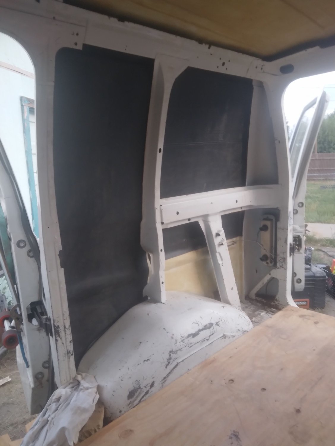

Van builds are so versatile, congrats on getting started. Pic is my rig, obviously the shuttle body gives me more space (I can stand inside) but it’s still a van.
