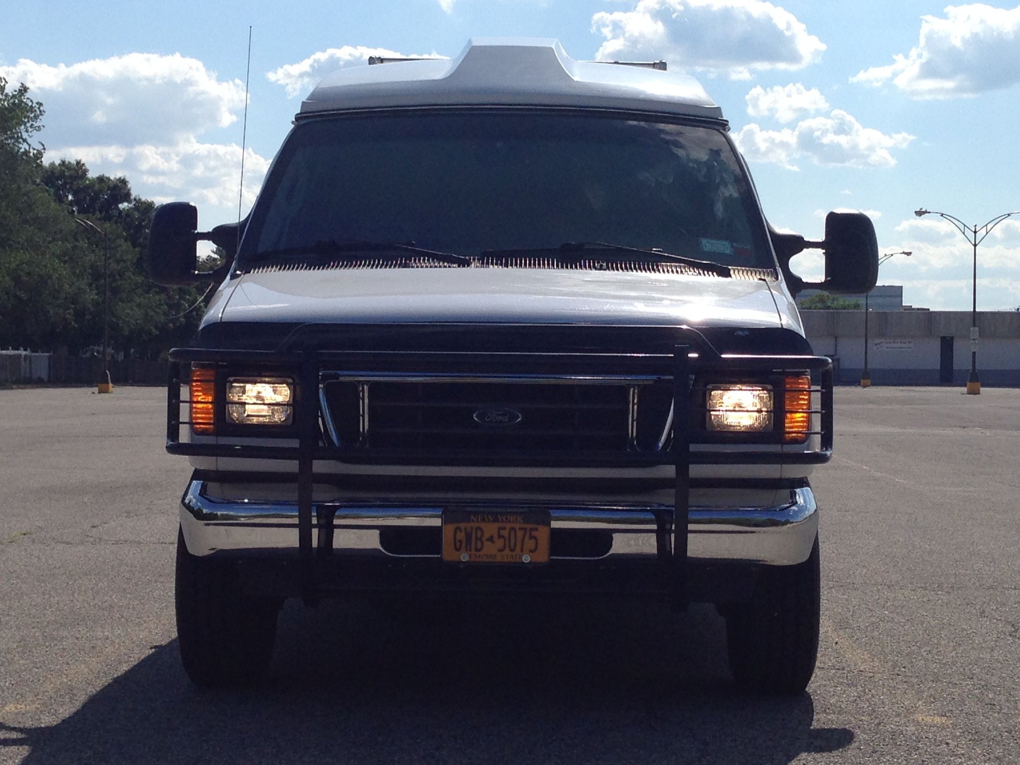

I just put one on last year. I found it used and drove 5 hours to pick it up. It actually took me about 7 months to find one. The only ones available were ambulance tops that you might find in a salvage yard (unless you can find a new one for about 2k). Post an add WTB on Craigslist. You never know.. that's how i got mine. I have an 04 and the donor vehicle was a 1992 quigly. The guy took it on as a project van however there was way too much body rust so he decided to part it out. He helped me take the top off which wasn't exactly easy but it was well worth it. Especially since he gave me the front brush guard for free. Keep in mind that you will not be able to use the old hardware (that long strip with the screws that attach to the roof). This hardware is VERY expensive if you can even find it. I decided to use rub rail for a boat and it worked out ok. Originally i wanted something a little higher but actually very happy with this top. Its very aerodynamic and modern sporty looking IMO. After a waxing, it looks like a brand new top. Not bad for a 1992 top. The only thing to worry about is not being able to take it through the car wash anymore lol..
DONOR VEHICLE
MY VAN BEFORE

I guess i read your post wrong.. Any downsides to buying a high-top van your asking? Im sure there are but they're are the most obvious things one would think of like height, water issues, possible body roll, structural integrity in a collision.. These hightop passenger vans are at more risk of rolling on its side when fully loaded and some caps have even come apart when crashed. An upgraded front sway bar and adding a rear sway if it doesn't have it would help greatly for body roll. Thats about all i can think of.. Maybe someone else can chime in
