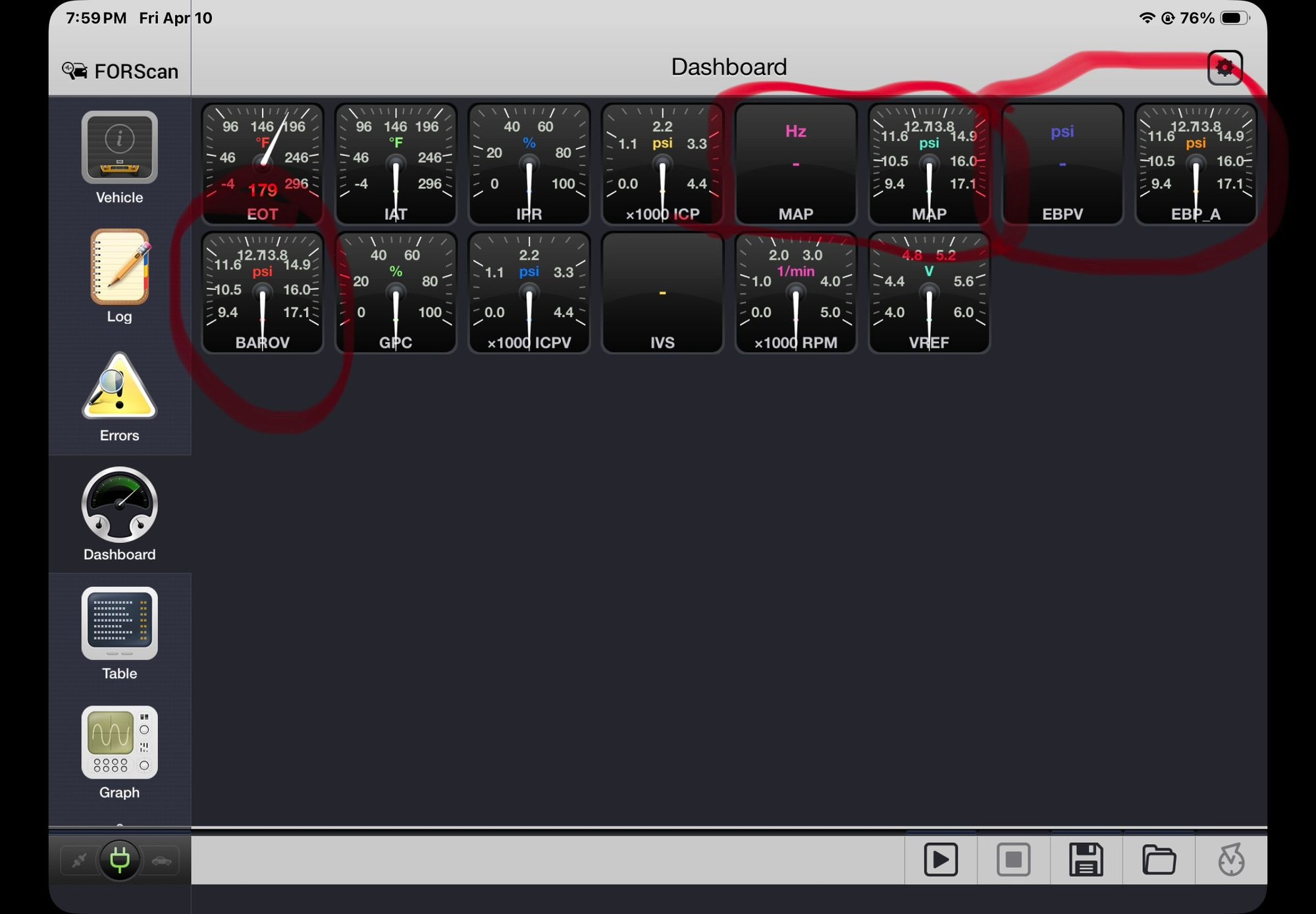

Originally Posted by Noah100
Brand new BARO reads the same as the old one. Guess I better look at the wiring. Strange that it reads 8.8 unplugged though
Because I was searching for an answer to the same issue on my 97, and came across this thread, my ForScan Baro reading was 8.9 at sea level, too, I wanted to post my findings.
There is a “BaroV” PID, and it reads the correct pressure. In fact, there are 2-3 options for PID’s to select from for Baro, MAP and EBP. And options for what units you’re displaying. There’s even a frequency option for the MAP, separate from a PID that will display PSI or KPa.
Hope this helps someone else in the future.
