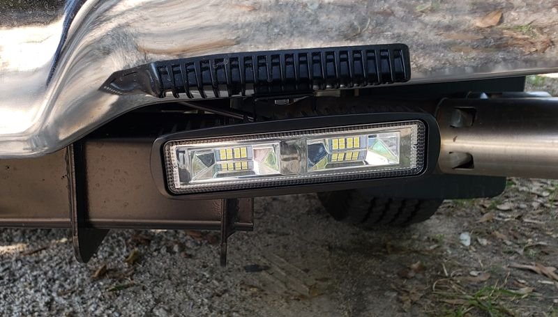

So I have wanted to do this for a bit but could not find the right look that would not look too crappy/aftermarket. Don’t like the cubes hanging under the bumper and did not want to cut into my bumper. Found these on Amazon for $23 bucks I think. 1500 lumens and supposed IP68. I opened them up and resealed them with sealant. Wired to upfitter 6 always hot in case I need some additional lighting.

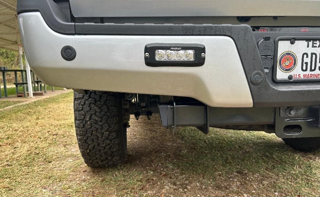

I did the Rigid flush mount in the bumper, and Rigid side floods mounted in the receiver hitch bar. I design and sell these mounts.

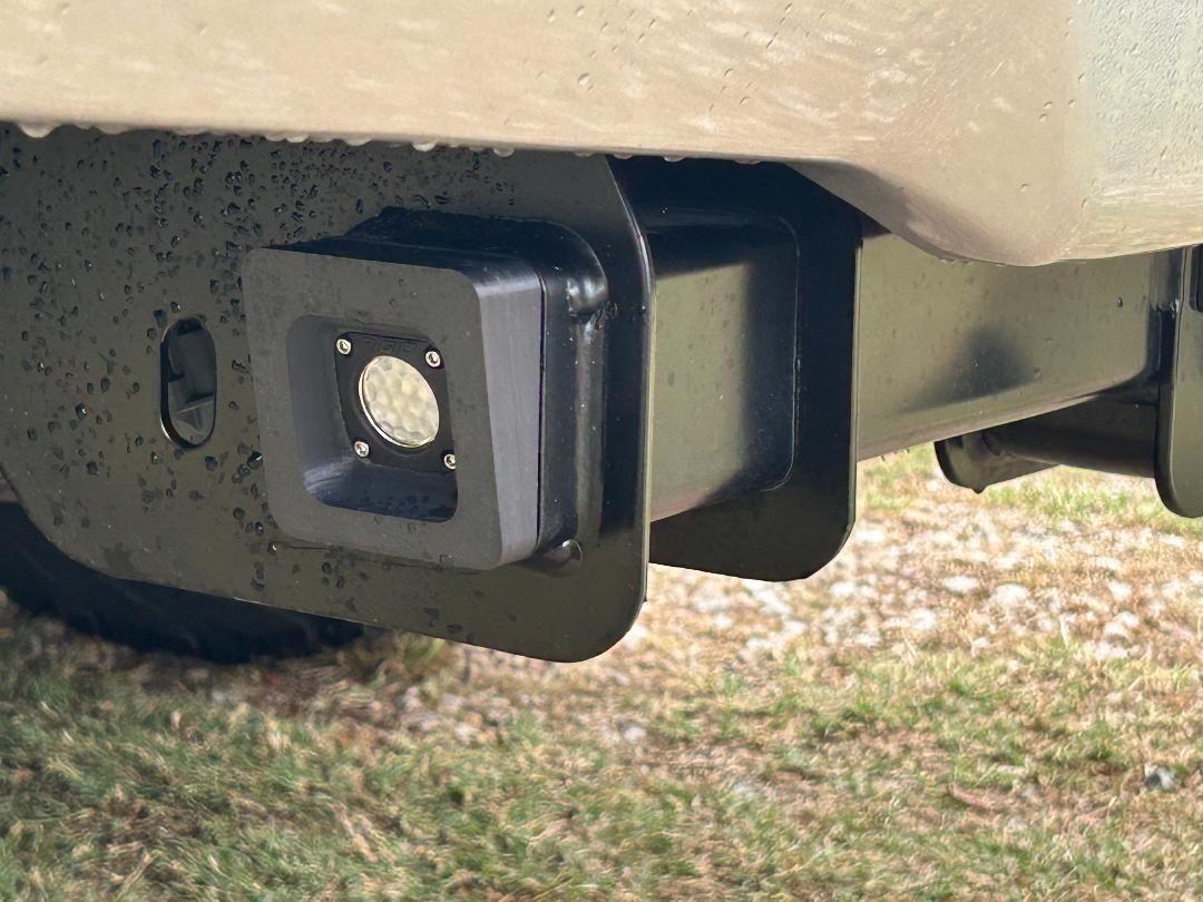

I know you said "cheap" which these BMC Lights are not but they are interesting as they fit inside the hitch tube...
The red circle was done by someone else pointing out these units can have lights in the ends as well - like above.
Here's a link: https://bmclights.com/shop-for-light...rrent-f-series

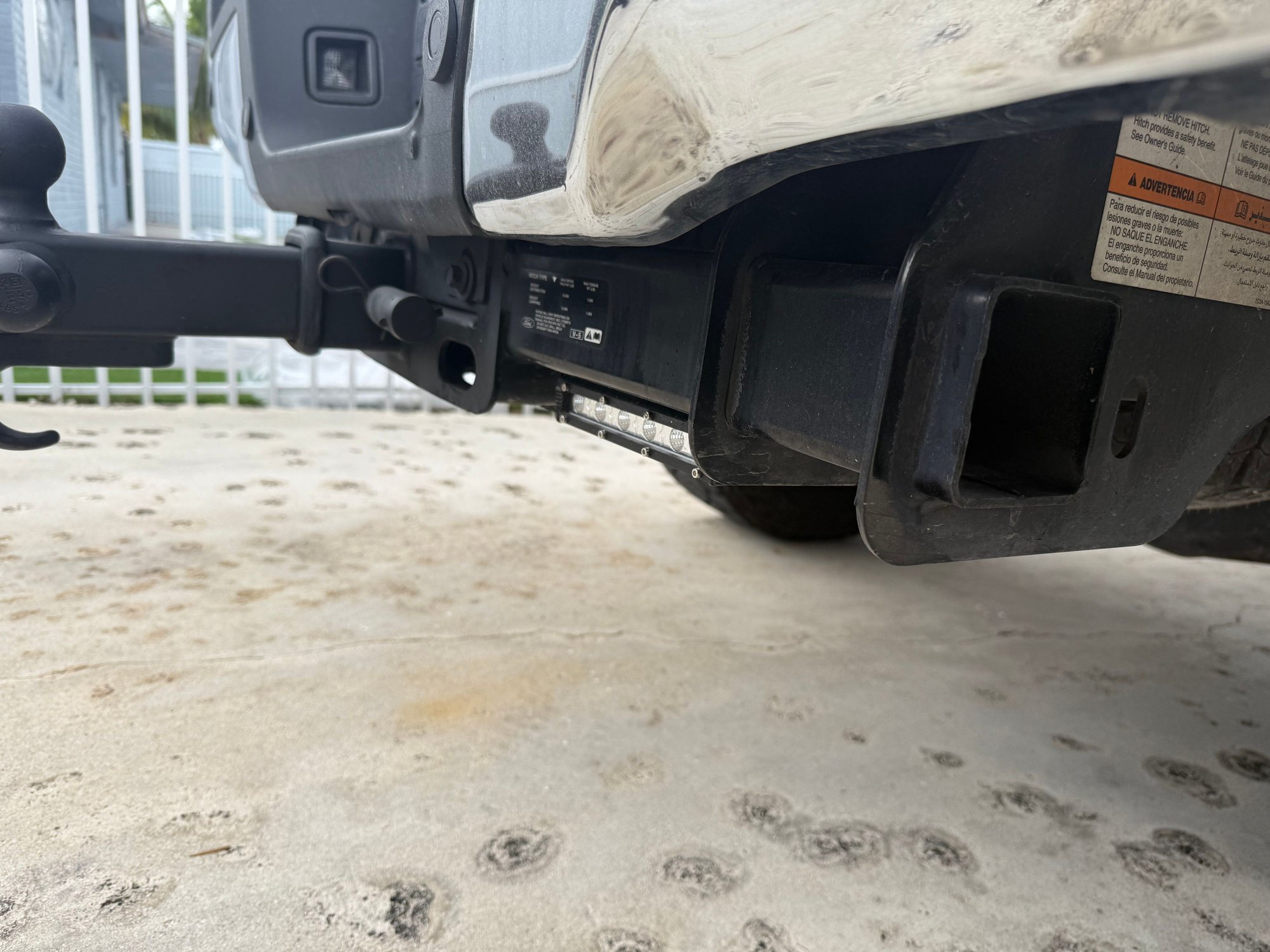

Somebody in another SD asked my at a fuel station about my lights and was curious how I mounted them. Figure I would post here as well. Found an aluminum U-Channel slightly larger than the hitch. Lights came with L-Brackets which I sleaved around the U-Channel, attaching the brackets to the U-Channel and not the hitch itself.. I cleaned the hitch as best as I could, first with water and soap then with alcohol. I used two strips of 3M double sided tape on the back side followed by adhesive caulk on the inside radius and top and bottom inside surface of the U-Channel. I did not want to drill into the hitch. Another option would be to spot weld the brackets to the hitch. I did not want to do this either. Lights do help at night and figure when I do get around to do some camping later this year they will help while setting up.

@Prezi68 : You don't happen to recall what the dimensions of that hitch tube are, do you (as far as width and height)? I'm wondering if it's 2-1/2" square, like the receiver hitch.

3" Square JoeUser.
