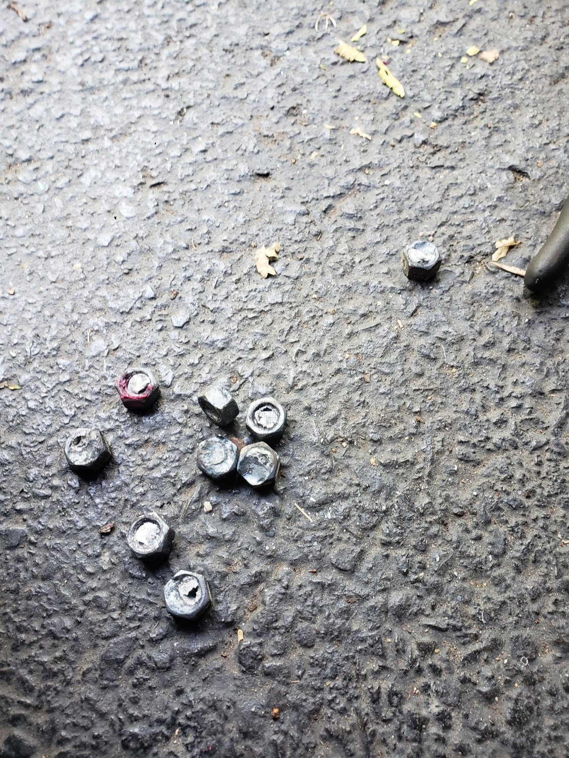

Thanks, i can't say i had a good attitude about it the whole way, but it's good to see the light at the end of the tunnel.
This is about half of what this single stud took. At least I'm getting some welding practice...
