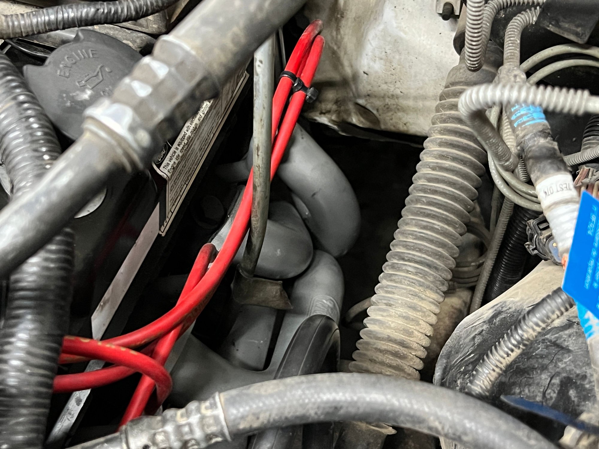

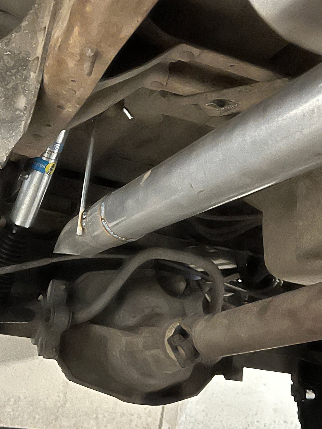

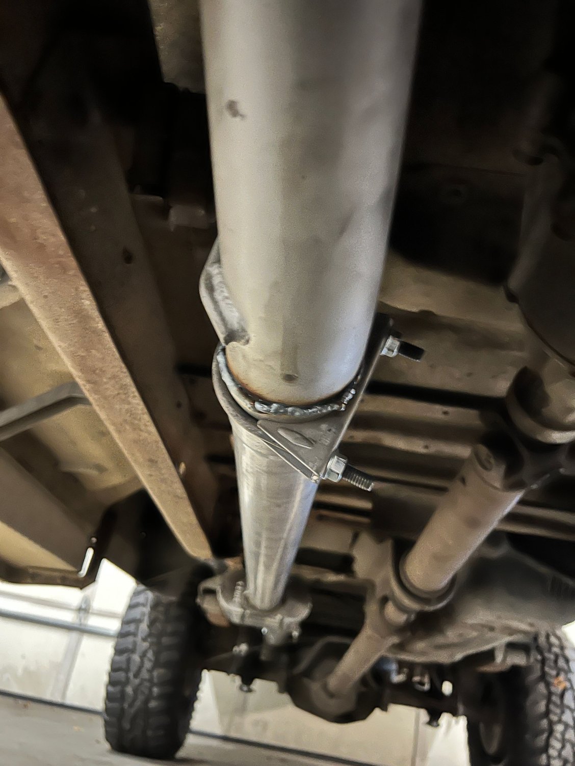

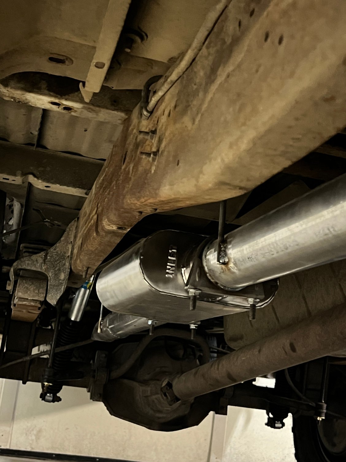

Got the headers and exhaust on awhile back. Hopefully starting it up this week.
3” all the way back.

Muffler brand? Header brand? How did they fit and is the truck 4x4 plus what trans?
Data helps for folks.

1993 Fe50 4x4 auto trans. Hedman header kit. 3" all of the way back.The muffler is just a Jegs house brand 3" inlet and outlet. The headers fit really well. The cat fell off.

3" IS the stock size for a 7.5L!
Stock 7.5L exhaust is 2-1/2" primary legs of the Y, merging to 3", 3" in/out catalyst, 3" intermediate pipe, 3" in/dual 2-1/4out, dual parallel tailpipes.
When the stock muffler rusted through on my previous '97 7.5L thanks to Cleveland winter road salt, I opted to go with a 3"in/out 7" round 20" long stainless straight-through Magnaflow and 3" stainless tail
I have the same on my '95 after its rebuild, with the exception of mid-length headers/y-pipe, merging to the 3" in/out replacement catalyst, 3" single from there back, 7" round straight through stainless Magnaflow, and a slightly different 3" single tailpipe

Oh, and @pdhulteng , glad to hear that the Hedman headers work/fit on your EFI 7.5L 4x4! This fact should help many other forum members!
The headers I got for my '95 7.5L 2wd several years ago were offered by DNA Motoring (and no longer listed), but look very similar to the Hedmans (but mine are polished 'stainless' )
