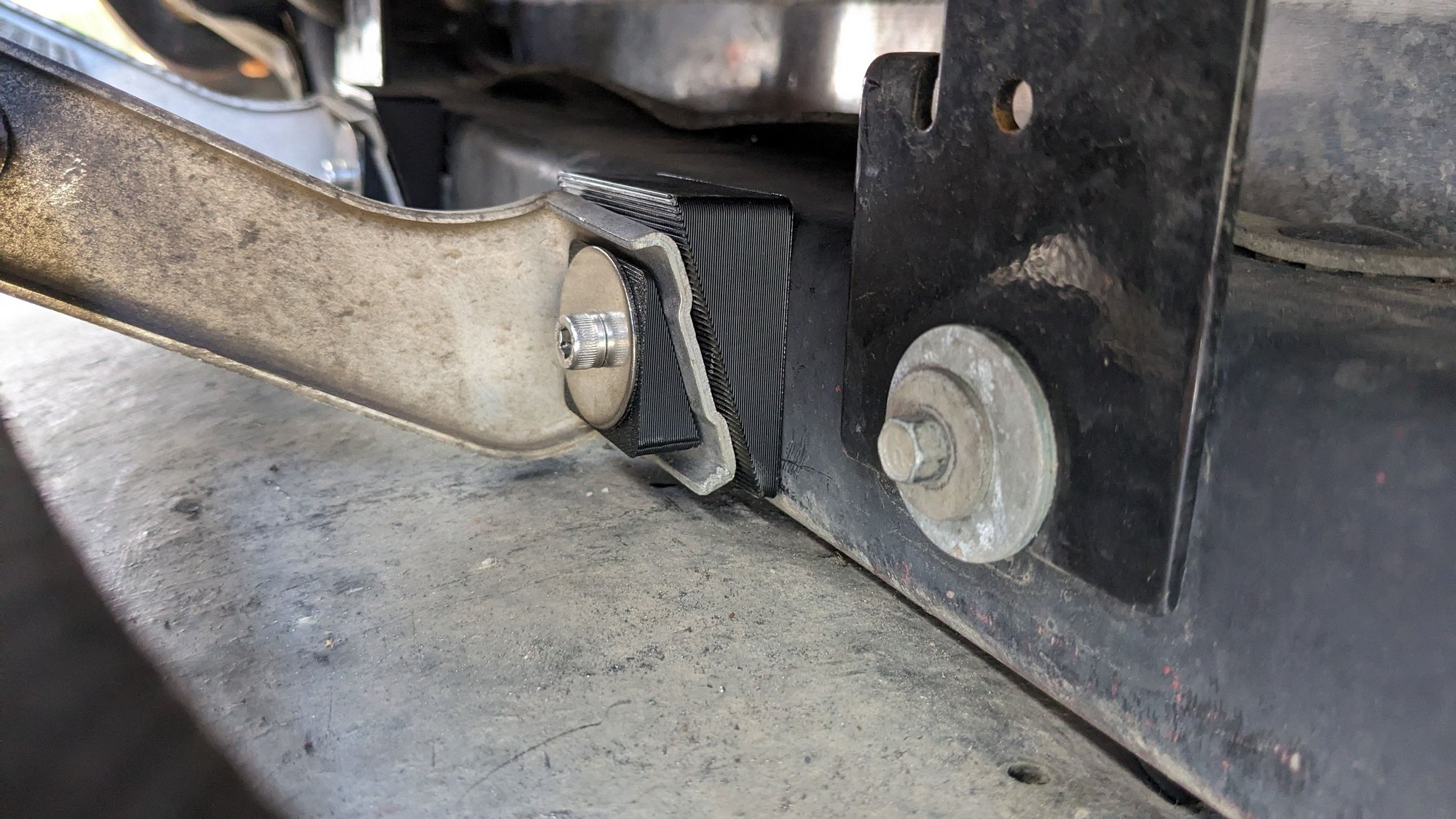

This is the winch plate. I don't like the huge bumpers that stick out, so I made this as low profile as I could. It mounts to the tow hook holes and the front of the bumper "plate."
Pretty tight clearances everywhere, and I needed to 3D print little wedges to angle the power steering cooler down.

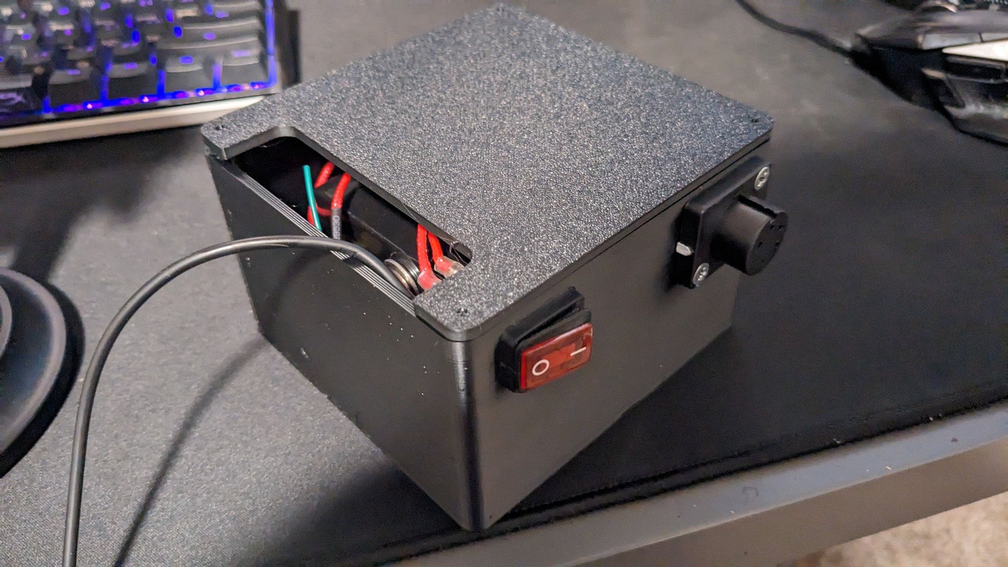

A couple older photos of my progress. I like to do cardboard mockups, measure them, then put them into CAD for my plasma cutter.
You can also see the power steering cooler wedge, as well as the box I made for the winch controller. That's the item you see wrapped in a plastic bag on the side of the frame rail in my other pics. Eventually the bumper will provide protection from the elements.

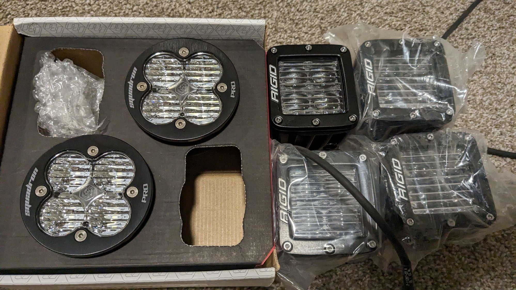

Slowly gathering lights. I haven't planned out the bumper yet, but there will be no shortage of room.

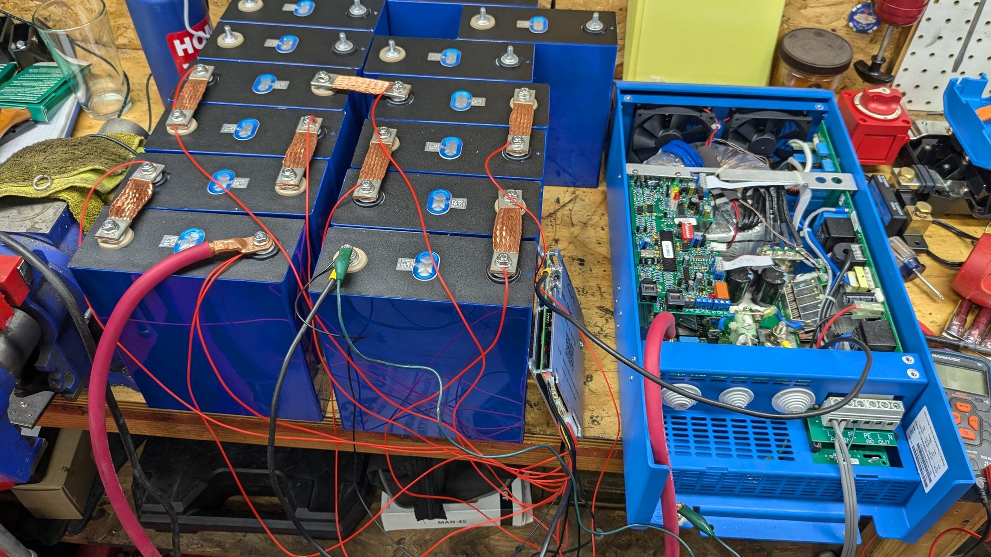

Not truck related, but I built two of these huge batteries for the camper. I decided on a 24V system, and these are each 300Ah at 24V. Together, that's the equivalent of a 1200Ah 12V battery bank. I wanted to be able to run my camper for an overcast week with AC.

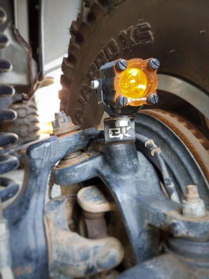

Rather than ditch lights, which I consider to be a good way to add drag to a vehicle that is already terrible in the aerodynamics department, what about knuckle lights? That way, they point in the direction in which you are turning.
