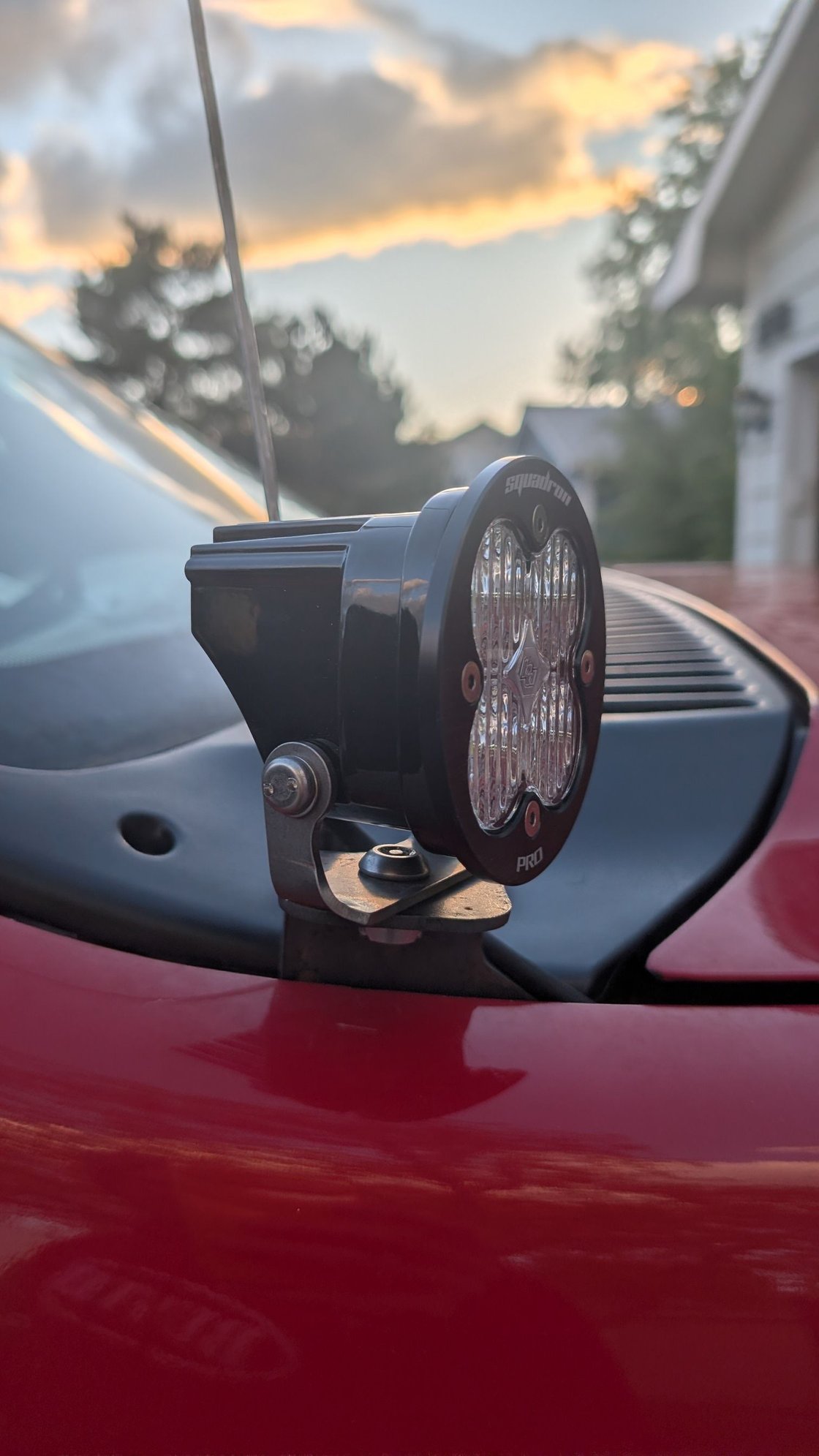

Designed and mounted my ditch light brackets. They lift the trailing edge of the hood ⅛" but it's quite hard to tell. I will probably tweak the design slightly.

Next I mounted my ditch lights, but I still need to wire them.
