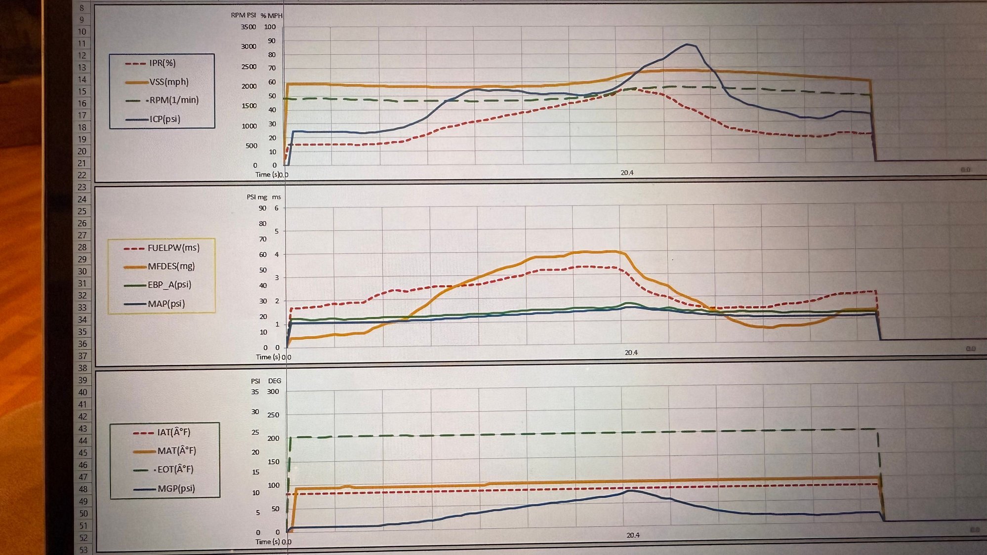

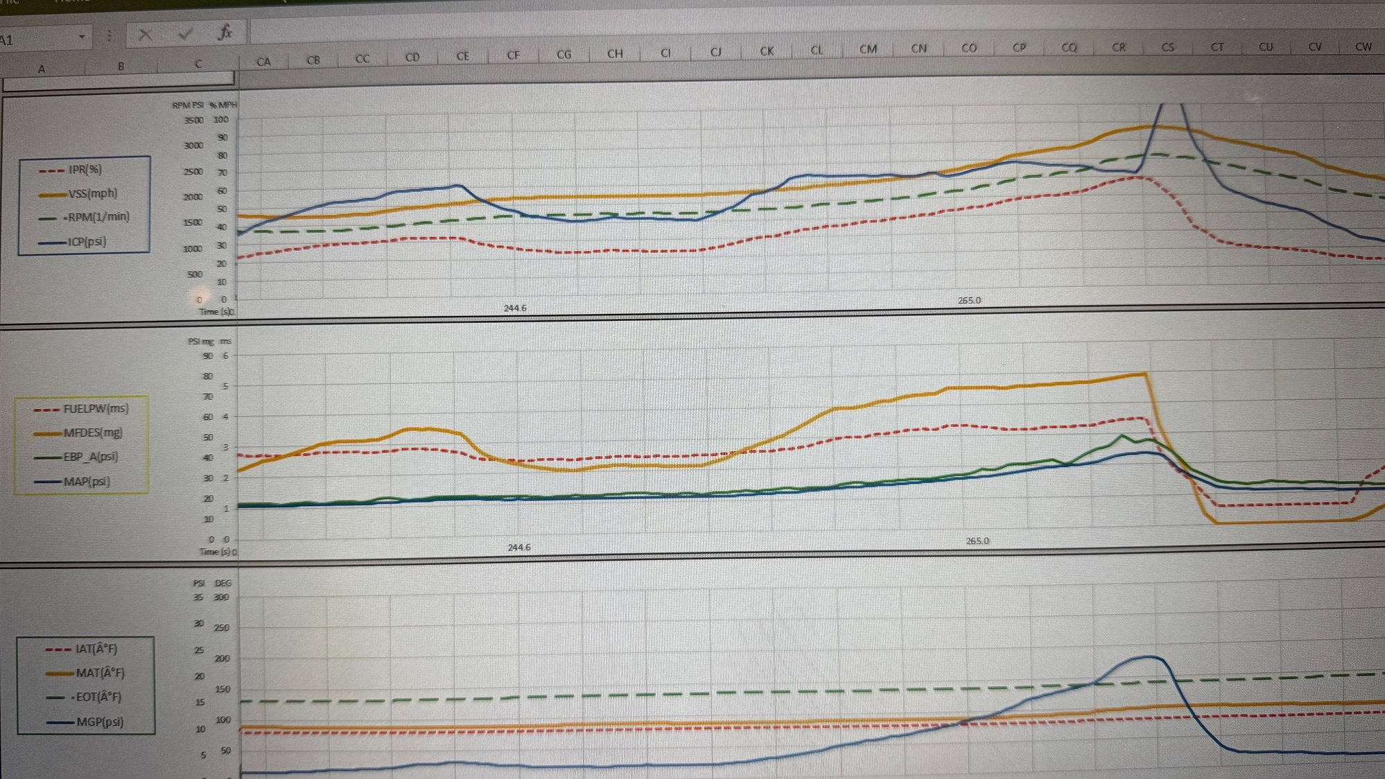

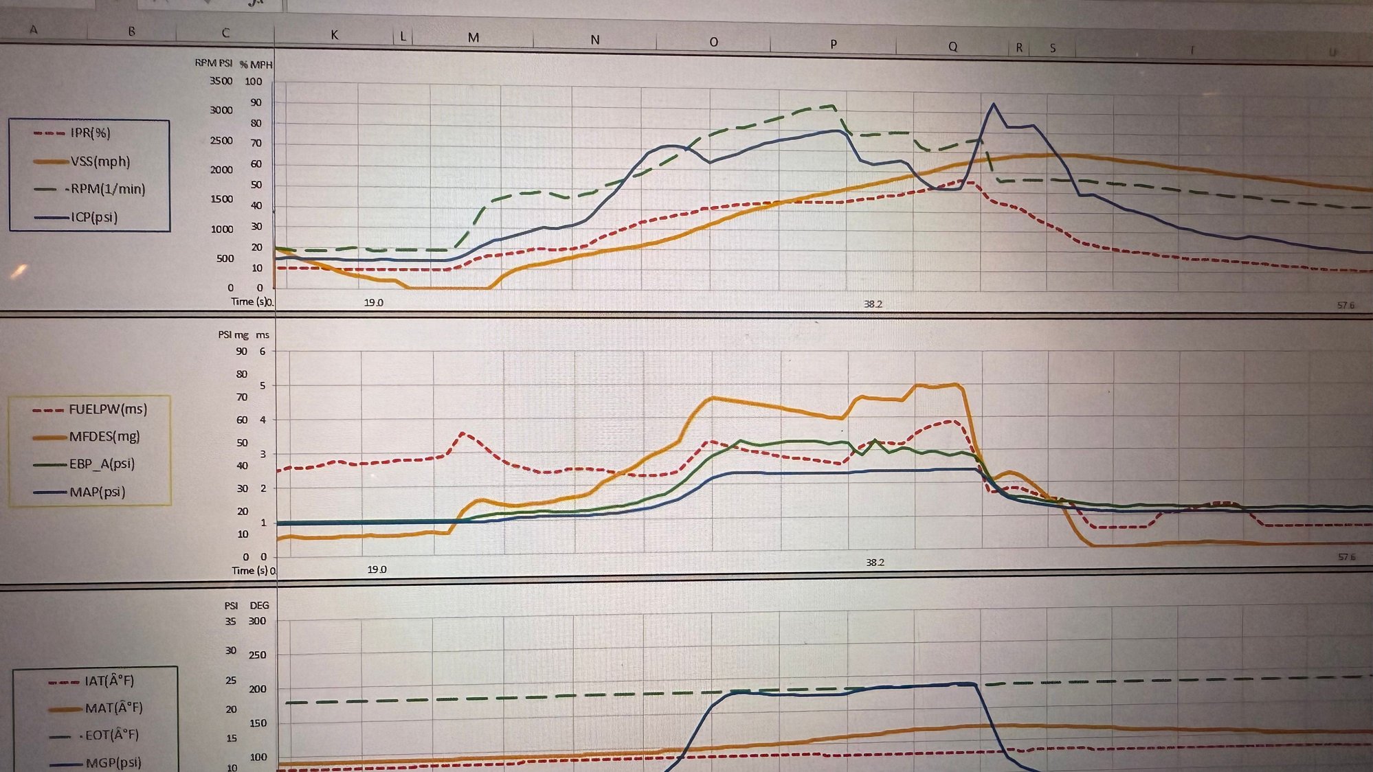

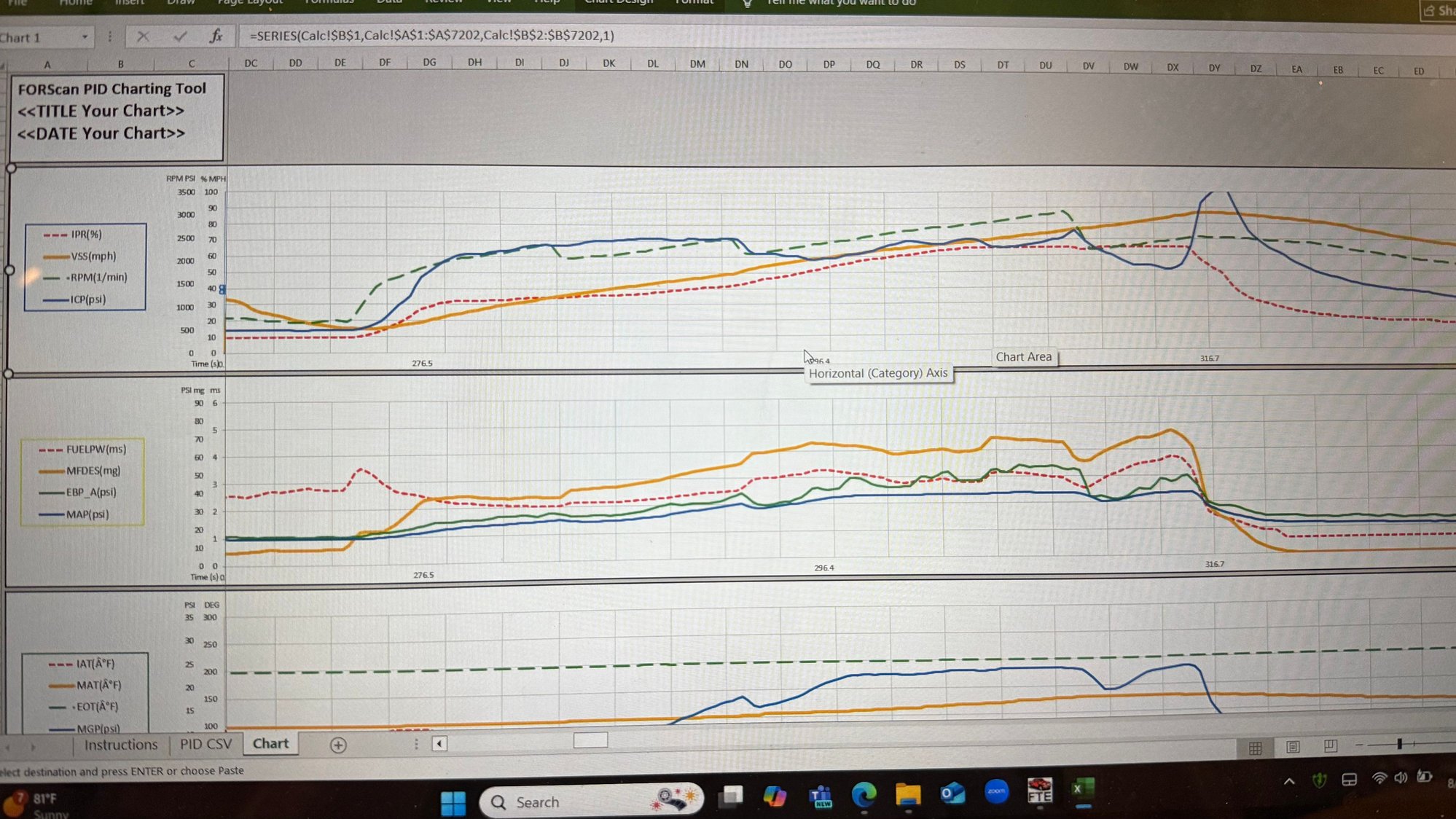

Stock tune Slowly rolling into throttle. In O/D No code
Stock tune WOT No Code but looks like I came out of throttle as ICP and IPR met
Stick Tune WOT #2 No Code
Stock Tune WOT #2 No Code
Stock Tune with Code
Stock tune w/Code
Stock tune w/Code
Here are some screenshots of stock tune runs.
fuel pressure between 54 and 45 psi.

All I see is fuel pressure isn't optimal. What are your boost psi #'s? What are your egt's on those pulls? Are you running a stock turbo? Have you changed your fuel bowl filter lately?

Boost is the Blue Line in the 3rd box down on each screenshot. EGT's are normal. Stock Turbo. Fuel Filter was changed last oil change, which was around 2k miles ago.
Seems like the main times it triggers the Code is when i roll into throttle in OD. The Code comes on everytime the ICP is dropping and the IPR % is high. On the screenshots when you see the IPR % (Red dotted line 1st box) starts climbing and the ICP (Blue line 1st box} is dropping. When those lines meet shortly there after is when the light/code comes in. I have a Sump, Fiter Assembly, and new Bosch Fuel Pump en route. See how that goes. Then to check HPOP and IPR.

I should have noticed this on your first set of graphs but I see that your IPR duty cycle is 10-ish% at idle. A leak bad enough to cause maximum duty cycle on a stock tune (64%) would certainly cause an issue with the duty cycle at idle.
My suspicions have changed. I think I'd be looking into pressure testing each bank of cylinders individually to try to find an injector possibly "blowing off" at 1800+ PSI; if that's inconclusive, it's time to look at the pump. I hate to say it, but it wouldn't be the first time I'd seen that after much floundering thinking it couldn't be the pump. One guy had a 1996 and the other with a 2002 (a guy who stole a good used HPOP from me that I lent to him for diagnosis and then he quit answering my phone calls). Thanks Jeremy Haller.

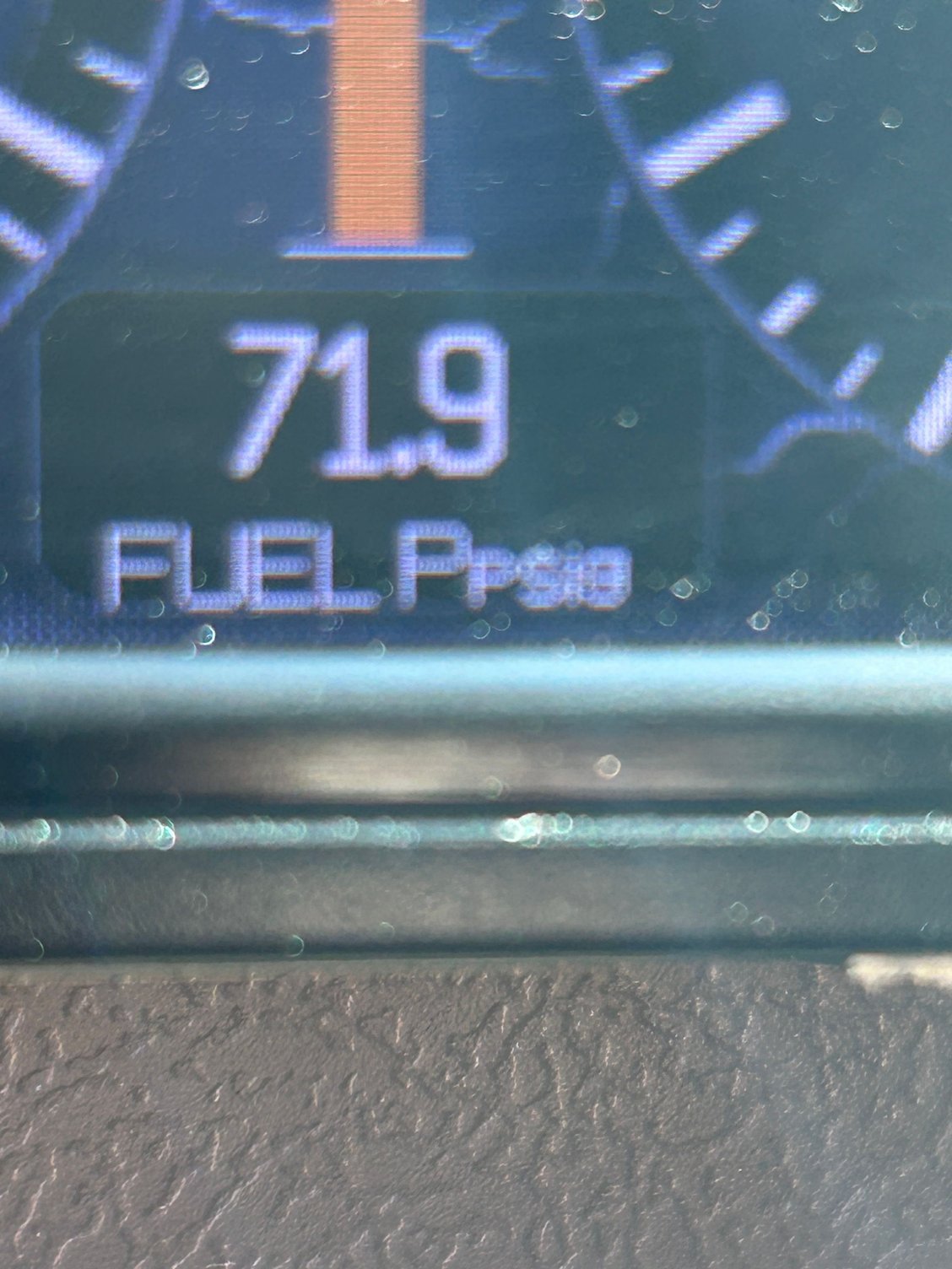

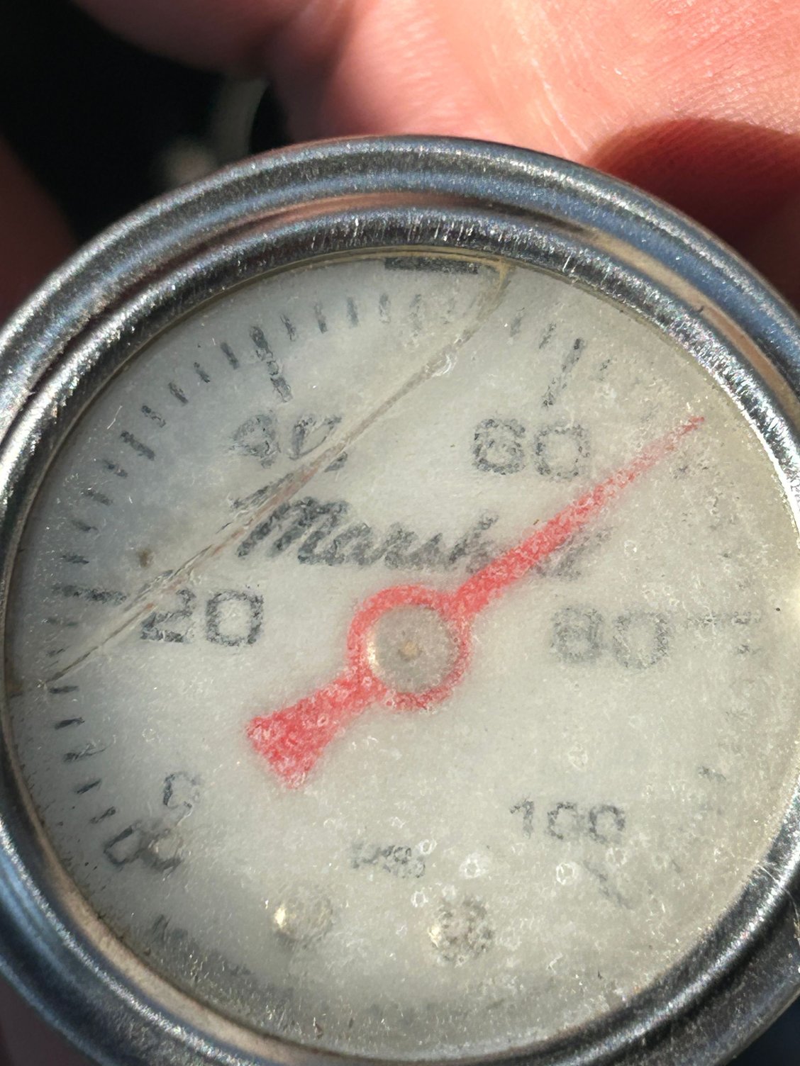

I finally got my Excursion back from the shop. Here's my fuel pressure at idle. The edge tuner reading is before the filter the liquid gauge is after the filter. This is at idle.

Forgive my lack of knowledge here. If the Injector(s) is having blow-by above 1800 psi. Where does the oil go? I have zero smoke issues. Also what should idle % be on IPR?

Ipr at idle should generally be 9-11%
