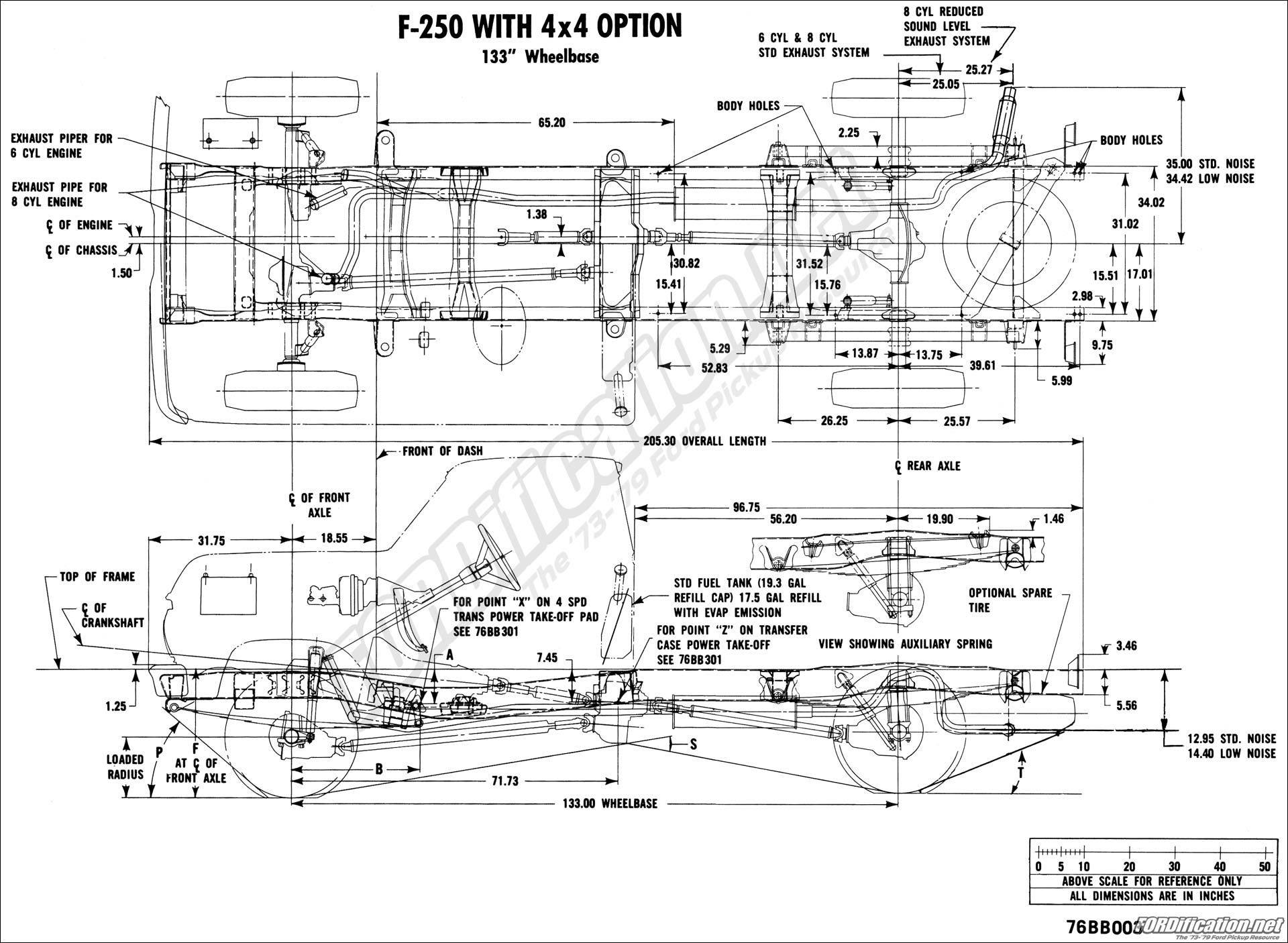

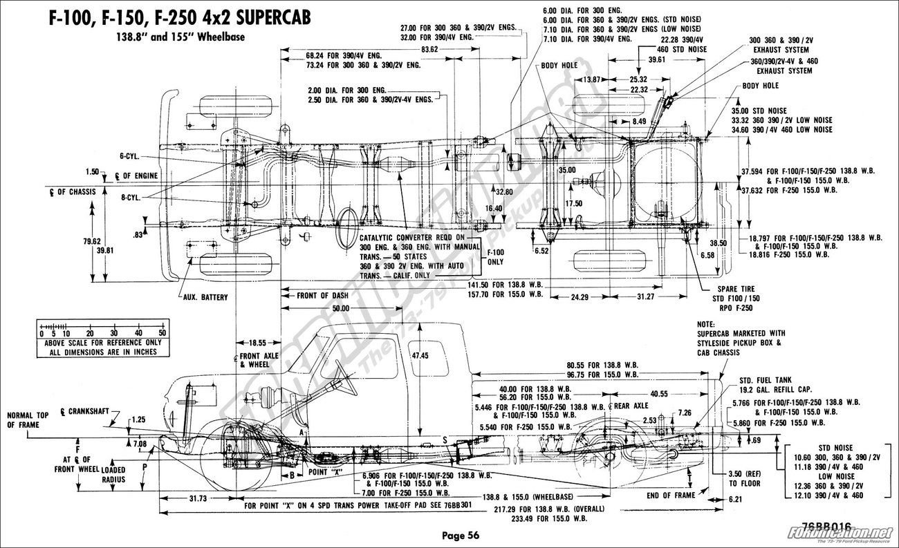

the frame is longer ,

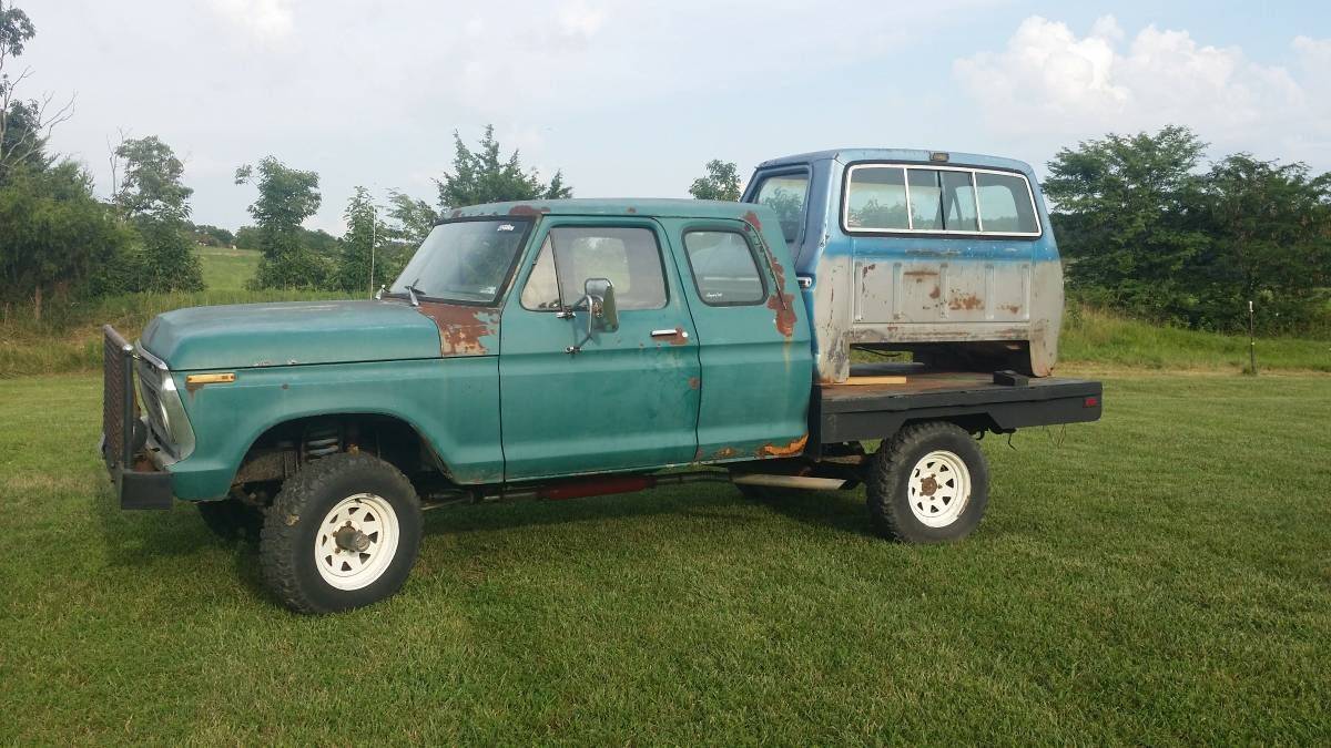

If should mount up easy enough, it has been done before by others. The only real diffferent is the back of the cab cross member position. You might have to fab up another back of the cab cross member. And yes you will have a very SHORT bed. So a flat bed is the easiest.
I believe this WAS a regular cab and a SC got put on it. Also called a SC side saddle crew cab.
