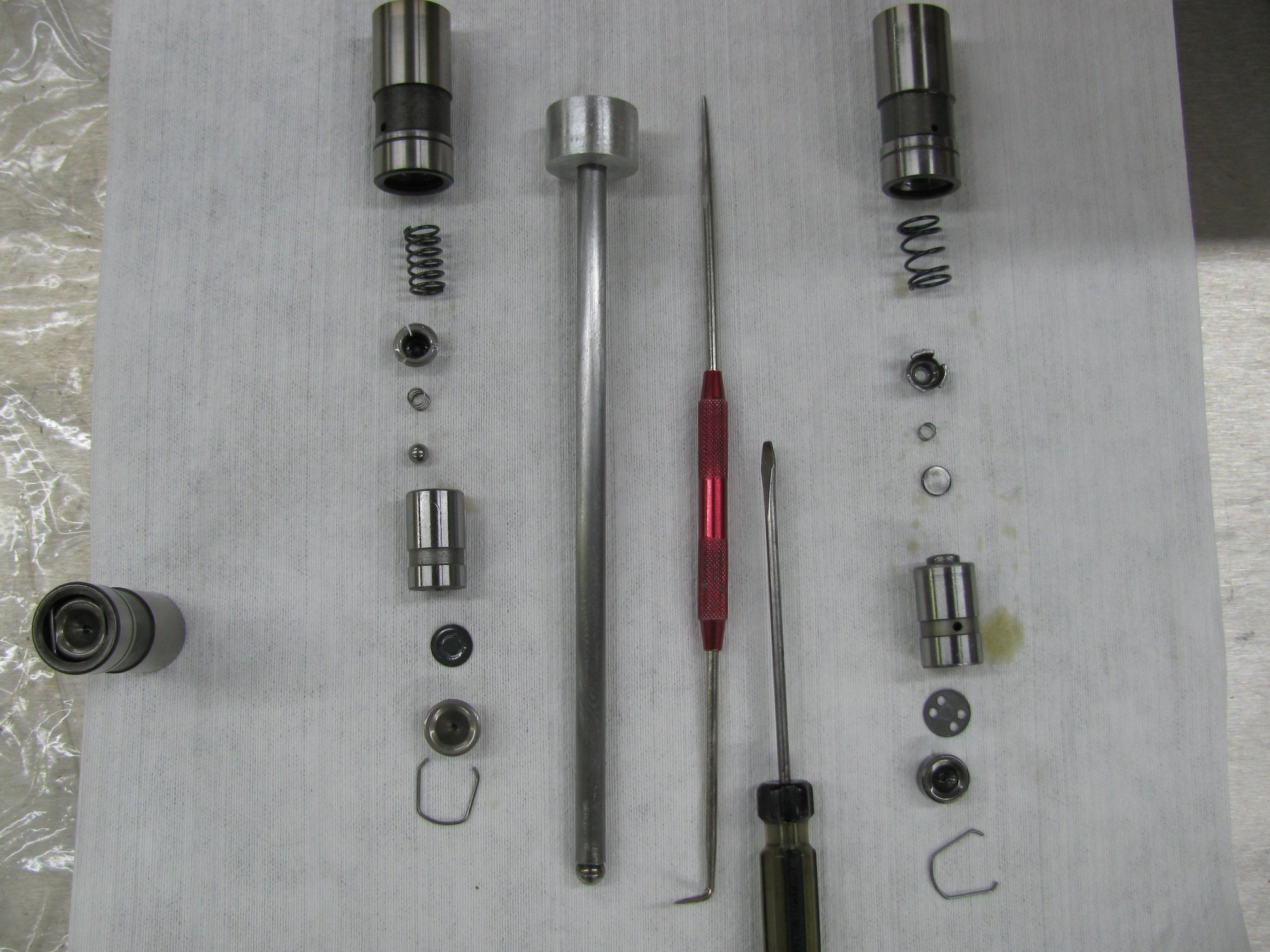

If you find you have good oil pressure and need to take a lifter apart this is what is in there. The one on the left is a type 1 the one on the right is a type two. The easiest way is to use a drill press with an old pushrod or piece of round rod. Press down on the cup until the plunger moves down enough to remove the snap ring. the pushrod cup and metering plate will fall out. If the plunger will not come out apply some compressed air into the center of the plunger, a little is plenty you don't want to shoot it across the room. You do not need to remove the check valve on the bottom of the plunger. Clean them with an old toothbrush and some solvent. Dip them in some oil and reassemble unless there is something wrong with them. DO not mix parts they are matched.
