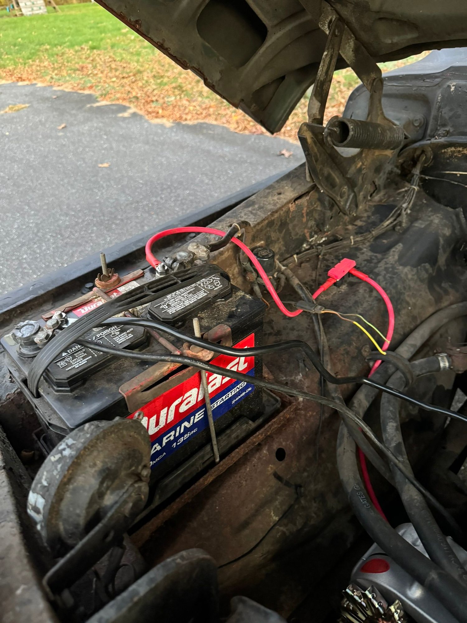

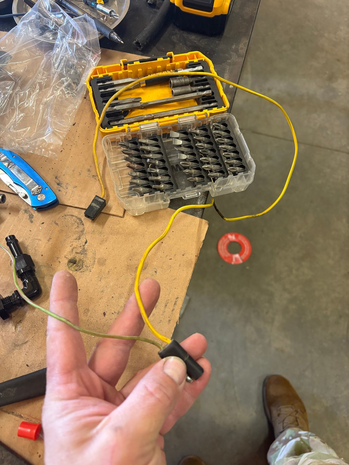

In all honesty I’m about as sharp as a spoon so forgive me if this seems dumb but I just want to make sure I’m doing this right.
I was going to remove this piece from my old harness so I had a plug that could attach to the harness on my fender and still have my horn.
[img alt="The green red wire would attach to the green red wire through this plug.
I would need to attach a 500-560 ohm resister on this wire correct?"]https://cimg4.ibsrv.net/gimg/www.ford-trucks.com-vbulletin/2000x1504/img_9094_ae0bcf7f6e79ed971b0a3101b6f5c5540880d770. jpeg[/img]
The green red wire would attach to the green red wire through this plug. I would need to attach a 500-560 ohm resister on this wire correct?
The other wires I am good with since they both go to the hot side of the solenoid on the fender.
Will my dummy light still work on my dash or no?
sorry I know there is a myriad of articles and posts on this but just kind of confusing me.
