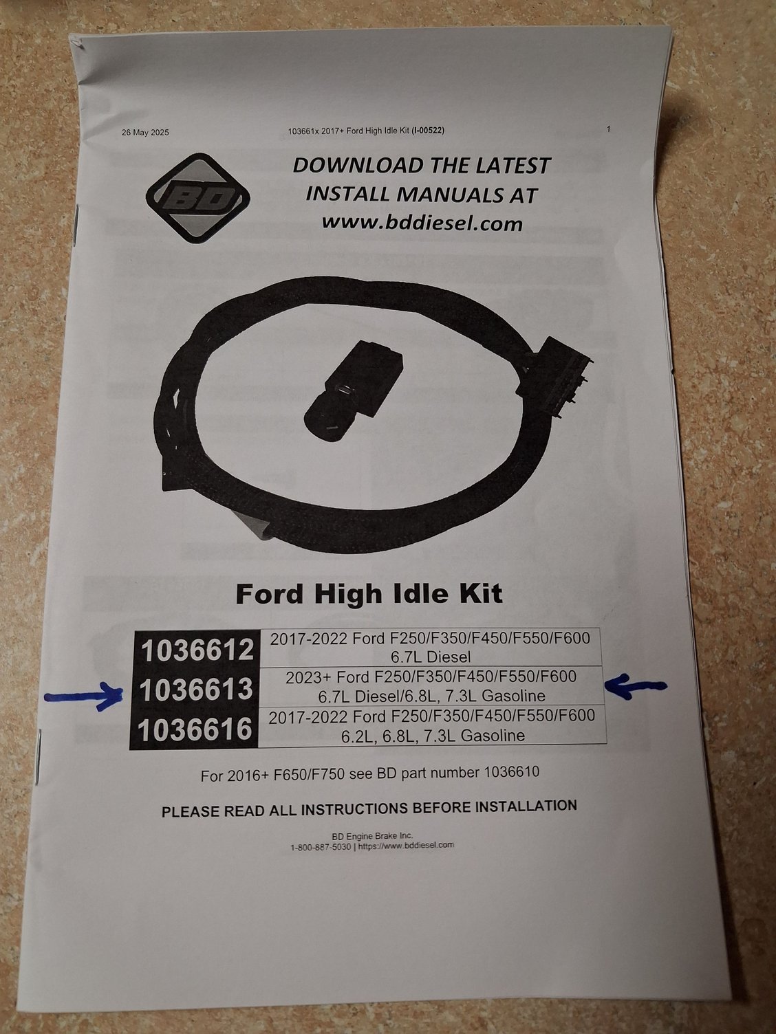

So I bought a BD diesel idle control kit for my F550 Godzilla. Easy Plug and Play install. It works great. You can set the idle for between 800 RPM and like 2400 RPM. I set it at about 1,000 RPM. I'm a hot shot driver so I put it to use. One of the additional side benefits of this kit is that it defeats the timed automatic engine shut down feature that Ford has programmed into the vehicle. So basically you can idle the truck all night long if you want to.

I'm curious... BD doesn't market it for the gassers. Did you axe them if it would work with the 7.3, or did you just throw it on there?

I called them (BD) on the phone and spoke to one of their reps and he told me that this part number would work for my truck. (1036613)
2023 7.3 Gas Godzilla. Actually found it cheaper online from somebody else and saved about $10.
if you go to the BD website I don't think it shows that it works for a gas engine so they need to fix that. If you order one from someone make sure you order the right part number for your application or it won't work. Depending on the year you may have to modify their harness by moving pins around per their instructions sheet.
mine was completely Plug and Play fairly simple.
the hardest part is locating the harness behind the fuse box on the passenger side and getting your hands in there to connect the harness.
here is a pic of the instruction sheet that came with the kit. Cheers...
