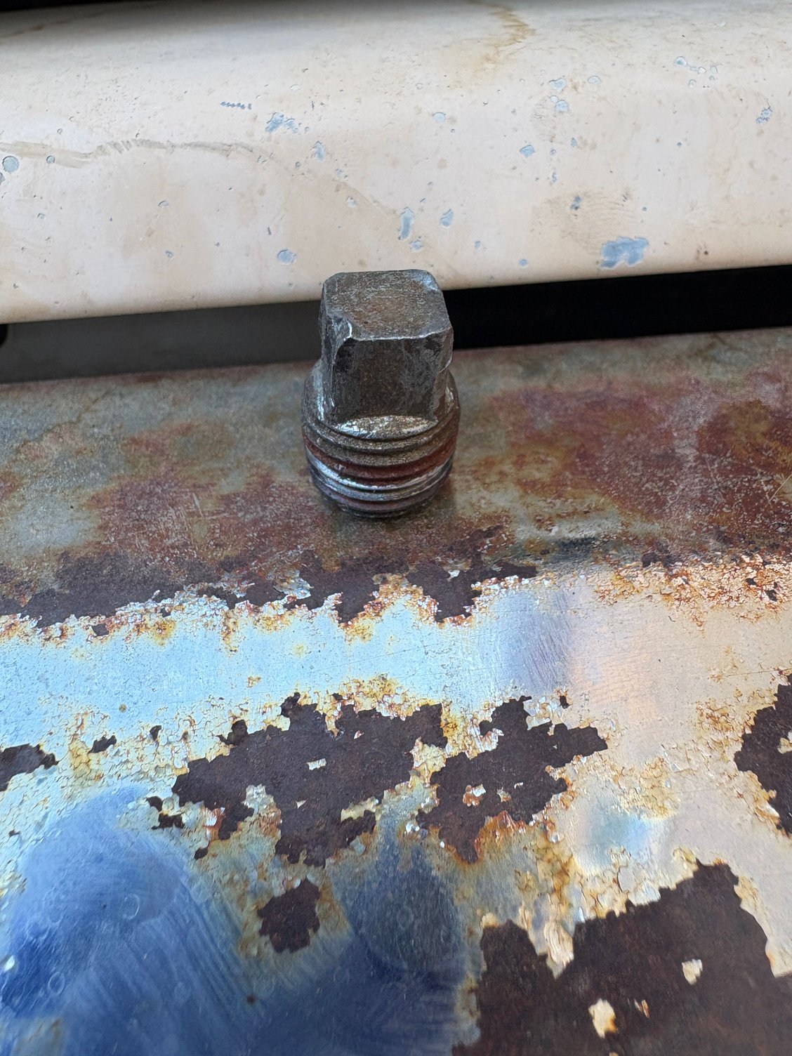

So, was that a freeze plug? Did it look anything like this, from the outside?
no mate, looks like this
Ok, so this was in
This? Got it, the second image was hard to guage size. Can you post a picture from further back, to be sure what we are looking at?
I am thinking what you are picking at is carbon build up in the evap system, It should not be connected to the coolant system.

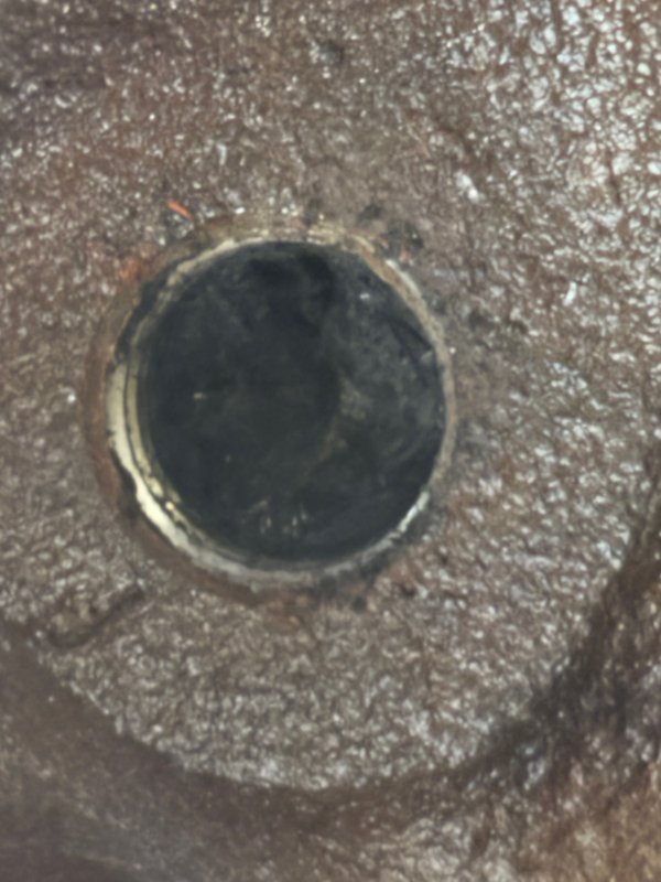

Sorry, you did mention that these were down on the underside, They look like some plugs that may be on the heads as well.
So, Not sure what these might be, But I would be careful drilling them out, as you may end up getting big nasty clumps of stuff in the oil system.

Here’s the location in the Haynes manual
same place as where I pulled this plug from and there’s on on the other side - next to the starter

I didnt drill - can’t get the angle to do so

Ok, so I would have done one bottle, ran it as much as you can without it overheating, not less than a couple of hours total, preferably driving it a good part of that time. Than drain, flush it out with hose water, forcing water in to the engine from the upper hose until it runs clear and do the process again at least one more time, probably 2 if it was as bad as you said.
Report back. Maybe pick at that gummed up crap a bit, on both sides, so you can completly drain the block and the crap that may be sitting in there as well
