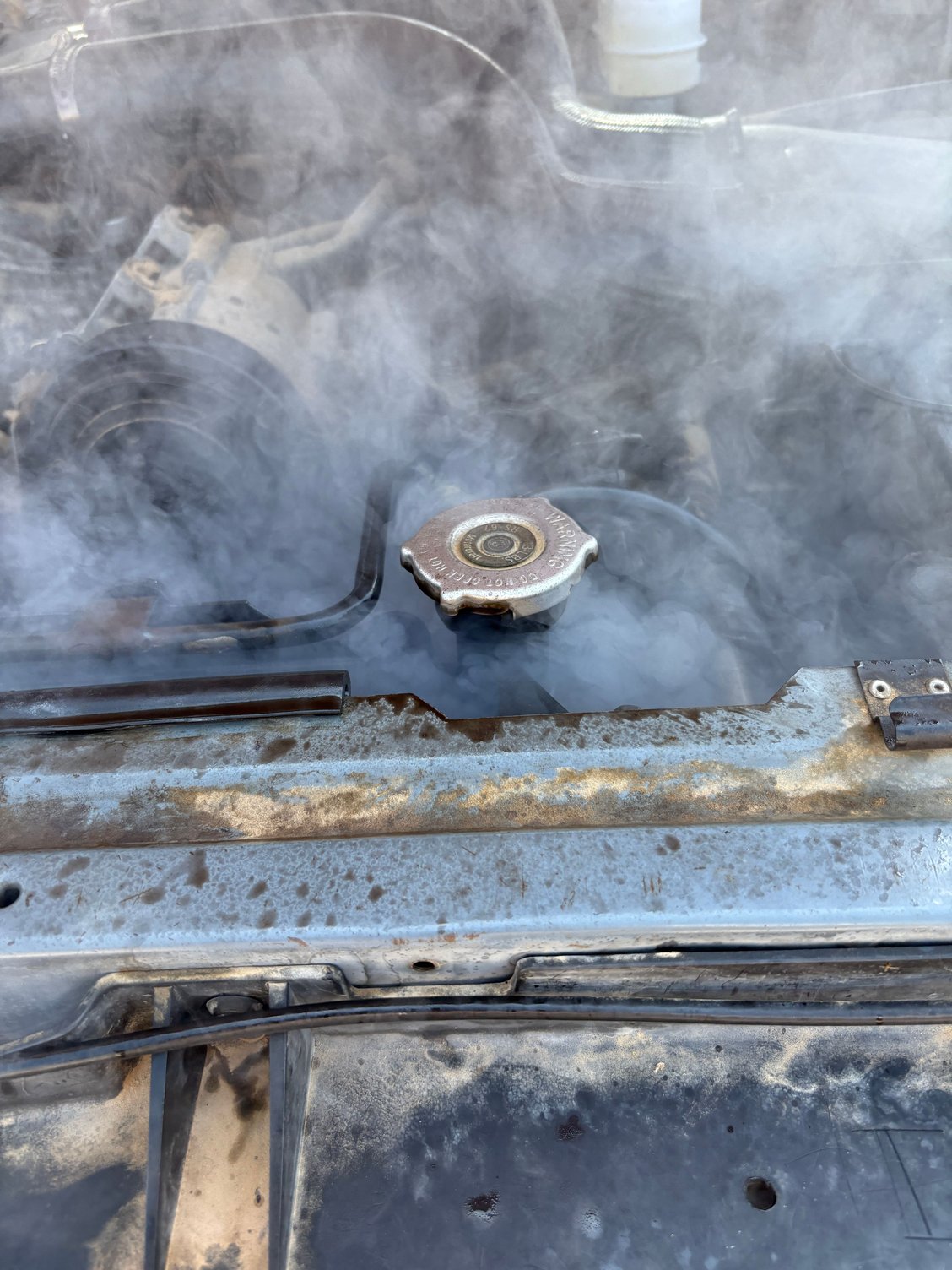

Overheated
So when idle doesn’t seem to overheat
webt to get the emissions testing done and got turned away for a fluid leak - transmission pump seal is leaking hard
about ¼ of the way home the needle hit hot and I pulled off the road to find black water gushing out from the radiator cap and bubbling into the expansion tank.
I don’t see oil/rainbows but it’s certainly dirty water
suspect the PO filled with water and not coolant
any ideas?
no “mayonnaise” in the oil filler cap

1990 F250 with the 460 big block, owned it since monday, its happened twice (ive driven it twice) - 1st time was within 4 min of firing it up and driving but it was only firing on 4 pots...
This time, now that the motor is running on all 8 cylinders - i let it idle for 30 min, no worries - swapped some speed and ABS Sensors then went to get the emissions done - 11 miles each way.
Stopped on the way to get gas so add mile for the detour.
Didnt over heat until the way back and its 102 out.

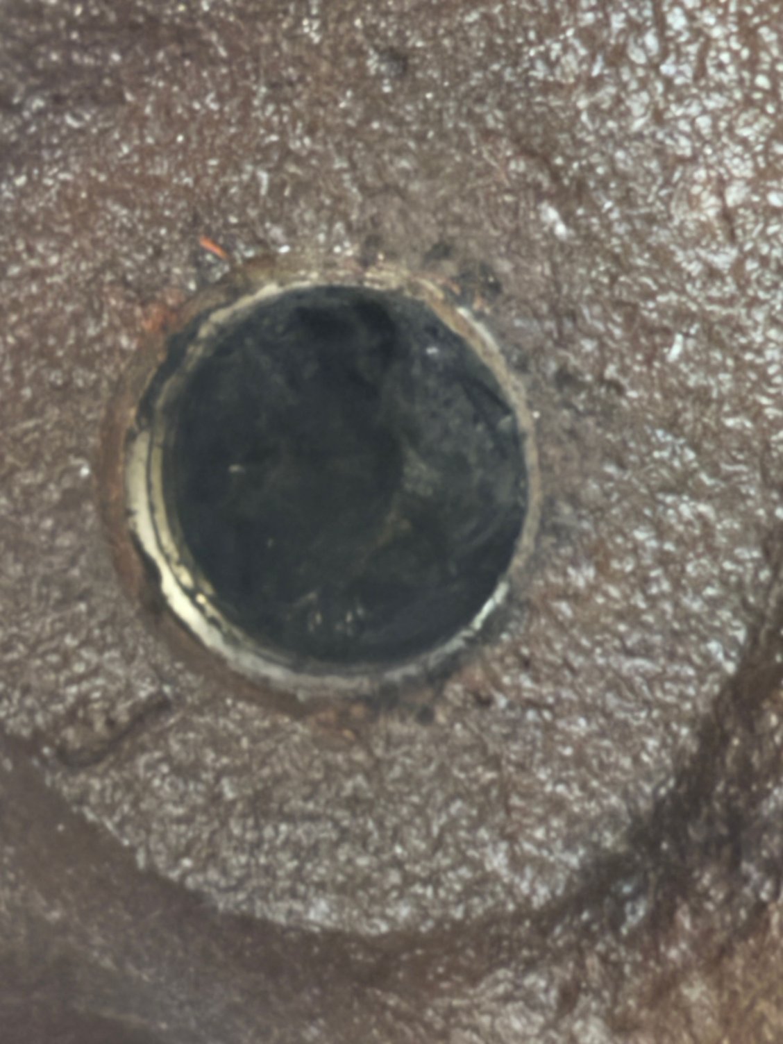

So, thank you all, i am mid flush - smells like pee - like real human pee coming out.
Its black as night but i captured most of it in a huge bucket and there is no oil in it - best i can tell - 35 years of rubber particals.
I assume the 2 10mm square plugs on either side of the block just above the oil sump are the coolant drain plugs?
I got the driver side out and its plugged solid with a powdery black substance - again 35 years of muck?
I have been picking away at it for 30 min and made a dent in it - wondering if i should drill it?
I await your collective advice

does anyone know if I should drill through this sediment buildup?

So, was that a freeze plug? Did it look anything like this, from the outside?
