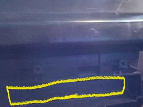

I don't want to cut into the frame

You won’t cut astray unless you’re high or drunk. Don’t dig deep as it’s not a thick piece of plastic. I understand that concern.
The slot you have to cut has a groove you follow all the way around-dig in between those raised areas.
You see that groove in your picture. I traced it in yellow somewhat haphazardly. I slept hard, so I may be drunk😅
I thought the three screws needed to take off the cover were 7mm or 9/32” if not 8mm aka 5/16”?
Been a few years since I changed one out and had to pop that cover off.

Attached are pics. Light Source was not the best.
I would love to see in there better.

Good job!
Shop vac with an extension on the end to clean out?
Yeah, that’s not anywhere near as comfy a spot to work with that I remember when I first put that CAF in. I did the blower motor resistor back in May or thereabouts and it definitely wasn’t a fun squeeze.
I’ve got one of those Klein inspection scopes with the built-in light that would see up there. Maybe you can bum one off someone or a parts store rents them.

I couldn't even get decent space for a picture in there.

Yeah, that definitely does not need much to cut. I used one of my box cutters and not much of it at that. It was like cutting through butter once it got started, though.

Used vacuum tonight to get all the dust out of there.
