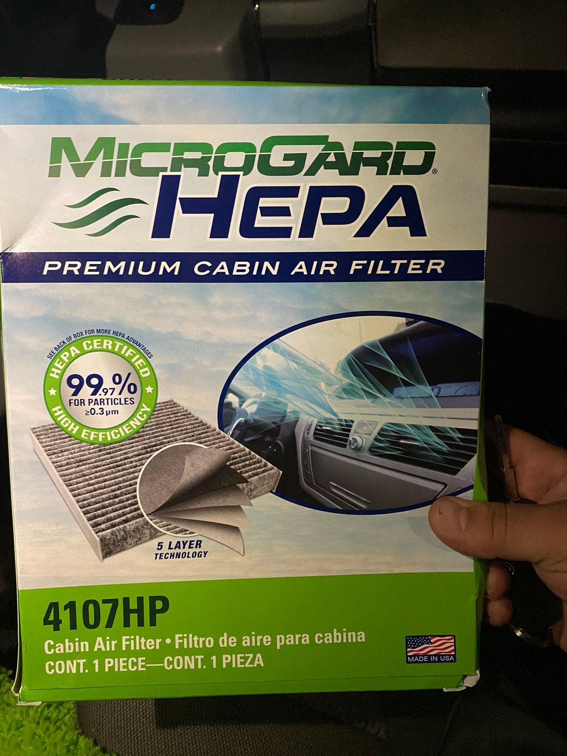

Had to swap out my cabin air filter the other day.
wow, what a huge air loss I am noticing! It’s probably 50% of what it was.
the picture is what I bought.
looking for recommendations on a different filter for more air flow

anything hepa rated is going to restrict flow that 5 layers takes its toll. It like the factory air filter vs a k&n. To filter smaller particles flow is a trade off. If you go with the same part number -the HP you will have the flow back. I’ll add drive it around for a week. Maybe it defrosts the windows fine and you get less dust in the cab. Maybe the max flow isn’t needed.

Ended up taking the hepa back. Got another filter from Advanced for $18. Looks similar to factory and I got my air flow back. Seems like it’s a bit more than the factory filter 😎
