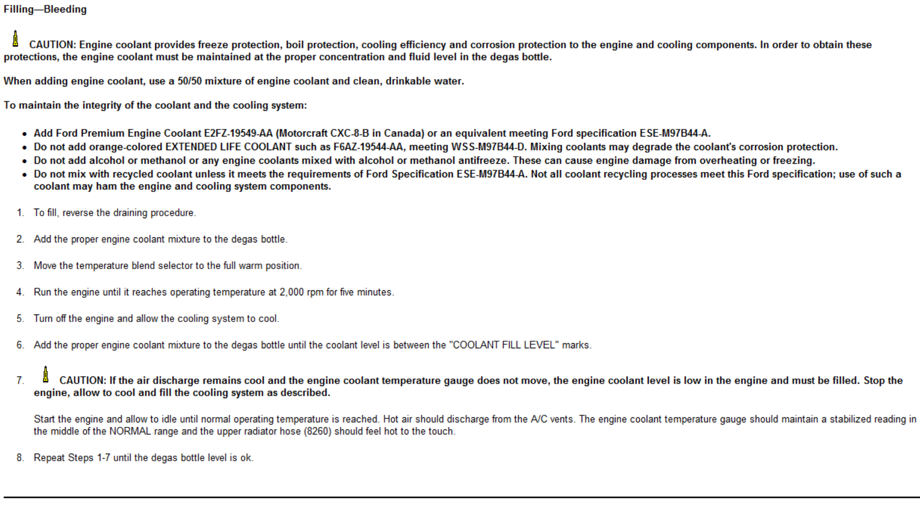

The snips below were taken from the Ford Service Manual section 303-03.

Update,
I took it to work. It was about 30 miles there and back. It did mix well. The reading was -45 from the degas bottle. It still looks full, maybe it went down half an inch.
I know it’s supposed to hold 8 gallons. But I still have 1 gallon of distilled water and 1 gallon of a 50/50 mixture behind my seat, waiting to add 2 more gallons so it can reach 8 in total. Even though I have never been able to fit 8 gallons in it, even after flushing it three times and changing all the coolant hoses. The most I have ever managed to put in is 6 gallons so far. I am thinking the block is holding onto 2 gallons of distilled even when you pull the block plugs and all the hoses. Or the Heater Core, no way to drain that.
I have a big trip planned at the start of September with my 5th wheel. If there is a 2-gallon air pocket, it should flush out during that trip, I guess.

There is no 2 gallon air pocket. It mixed and your protected to -45, your good.
