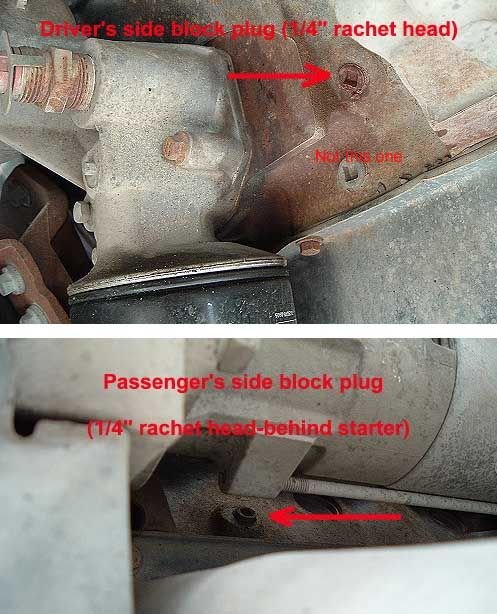

Spray those block plugs a couple of times with PB Blaster a few days ahead of removing them. Really helps out a lot. Check all hoses while you have it drained down. Good luck!

If you haven't pulled the coolant block plugs before be careful on the driver's side. There are two plugs near each other. One is for the coolant and the other is for something else (don't know what but I know it's not coolant). Don't pull the wrong one.
The driver's side one is near the oil filter bracket and the passenger's side is near the starter:
