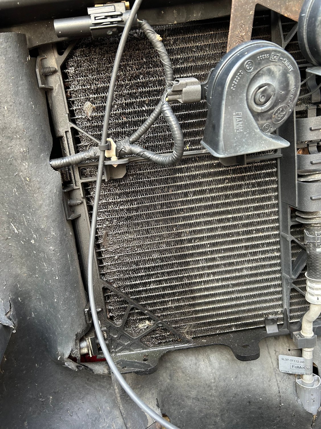

Oil cooler leaking?
I have a leak on what I’m assuming is my transmission oil cooler. When I look at replacements, they are a fraction of the size that is currently mounted in front of my radiator. I’m assuming it’s transmission fluid that’s coated on the left side of it. Been monitoring fluids and nothing has been low. Truck is a 2009 F-150 with 4.6.

That is your air conditioner condenser leaking.

The power steering cooler is integrated into the AC condenser, so either way you will have to replace the AC condenser

Yeah I realized after driving out of town this past weekend that that’s power steering fluid leaking out of the condenser. Had to top off my PS fluid a little bit.

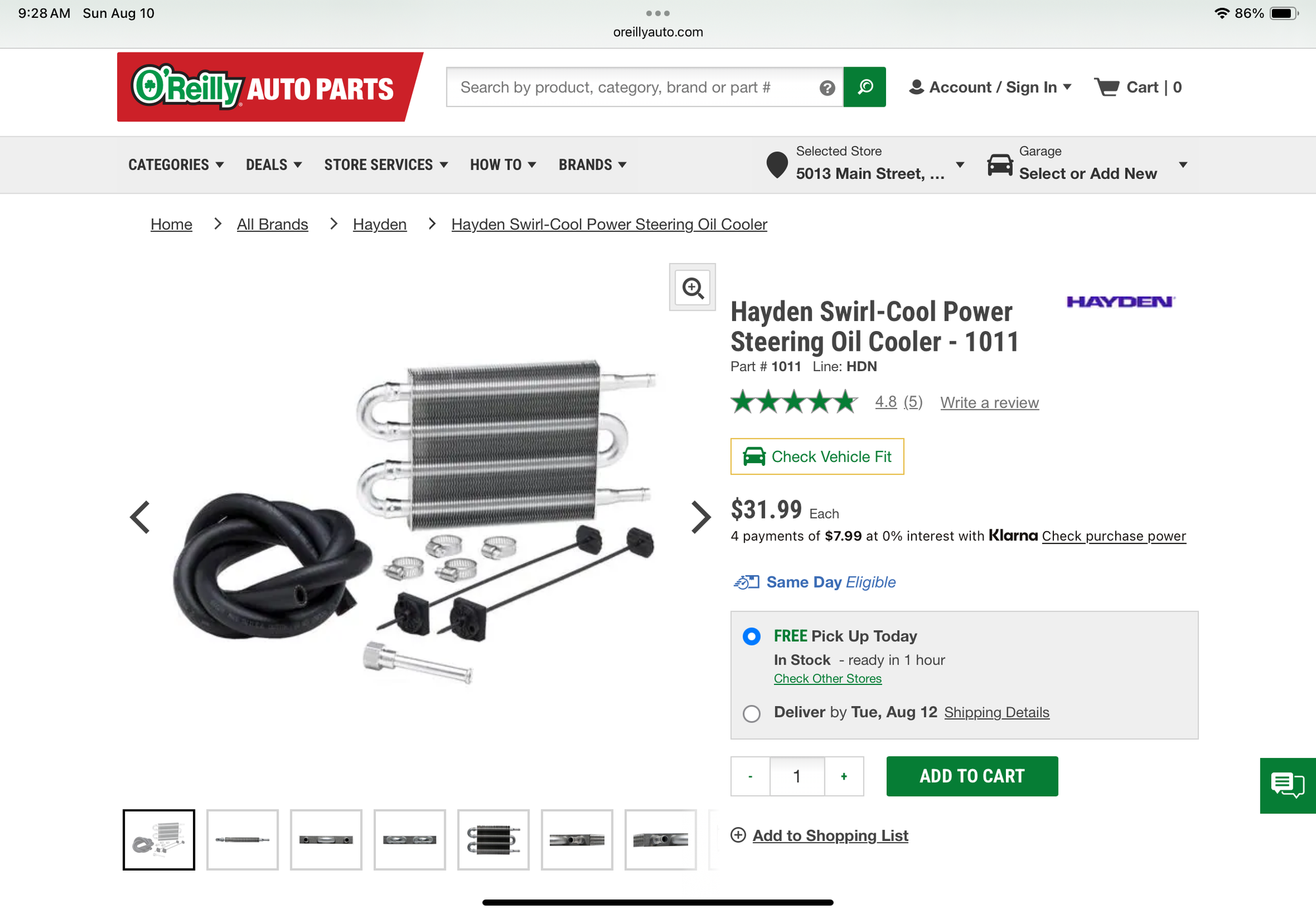

Just curious here, instead of disrupting the AC charged system, what about removing the PS fluid lines and route them to a seperate add-on heat exchanger.

That is what I’m considering doing. I don’t have the equipment to evacuate the system and it seems like anything involving the AC system brings high labor costs at a shop.

has been done boy others on here.
If the ac is working well, that would be my preferred option. Small Aftermarket coolers are really inexpensive and it doesn’t have to be very big.

Just a quick search, for $30 you can’t even have the AC system evacuated for that.

lol was just looking at this one on the oreillys website. This is the route I’m gonna go

That is what we did to the most recent pair of trucks at work, bypass the p/s cooler and run it through a small aftermarket one. You will need some adaptors since the coolers are 3/8” and the lines on the truck are 1/2”
