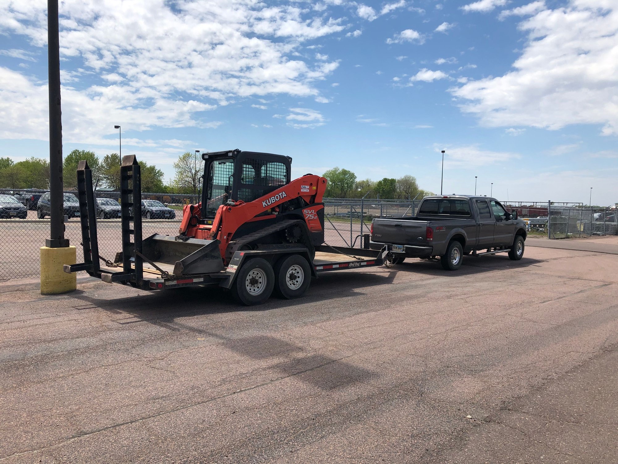

yes, I would. And have. And hit bumps that sent the trailer airborne. And did it with a ball mount rated to 7500. I don’t recommend others do it, but I’m 100% sure it that nothing will break
Just for funsies, do the math on this one. Factory hitch rated to 10k and 7500 lbs ball mount.
he should get them to put a proper coupler on the trailer. And he should use the argument I outlined above to drive the point home.

Will it break, probably never, but he paid for a legal 14k trailer and that's not one. I'm good with gray areas in the law, but that's not a gray area. I doubt very seriously that the dealers word will hold any sway in court for a ticker or litigation. In meborders skid steer photo, just about all us have done it, but if pulled over that vehicle is out of service until fixed.
