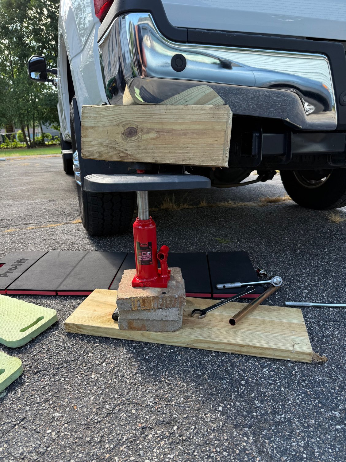

I did mine this afternoon:

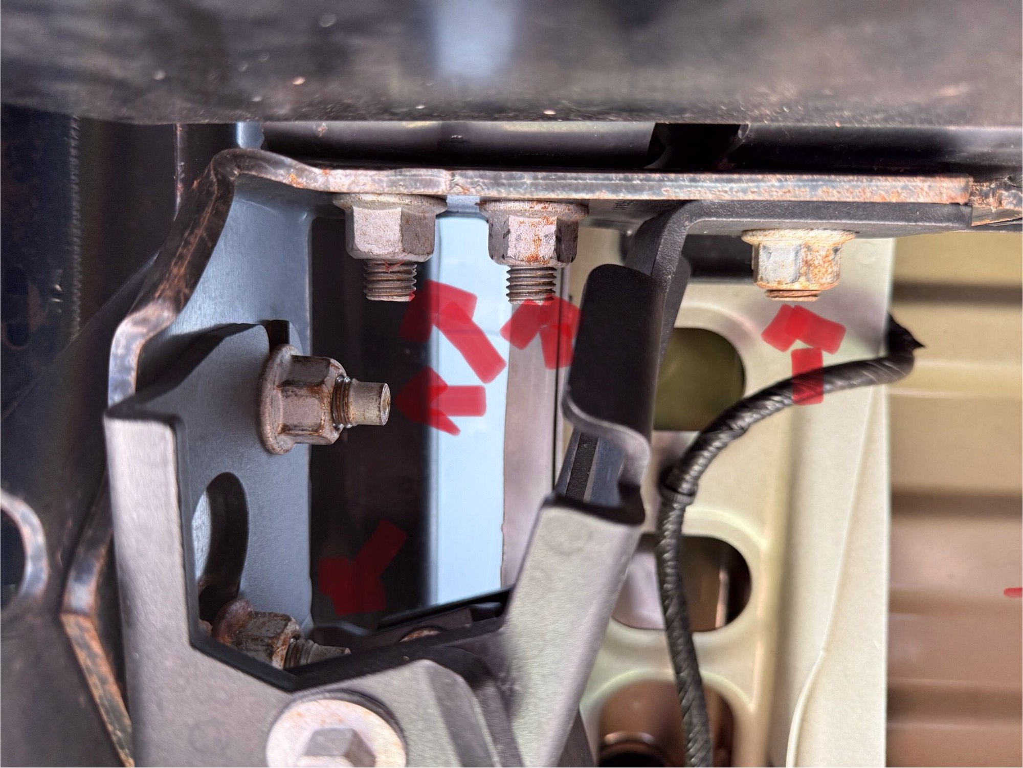

There are six 21 mm fasteners. I needed a breaker bar and a pipe to get them loose. One requires a wrench as access is tight.
I used a bottle jack to carry the weight of the bumper and lift it up:

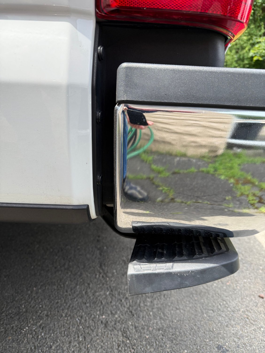

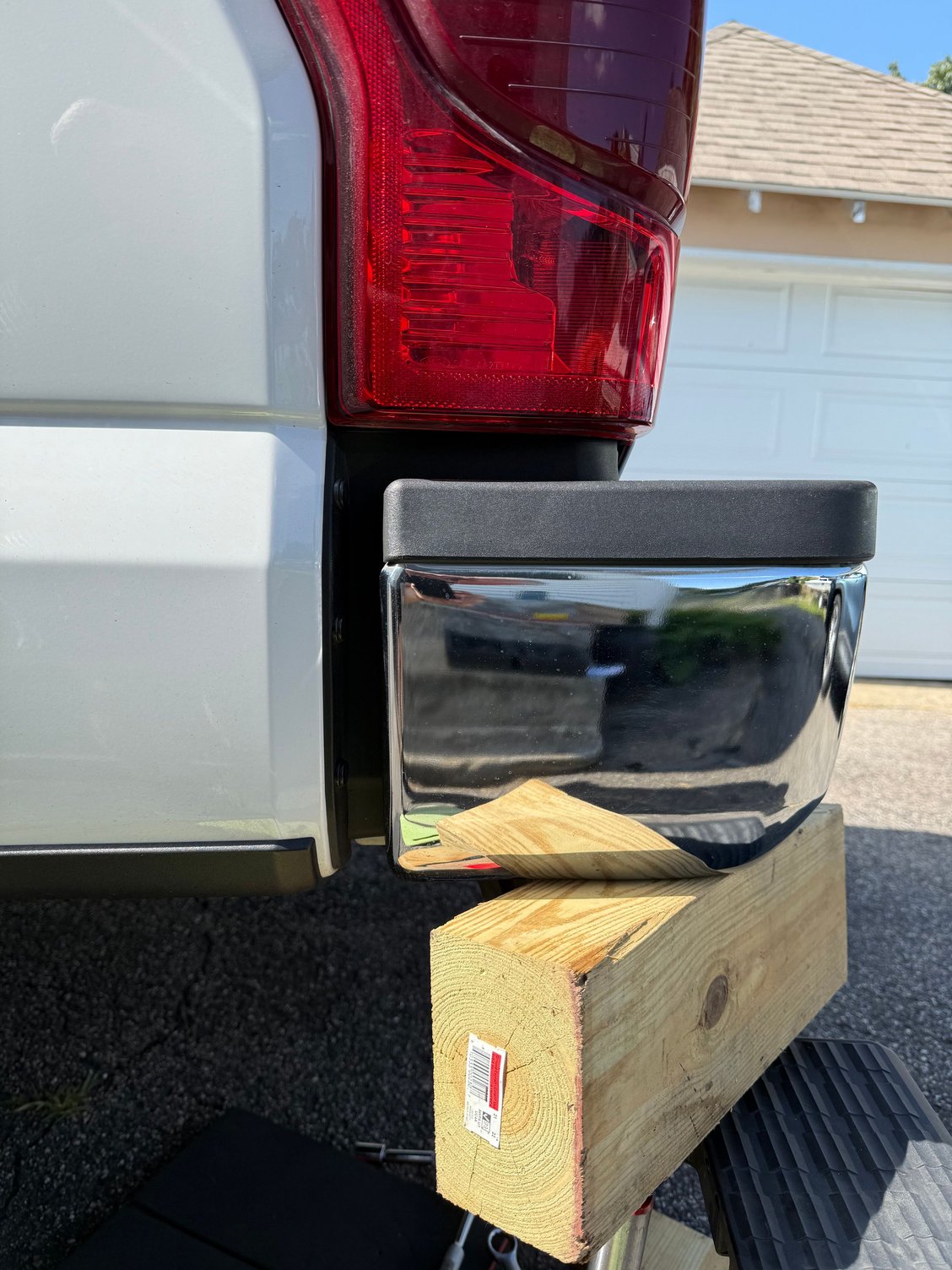

Before and after:
The left side of my bumper was down about 3/4” more than the right side. Now they are equal. Not hard to do but man those fasteners are tight.
I hope that this is of use to others.
Bob
