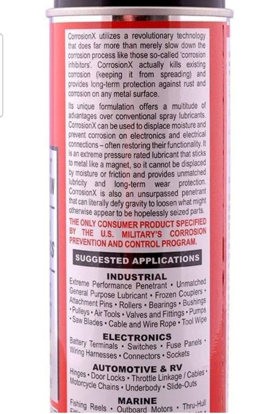

Good luck with this...
Once you are good to go, take a look at this stuff to spray into your fuse boxes to avoid further problems.
We are talking about this in the 6.7 section. Just putting it on your radar.
I've had no issues with mine but plan to buy a can and spray into my two fuse boxes to prevent any issues moving forward.
https://a.co/d/ioOhQae

Thanks for the tip .
my thought is that you will have to dismantle the fuse box for that to really work the best .
there are 6 layers of plastic panels , all with a metal trace ...
