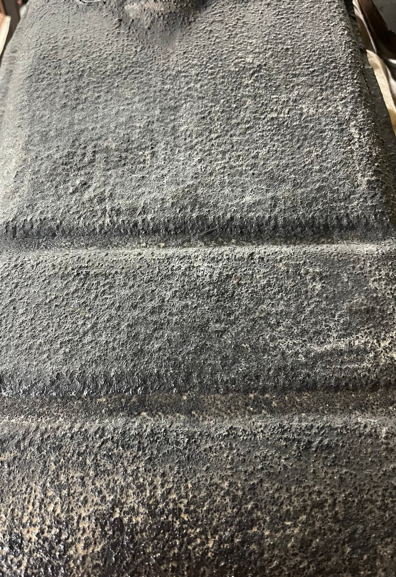

I was going to put some adhesive sheet sound deadening on the floor of the cab of my F250. However the previous owner has covered the entire floor, including under the seat with something that looks like bed liner. My question is, do you think this bed liner stuff will prohibit the use of the adhesive sheets I plan on using? It makes the floor quite uneven. Here's a pic of what's on my floor.

Try a small piece under the seat and see how it works.

Do you know how thick the bed liner is? That looks to be pretty rough and thicker than most. Test to see if it will peal up alone a edge. Because it it was not prepped right it will peal off. As far as noise control is, the more you add the quieter it will get.

it's sort of thick and it's been on there a couple of years. I'm just wondering if ai can put some of that adhesive sound deadening stuff over it.

I know the tar/foil baking sound deadening will stick to just about any thing as long as the surface is dry and clean of dust/dirt.

It should work just fine.
I just finished my cab and I used a liner material for the floor and then put killmat over it.
Make sure it’s clean and dry and use your tools to get it pushed down into the nooks and cranny’s.

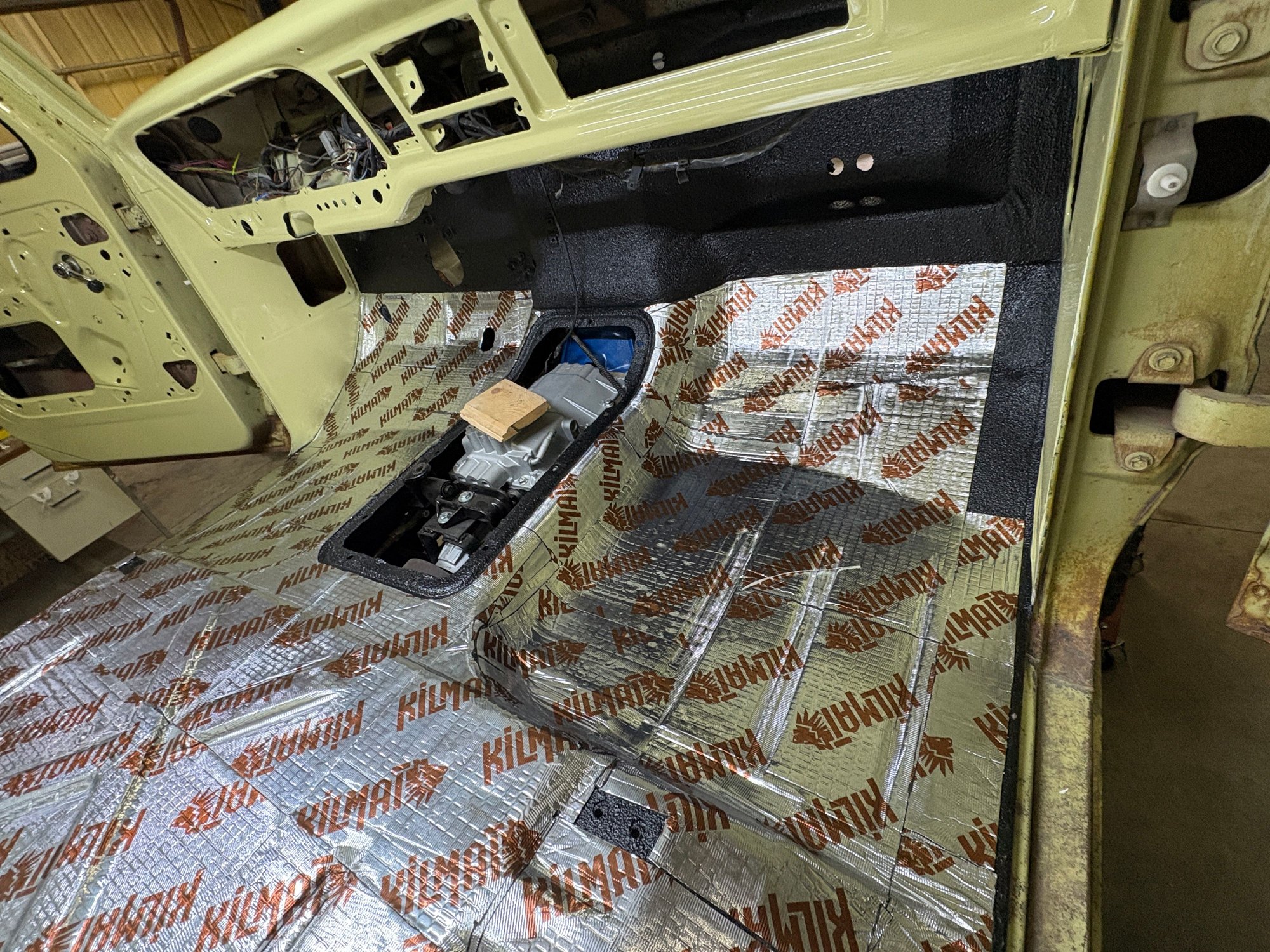

I used Noico in our 69, it had under coating sprayed on it, i used armor all glass cleaner first then left it for a couple days because of other things to do, then laid down the Noico and rolled it out with the metal rollers.
