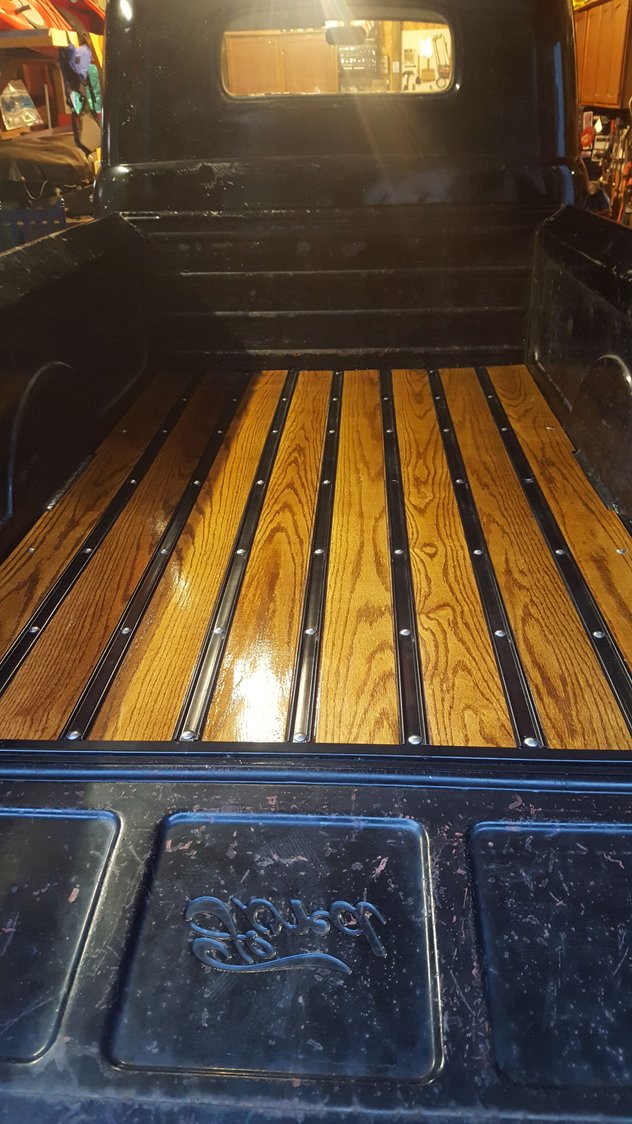

Was having a steel floor on the beds of a 49 an option? I'm just getting started on the restoration of mine and it has a steel floor with wood underneath. I would
Had to replace some supports.
Oak harvested from our property.
much rather have the nice finished wood look when I get my project done . The metal floor isn't perfect and wonder if cutting it out to expose the wood is the way to go.
Exposed wood was not an option in 49. I read the reason for the wood under the metal was to absorb shock of loading things in the bed. We removed metal and wood and did an oak floor.

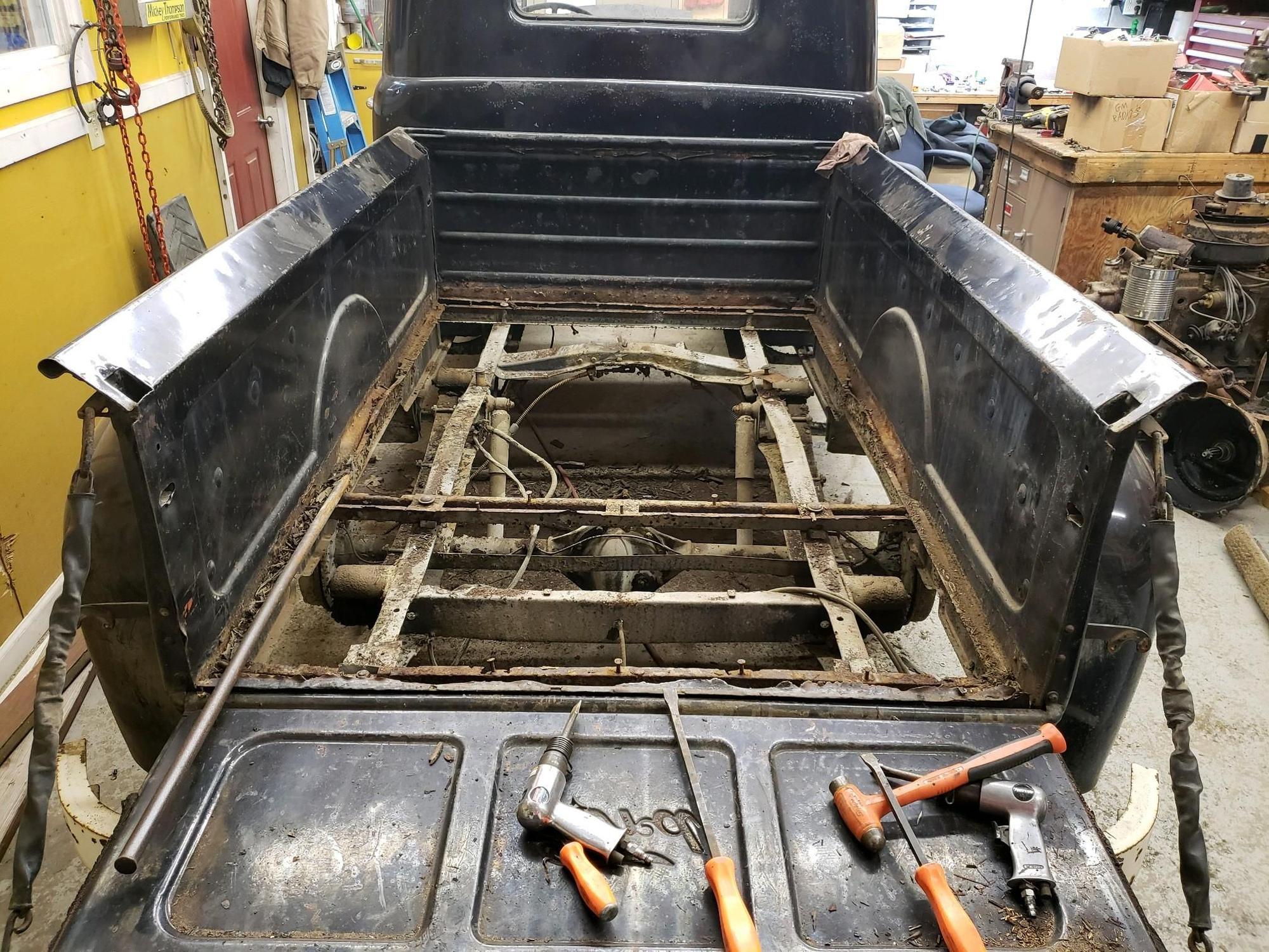

You don't want to expose the wood below for a finished look.
Ford used all sorts of wood as the subfloor and some pieces are even cut on the diagonal. I'd guess the wood in mine was either pine or poplar
As Ken did in the pictures above, I cut out the damaged metal floor, removed the wood sub-floor and replaced with oak in the 48.
