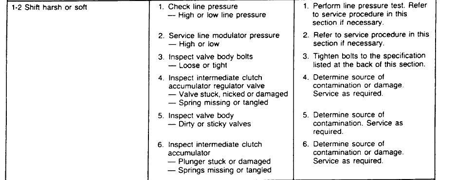

I had similar hard shift issues, and my truck once went into neutral on a busy highway at 60 mph, but dropped back into gear after letting off the gas pedal. After reading many posts here, I decided to replace the MLPS aka neutral safety switch. I have had no problems since.
