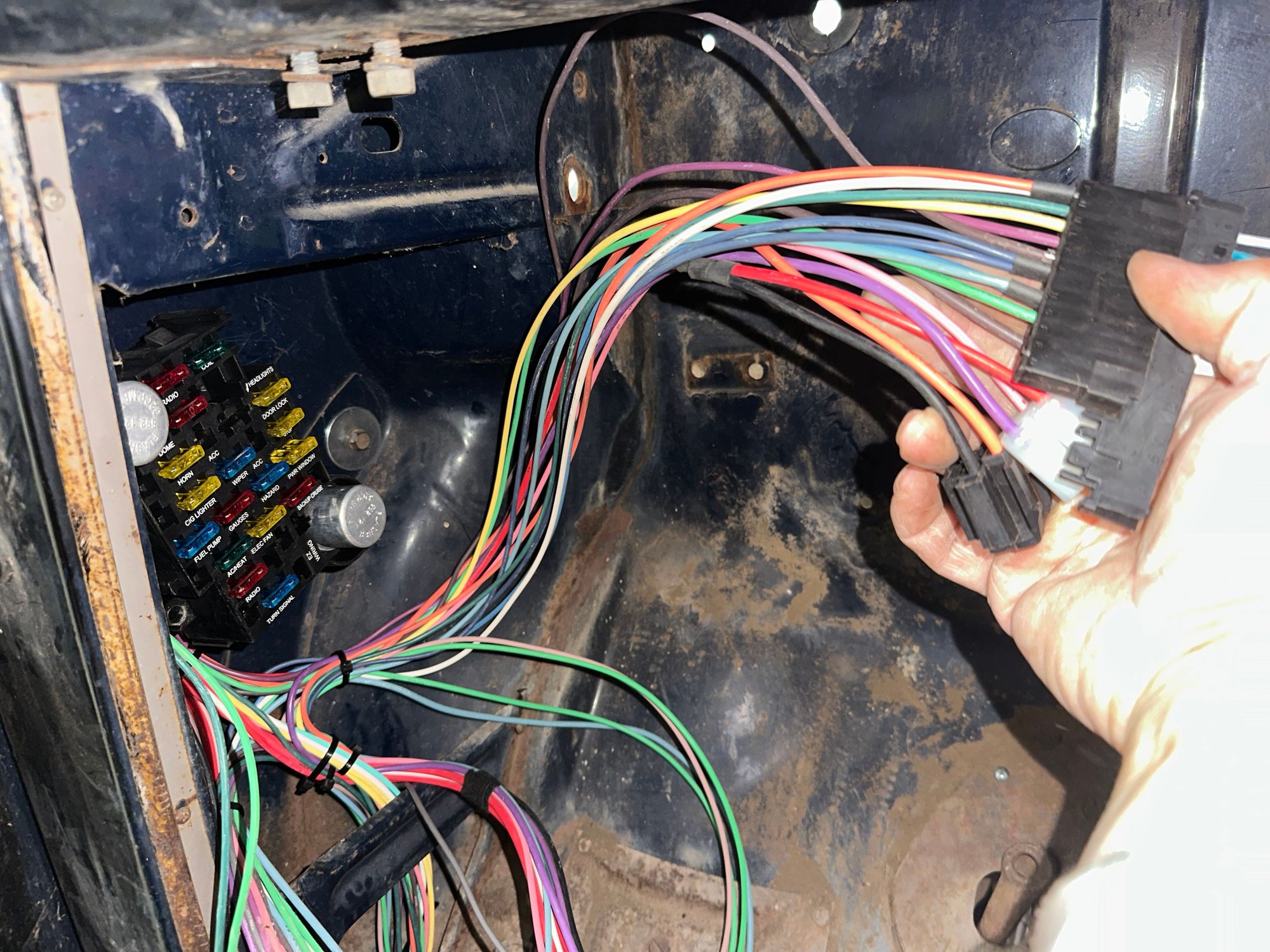

Originally Posted by EFranzen
I made a panel that fits into the driver side kick panel area that swings out for access.
That is nicely done, looks great, good idea, good work. Thanks for posting. I think I might steal it for another problem child project I have.
Unfortunately, I don't think it is going to work. Once you get all the wires (flashers and relays ?) on there that have to flex and bent with the door it will be difficult.

Originally Posted by fullyford
I think I’m going to hide the fuse box in the driver kick panel. Made a mount just have to figure out how I want to mount it. Front and rear in think will run out the bottom of the cab corner. Engine in think will come out just above the transmission. Ordered a duetsch connectors and some grommets
I have a truck with the fuse box and other electronics in the drivers side kick panel, I mounted a piece of 1/8 aluminum on some of the fender mount bolts, I used slightly longer bolts and mount the aluminum on the part sticking out with a extra nut. I used I think a 1 1/2" or so PVC male adapter to pass the wires through that exit under the truck.

So now I’m not sure if I’m gonna put it in a kick panel. I want to keep it hidden. But EZ wire makes some other under dash wires very short so I would have to lengthen them. The steering column wires, I can make work. But the pre-wired ignition plugs I would have to relocate the key to the left-hand side of the dash. And then there’s a few other wires that would be running up to the gauge panel. I feel like they’re gonna be short as well.
