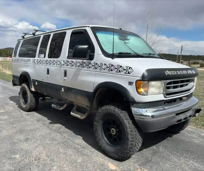

Thank you all for the input, after going back and forth between the 7.3L and the V10 I ended up going with the 2001, E350 7.3L UJoint 4X4. I took it in for a pre-purchase inspection and the only mechanical issues that were identified rear drive shaft seal had a slight leak, low cold crank amps on one of the batteries and the front ball bearings were showing signs of wear.
The van will be a decent project converting it from a wheelchair accessible van to a multi-passenger captains seating, cutting out body cancer and replacing the sheet metal, and general TLC, but I think in the end the family will love it. I truly appreciate all the insight and y’all taking the time to walk me through your experiences and opinions on the matter.
-Tom

Looks like a great project!
I bet folks here would be interested in seeing progress along the way if you're willing!
