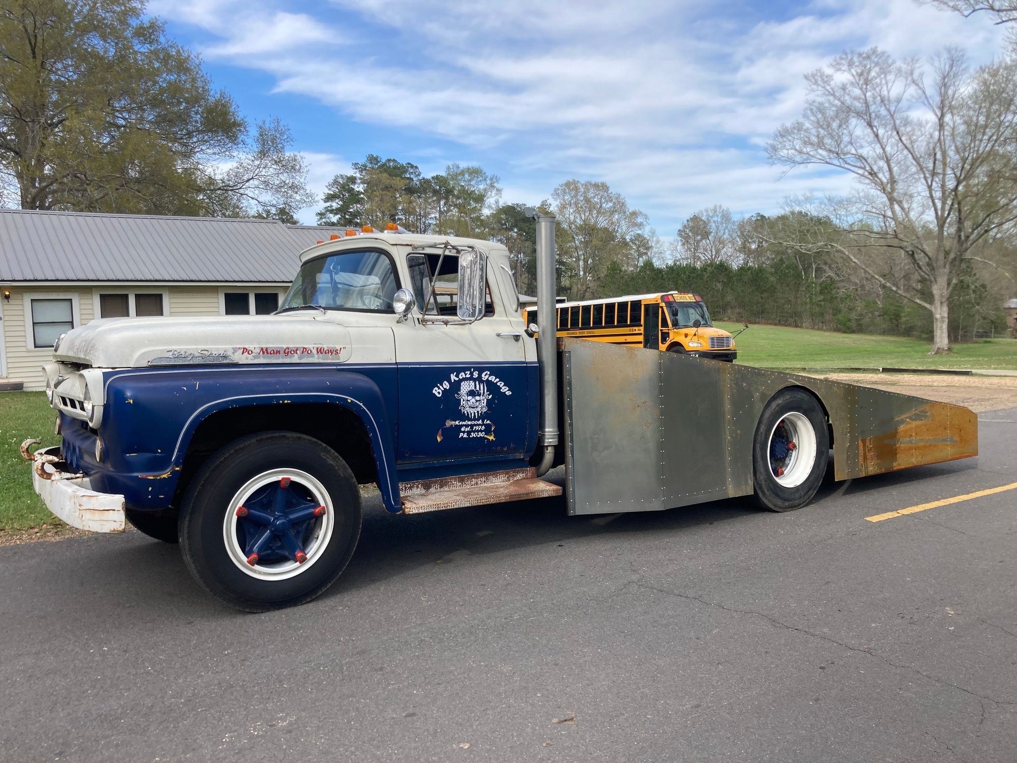

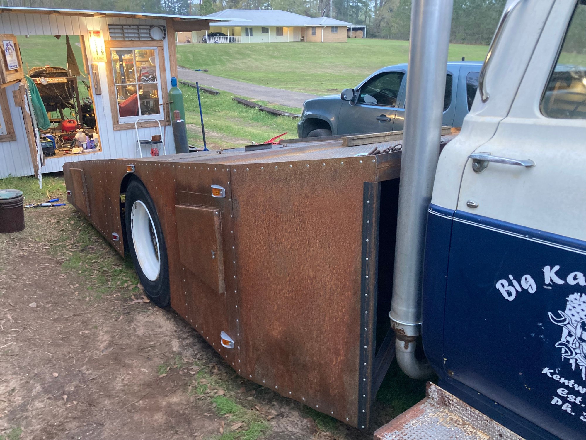

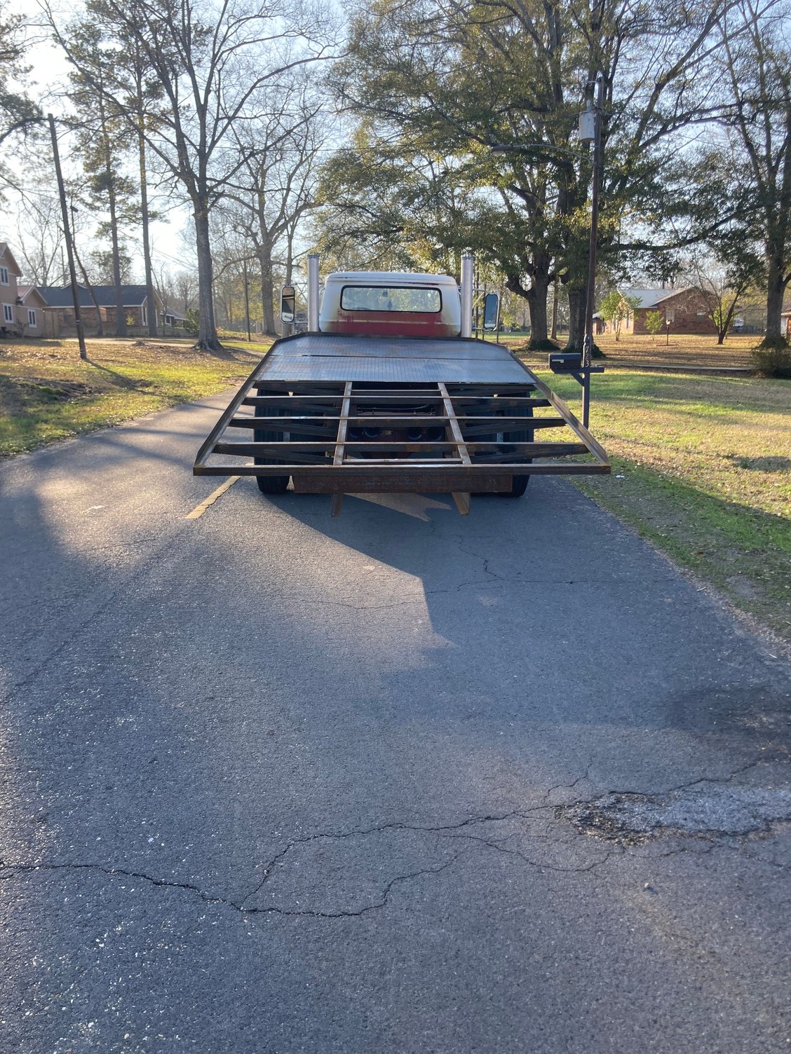

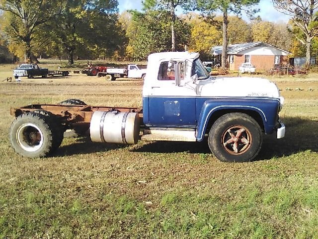

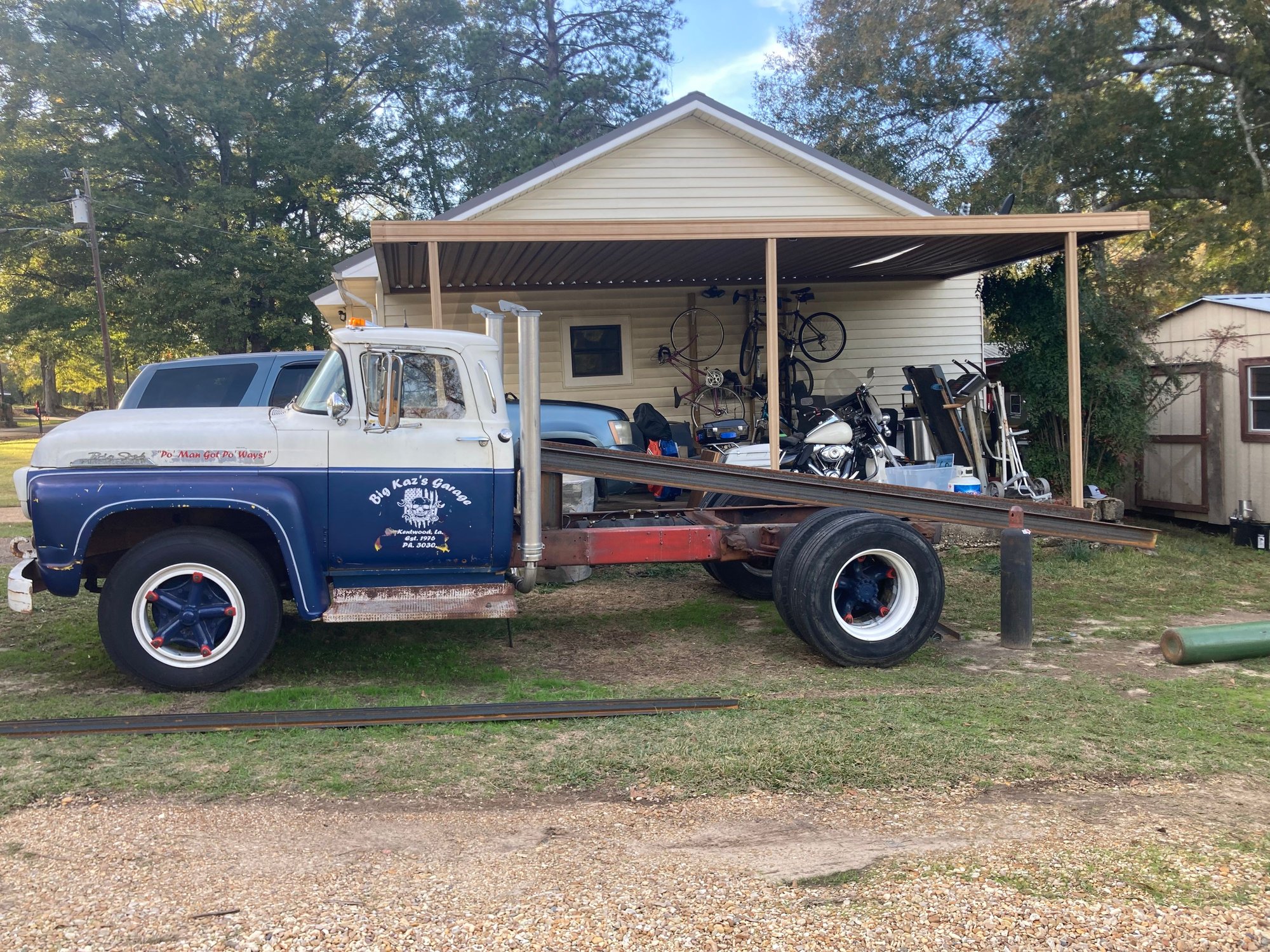

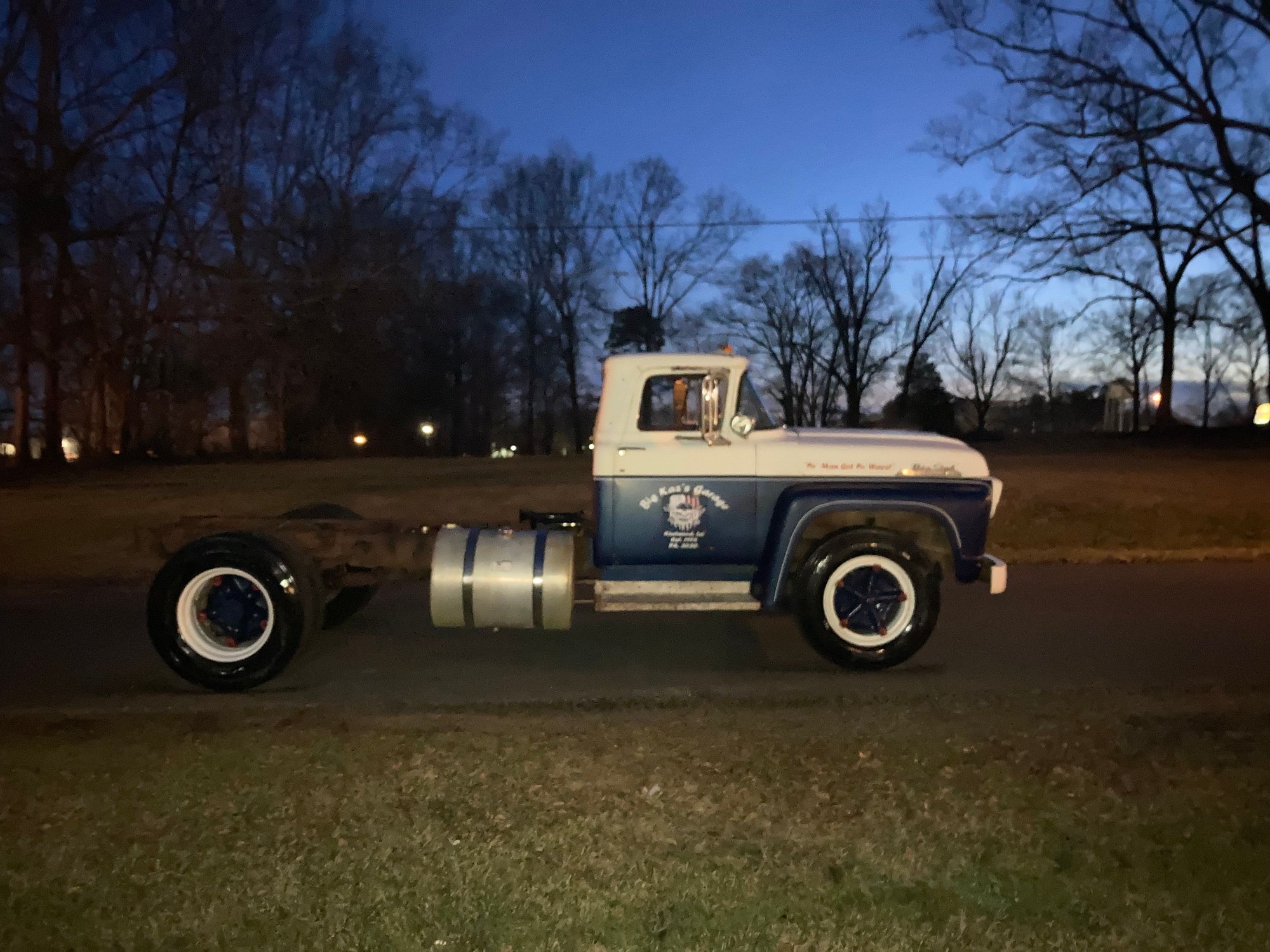

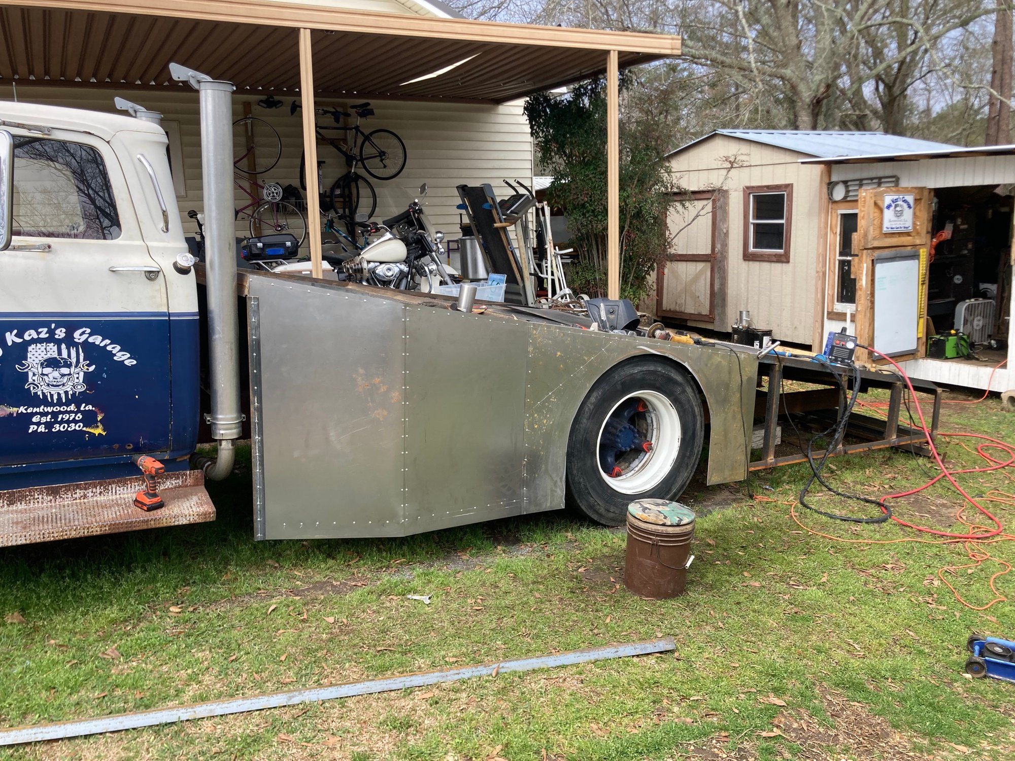

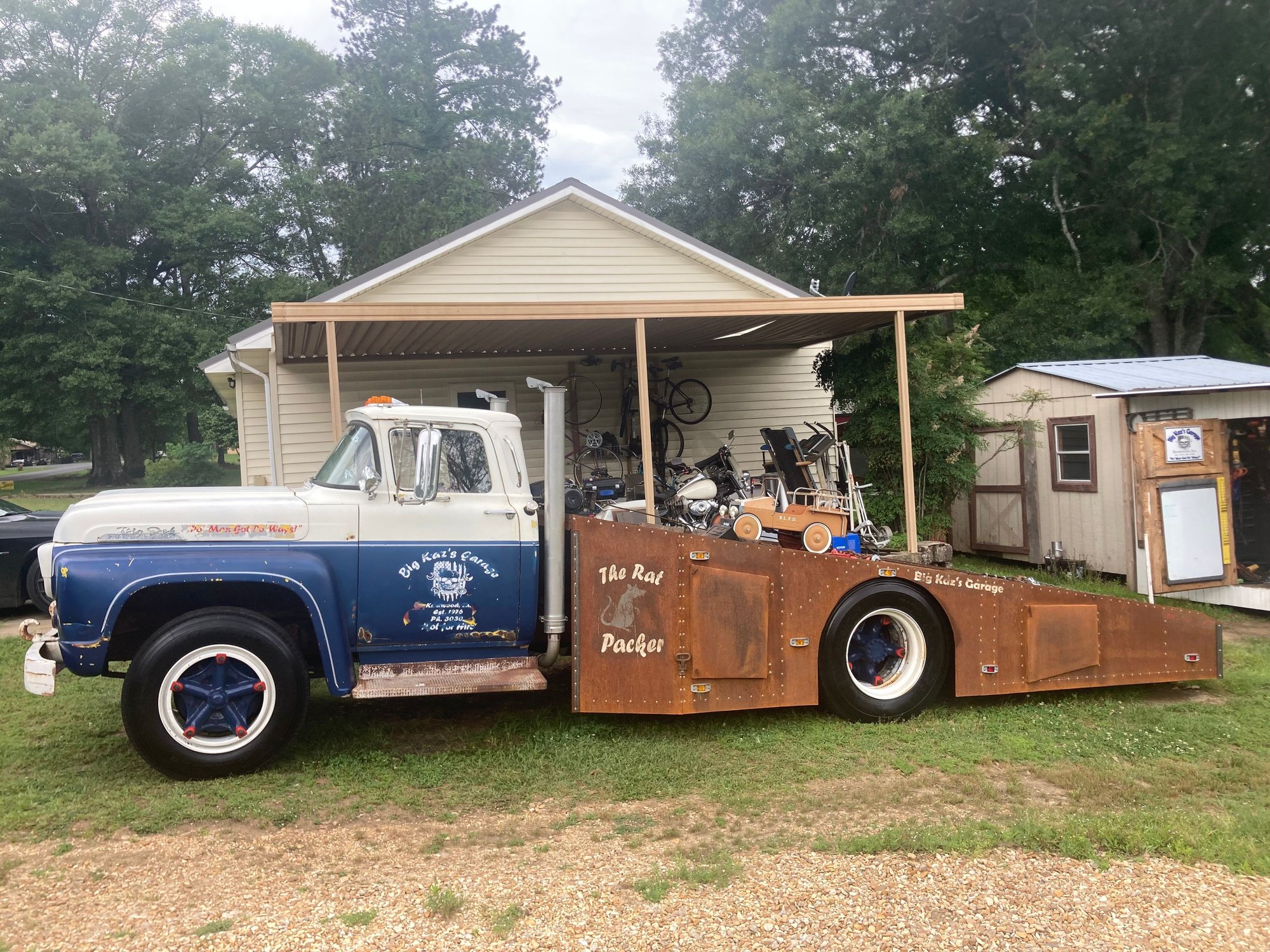

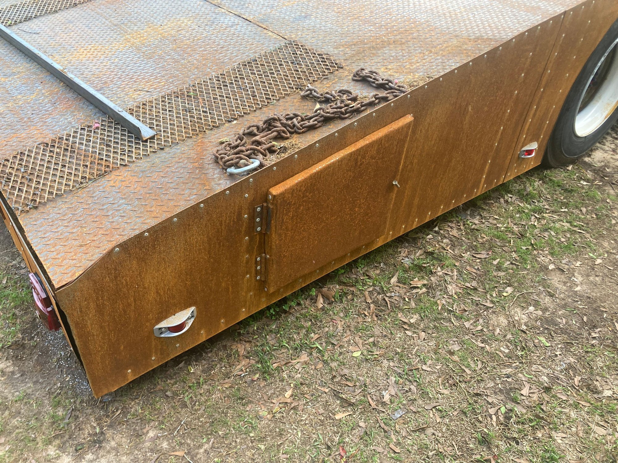

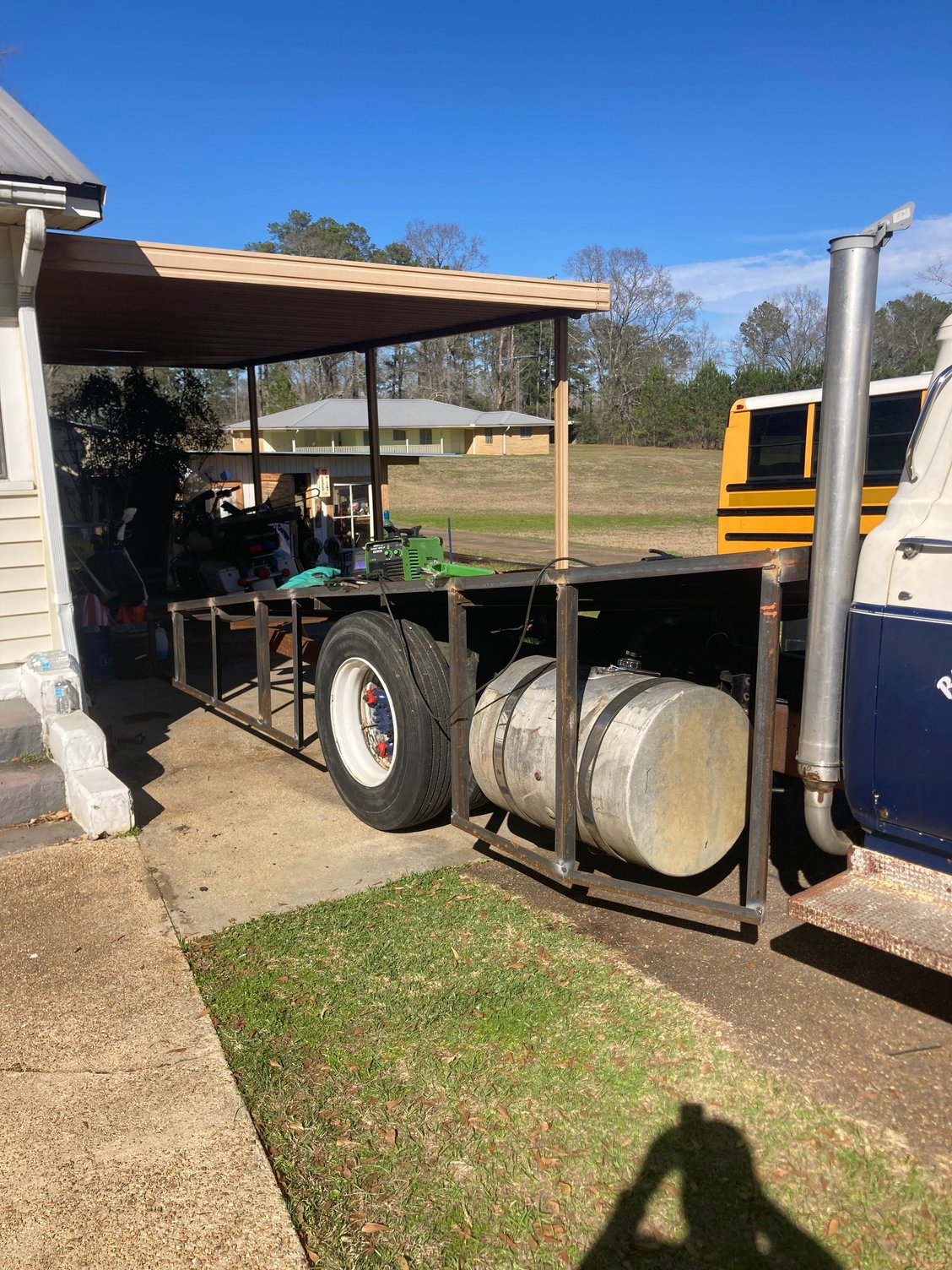

This is what I built.I probably have about 1,500 in the metal. A lot of welding, riveting , and cursing! Started with 6” channel down the middle. Then angle triangulating the frame. Diamond plate on the deck and 18 ga sheet metal riveted on that. Good luck!! Ramps are hidden in the center rear compartment. I am I. No way and fabricator or welder. But I’ve had my 08 f350 dually on it and it packed it no problem!!
When I originally bought it. Old fire truck from Polk Township, Marshall County in Indiana.

Channel iron down the middle
Angle iron triangulating the frame
Decking put on
Decking put on
Sheet metal
Sheet metal

After fabbing the access doors

Back view
Back view
Side view
Side view
The Rat Packer
The Rat Packer

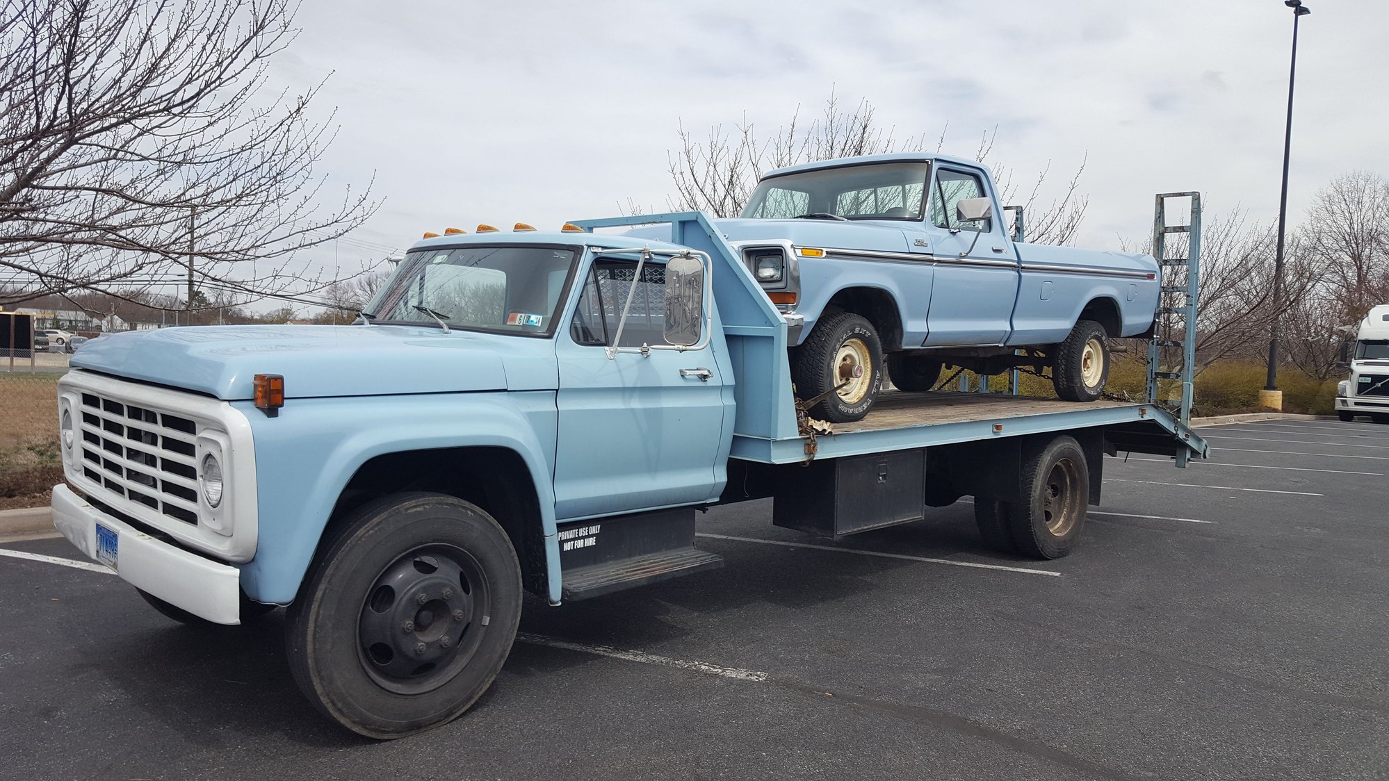

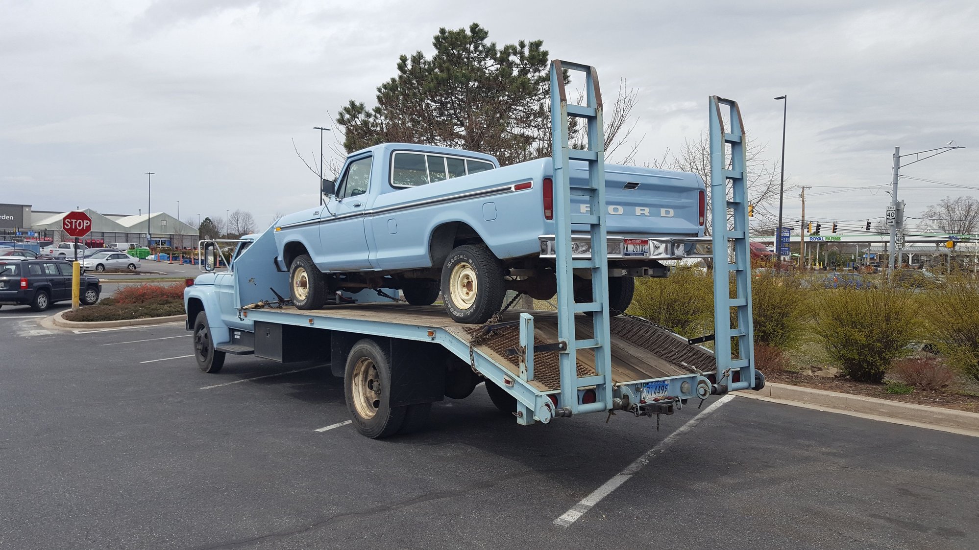

This is my 75 f600 ramp truck, 212" wheelbase, 20' bed. the ramp is a little steep in the back, but it's very versatile as I can haul just about anything on it other then vehicles. the drawback is that it's too much of an angle to load a car. It could be fixed with a longer less steep tail, but I only haul trucks so it works fine. The wedges are nice but difficult to haul anything else on them.
