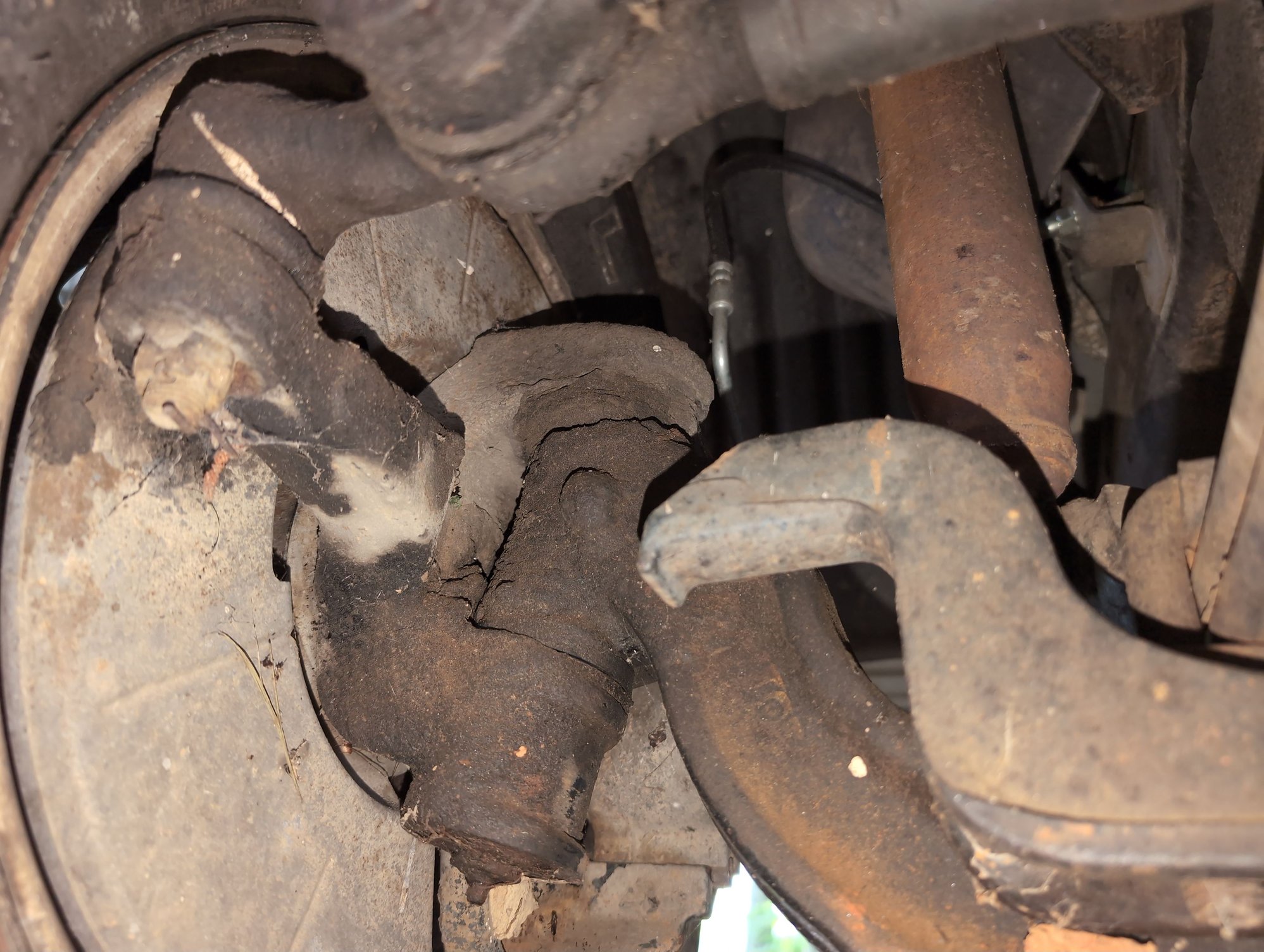

Posts: 7
Here are bunch of front end pics.
