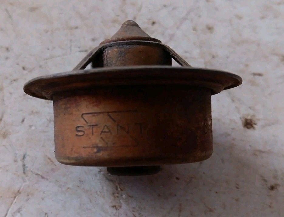

I didn't drill a hole in mine, I used a very old t-stat with an ancient part number, similar to this: https://www.ebay.com/itm/12693804801...Bk9SR-Kg4a7mZQ
Stant S-330-H 180
These were called "high performance high flow", but I'm not sure how true that is. It was old school and I tested it to work, so I threw it in and 3 years and 20k miles later it's doing fine.

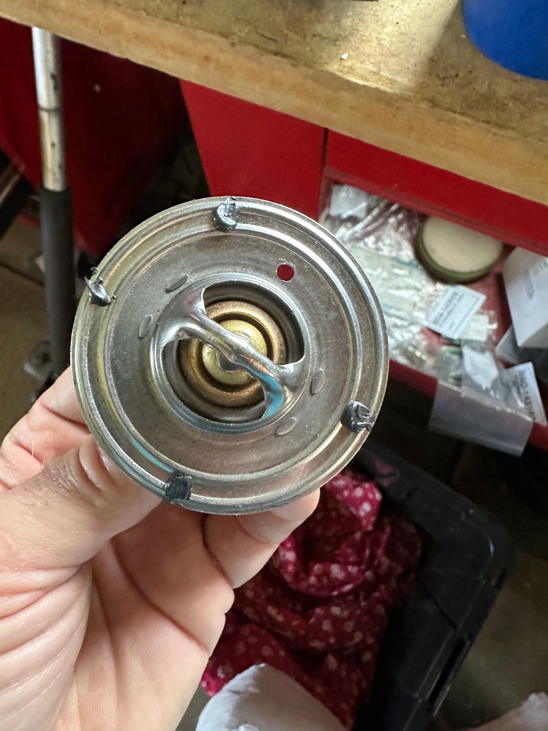

All set to install the thermostat and housing. "Glued" it in place with a little permatex and drilled and 1/8" hole.

Looks good!
Myself I think adding the hole is a good idea. That way as you are filling the radiator the air will dispell as the coolant flows through the thermostat hole and starting to fill the top hose. After you start it up and the thermostat opens, you may notice you'll get less of a belch of air and coolant, because you pre-bled it with the hole in the thermostat. That has been my experience anyway.
