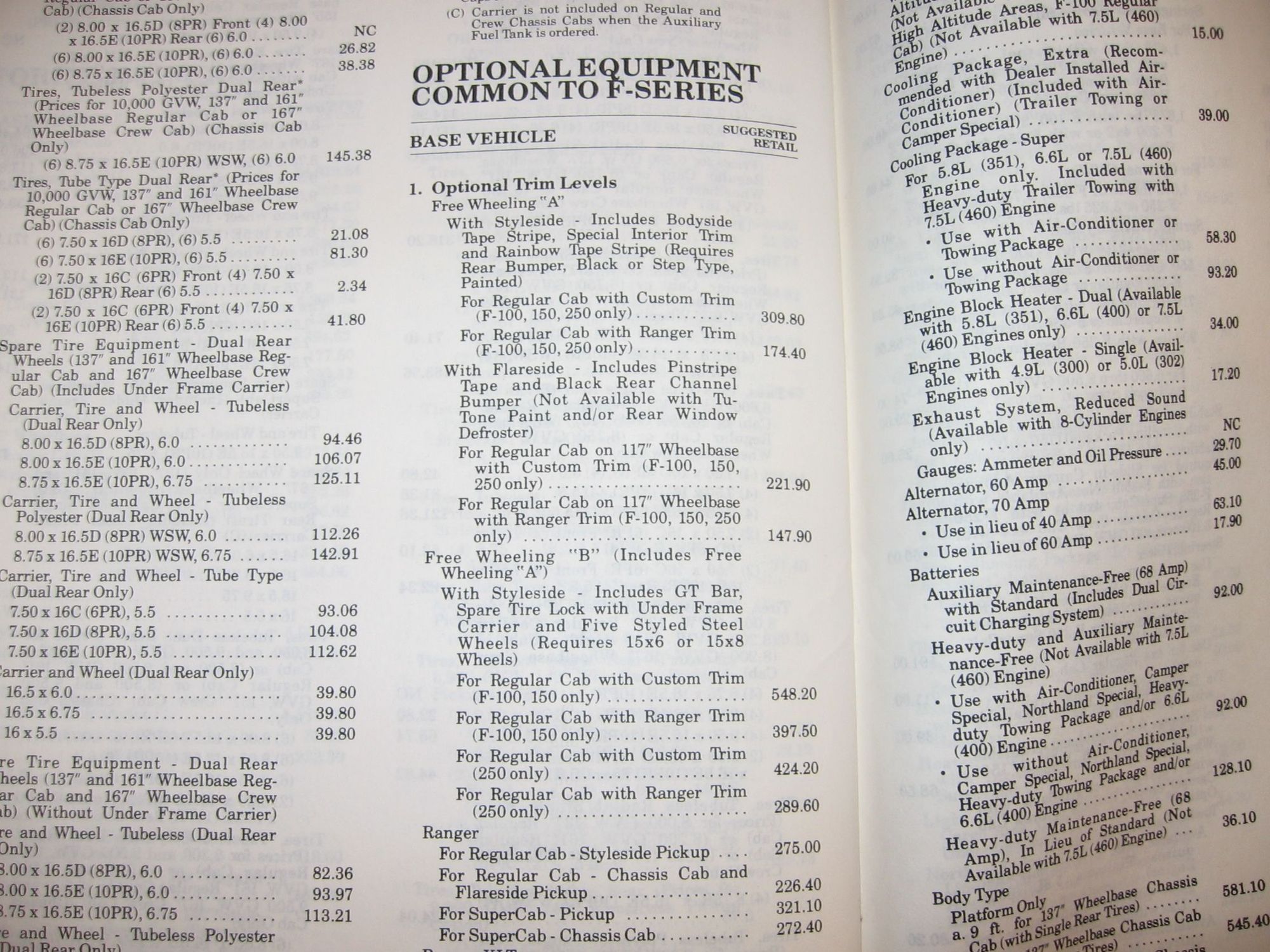

Here's what the 1978 Light Truck Buying Guide shows for the Free Wheeling package & the Ranger package. Note that the contents of the Free Wheeling package changed for 1979, some different items.
Flairside Free Wheeling did not get the multi color stripes, they got single color pinstripes instead.
The Ranger interior was upgraded from the base Custom interior. Different headliner, seat upholstery, door panels, I think color keyed sun visors. I suspect the Ranger interior may have superseded the Free Wheeling interior upgrades, when both were ordered on the same truck. Just a guess on my part. Note that the Free Wheeling option for the Ranger is a good bit of money less than the FW option for the Custom. Could be a discount for the interior change.
There were a few Flairside FW trucks in this area back in the 80's. Nice looking trucks, but the pinstriping was a bit much for my taste.
Sounds like you have a cool truck, nicely optioned. Black & red would look great!
