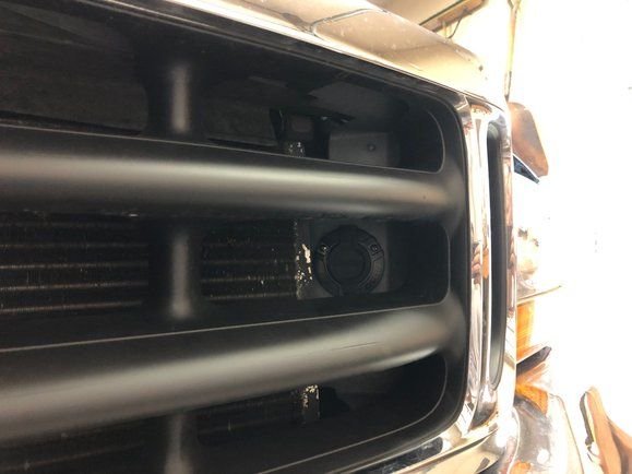

I use the noco genpro10x2 mounted behind the grill. I plug it in as soon as I get home, even though this is a daily driver. My thinking here is that it will prolong the pair of agm batteries, and protect them somewhat in the winter.
My observation is that it always charges a bit even when driven for hours. Does that mean it's working?
Now as far as a dual charger vs single. All I can say is that this device, in fact, monitors and maintains the batteries separately.
It can be done with a single, but the added feedback I get from one battery charging slower or faulting out was worth the extra price to me.
I have been very happy with this unit. It is sealed and takes being mounted to the ex without issue.

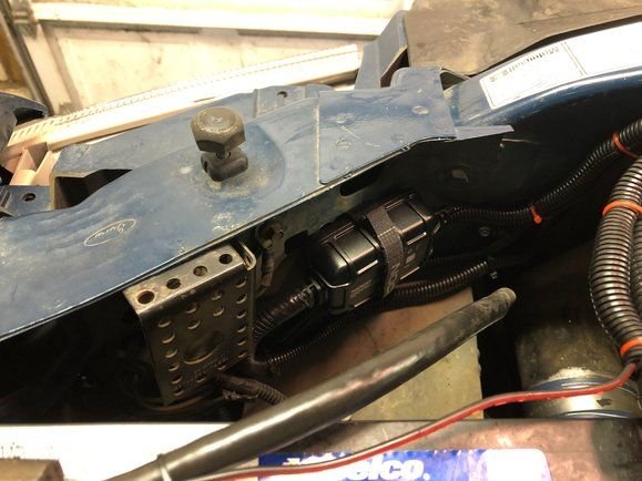

x2 here. Although my batts are the flooded type. I am on my third year, with 2 full northern Maine winters in the can. I have no sense that these Interstate batts are having any issues. I also use the desulphate feature 2x per year.
Also, mine is installed on top of the vacuum chamber.

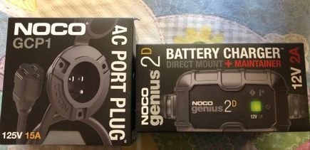

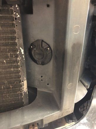

I’m using the Noco Genius 2D for the last 3 years on lead acid batteries.
It’s only hooked up to the drivers side and has been performing flawlessly.
Over 8 years on these batteries now and no signs of quitting. Resting voltage @ 12.7
