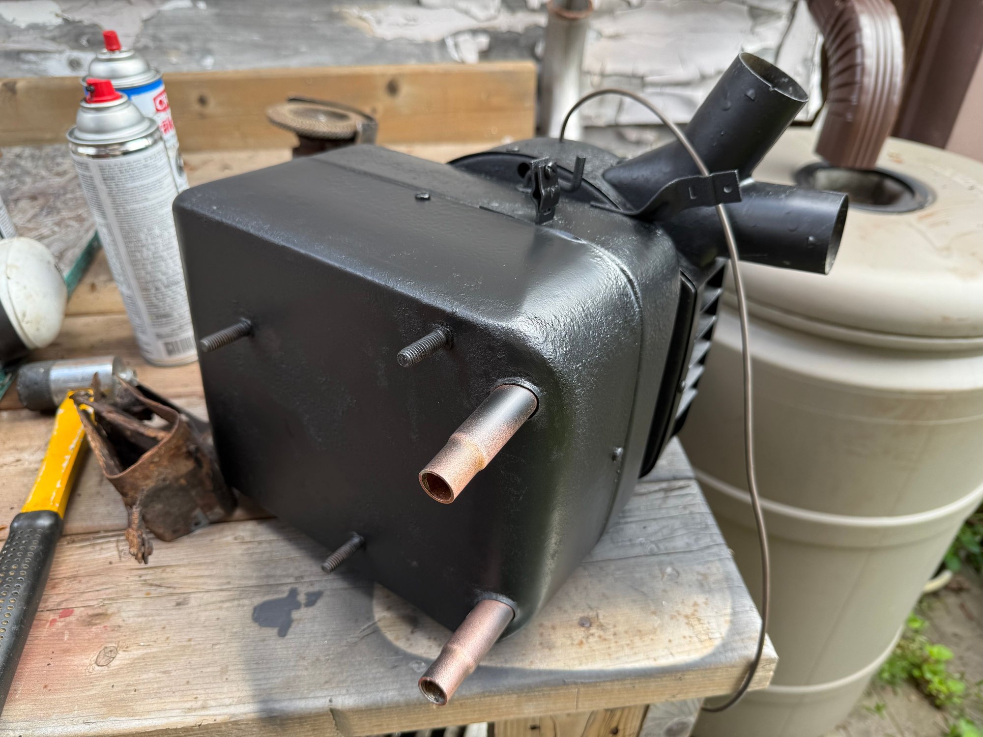

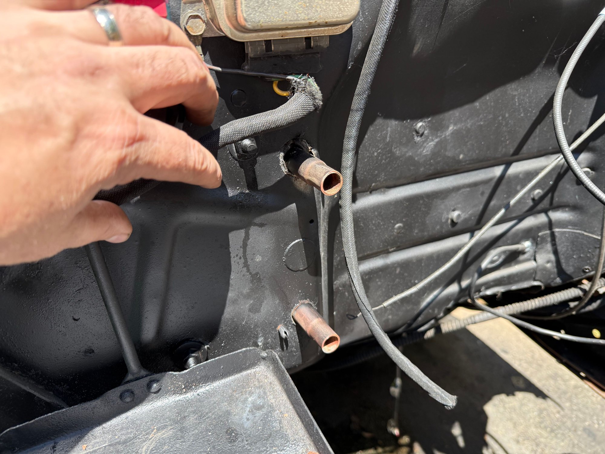

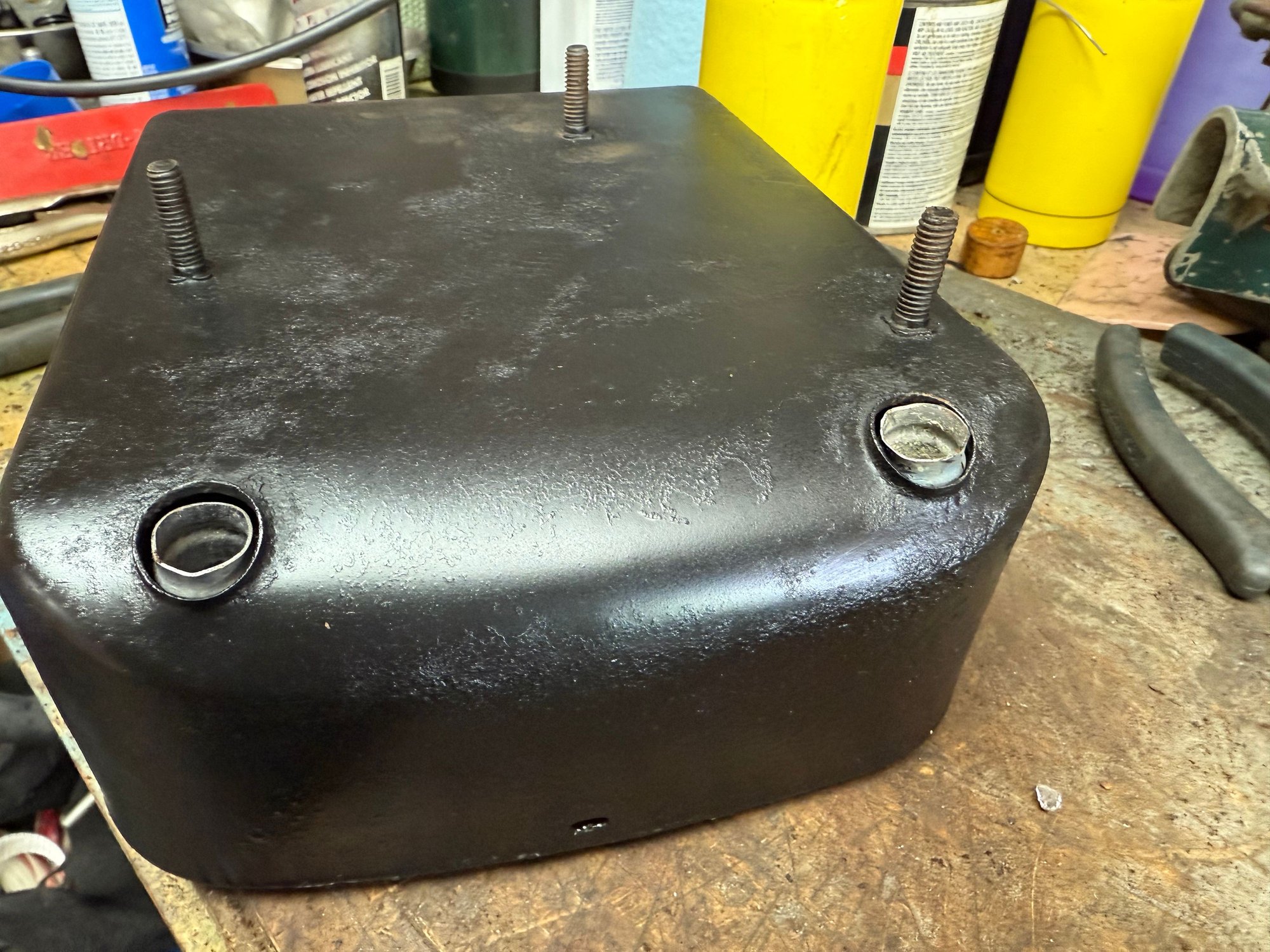

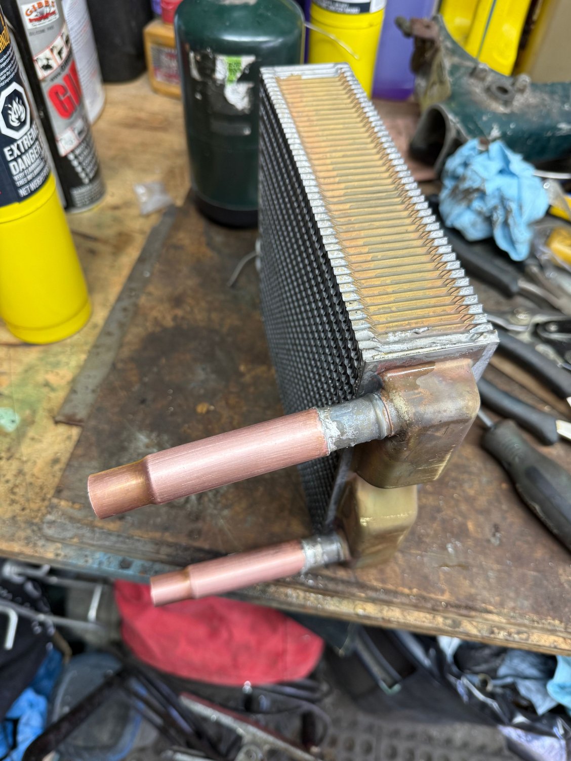

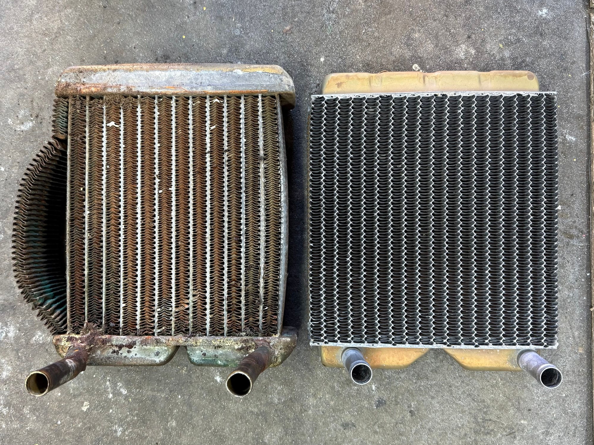

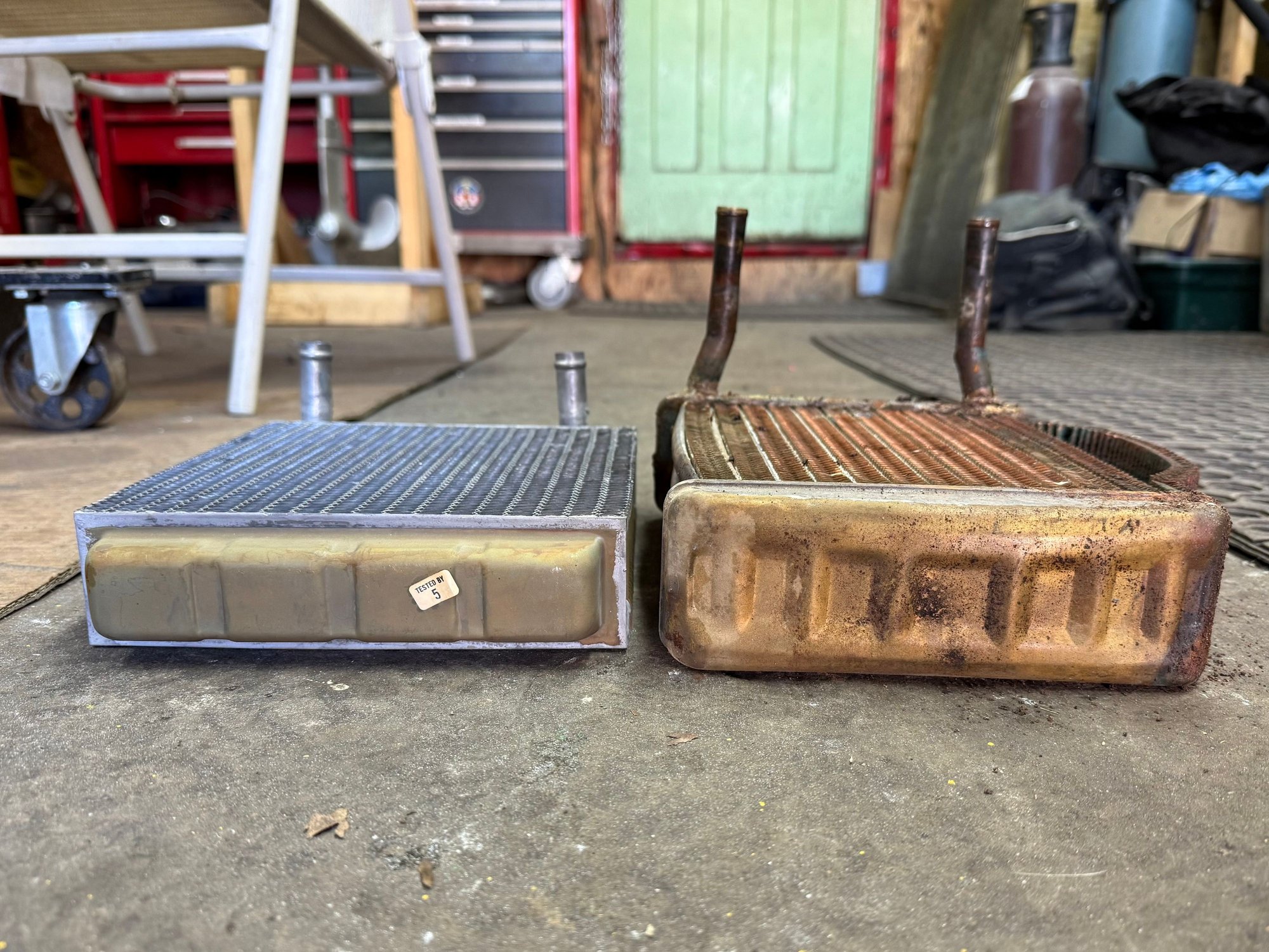

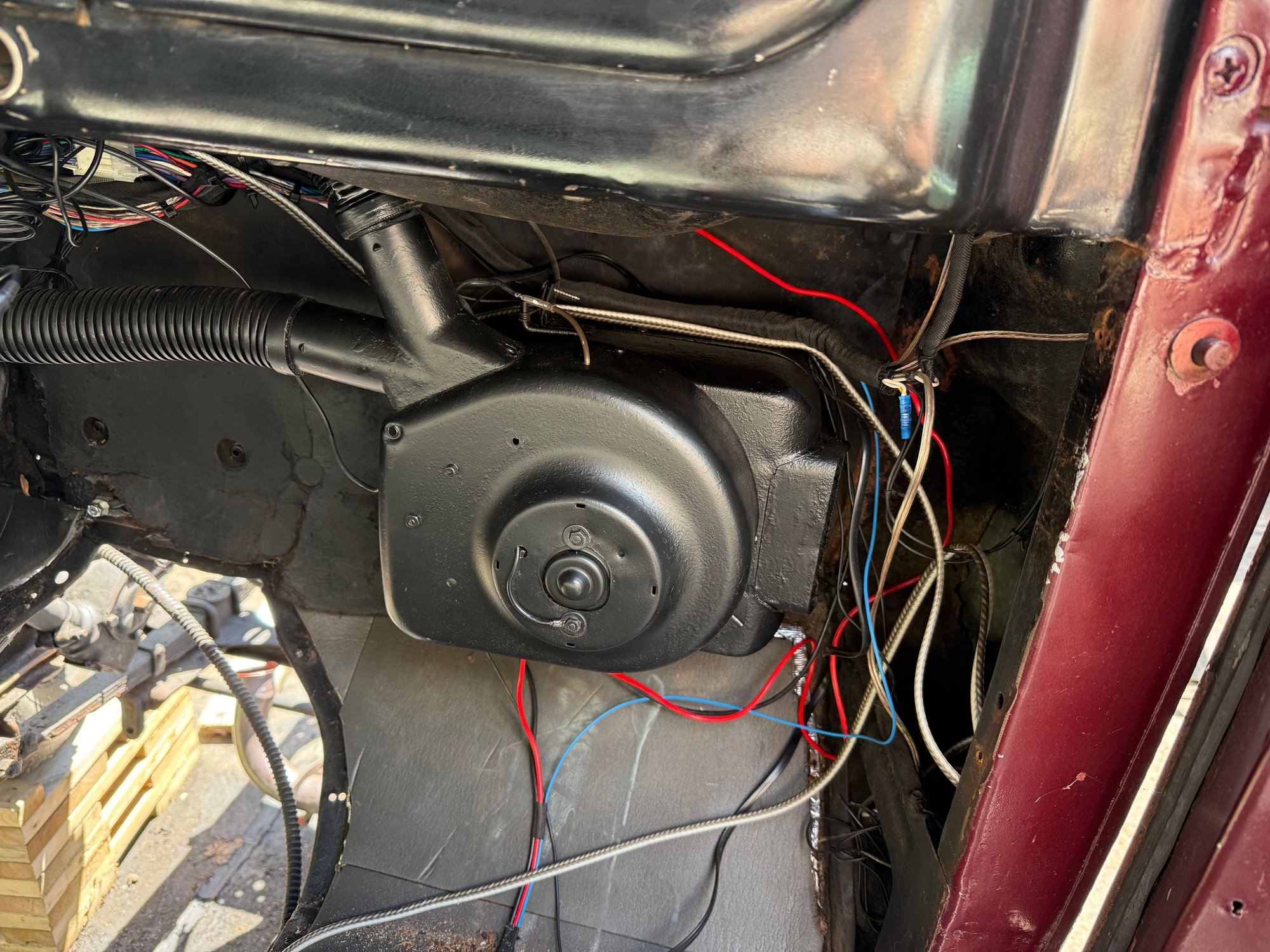

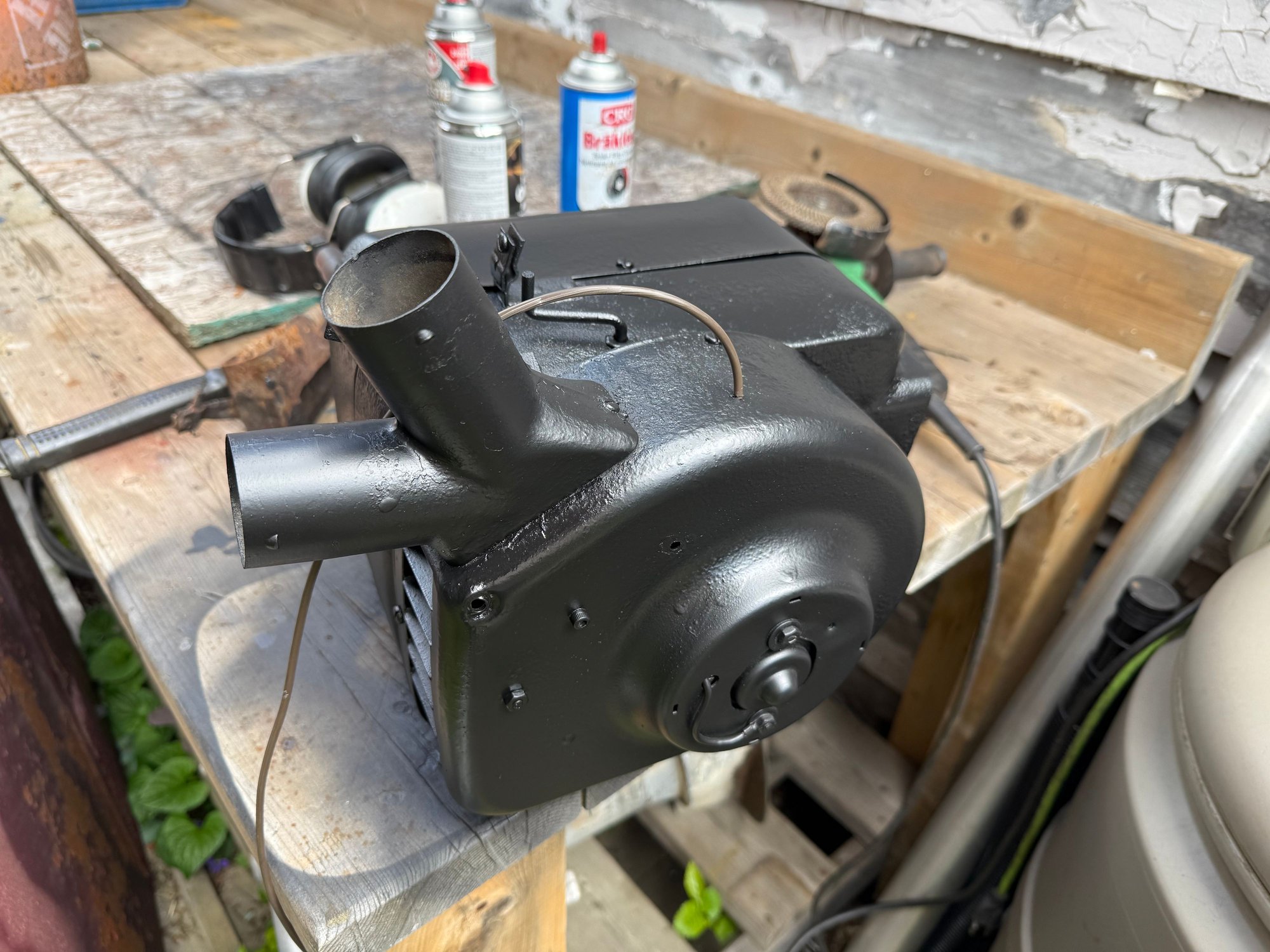

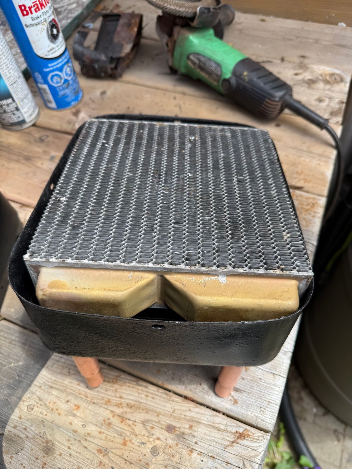

This weekend I tore apart my rusty non-functional Magic Air heater. My truck has all of the outside ducting removed and the intake hole welded shut by a PO so the heater is a recirculating only, which is fine with me. The heater core was rotten and leaking. I replace it with a heater core from a 1984-86 Ford Econoline. The part was listed as a Ford Ready-Aire E6UZ-18476-A. The coolant tubes were too short on the new core. I couldn’t sweat the tubes off without removing the tank. I opted to use 1/2” copper couplers from the local hardware store instead. The tubes needed to be bent a little. In hindsight, it would have been better to enlarge the holes in the heater core housing and the firewall. I didn’t do that. It still worked out fine. I’m posting in case this info can help someone down the road.
