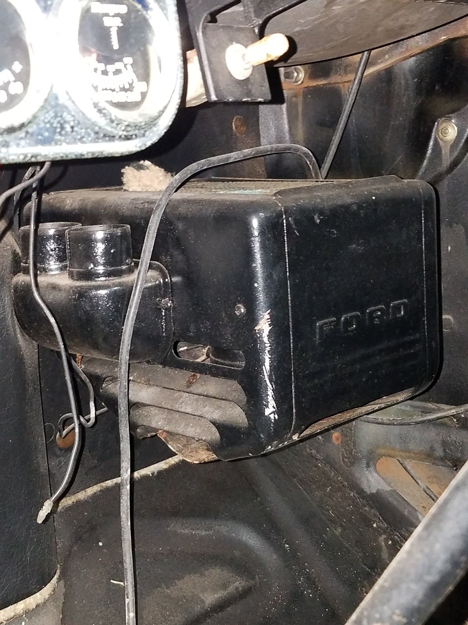

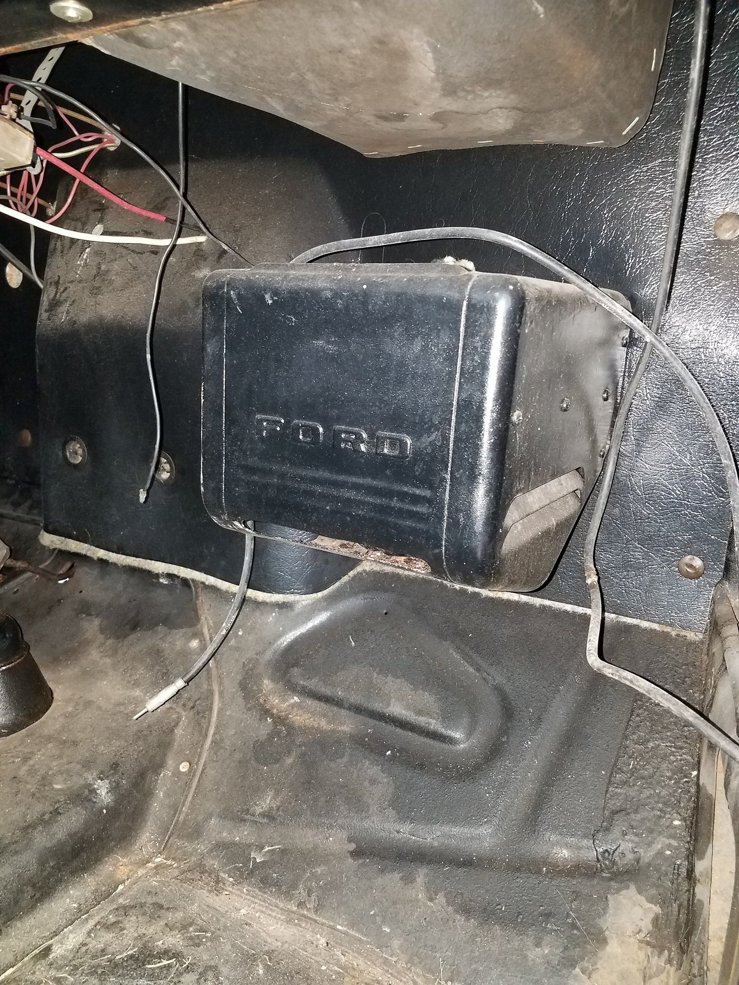

Nothing "Franken" about your heater. It's just the standard F1 heater found in most trucks for 1952. I have one just like yours. In fact, just this week, I caught up with Denny on his annual Parts Safari and purchased a refurbished replacement from him. Here's a pic of my new purchase:
And one more:

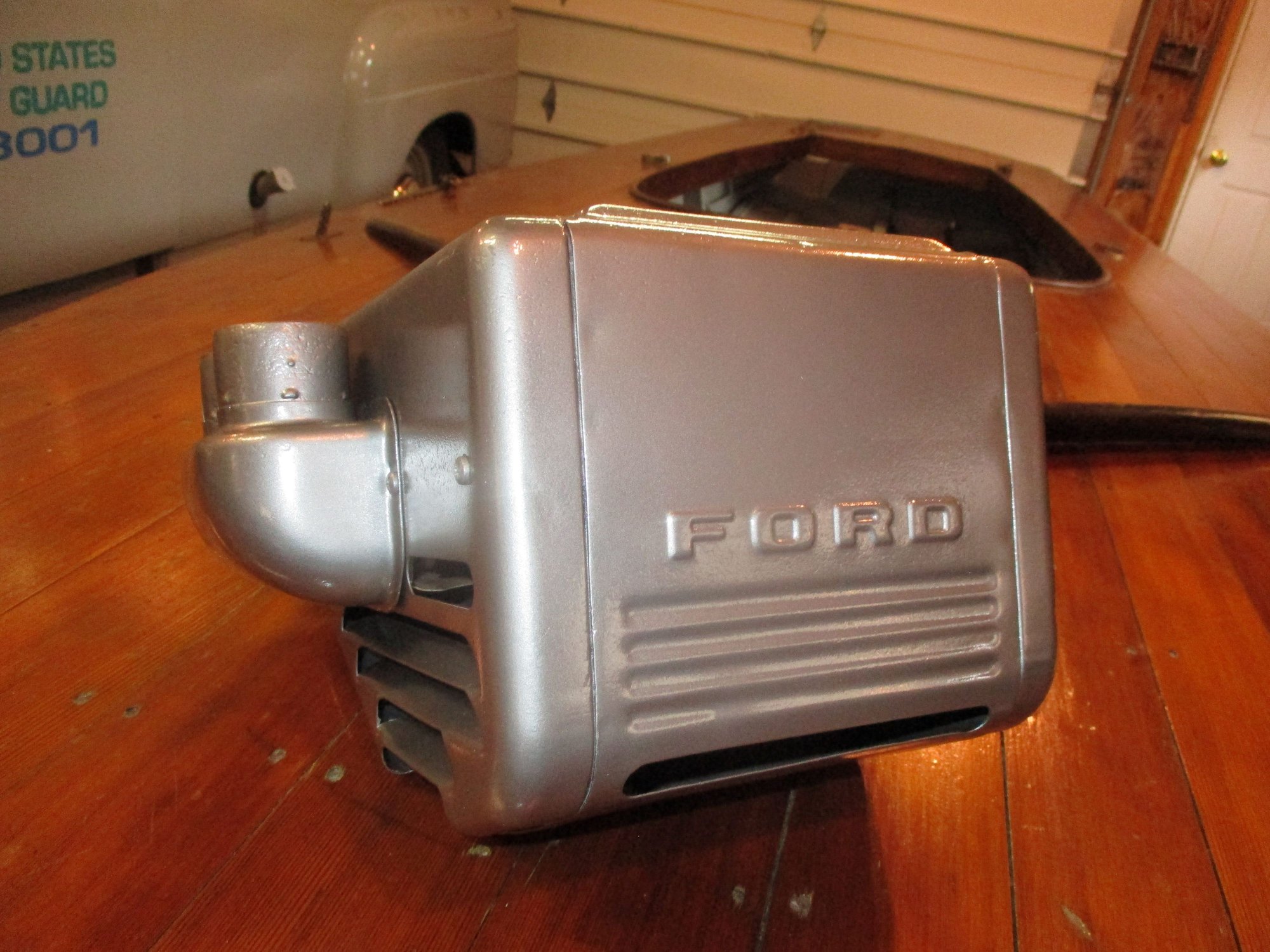

That is the heater

Old Oct 13, 2019 | 11:41 AM
bigwin56f100's Avatar
bigwin56f100
Joined: Jul 2003
Posts: 9,375
Likes: 1,734
From: AKRON ohio
That pic is if no help. That is the deluxe heater the OP has the standard heater
Qwist on a bicycle! Pic makes no reference to standard or deluxe, it's the only pic there is, so I posted it.
Old Oct 13, 2019 | 01:20 PM
bigwin56f100
Joined: Jul 2003
Posts: 9,375
Likes: 1,734
From: AKRON ohio
Deluxe is the fresh air
standard is the recirculating type
the OP has the recirculating type
