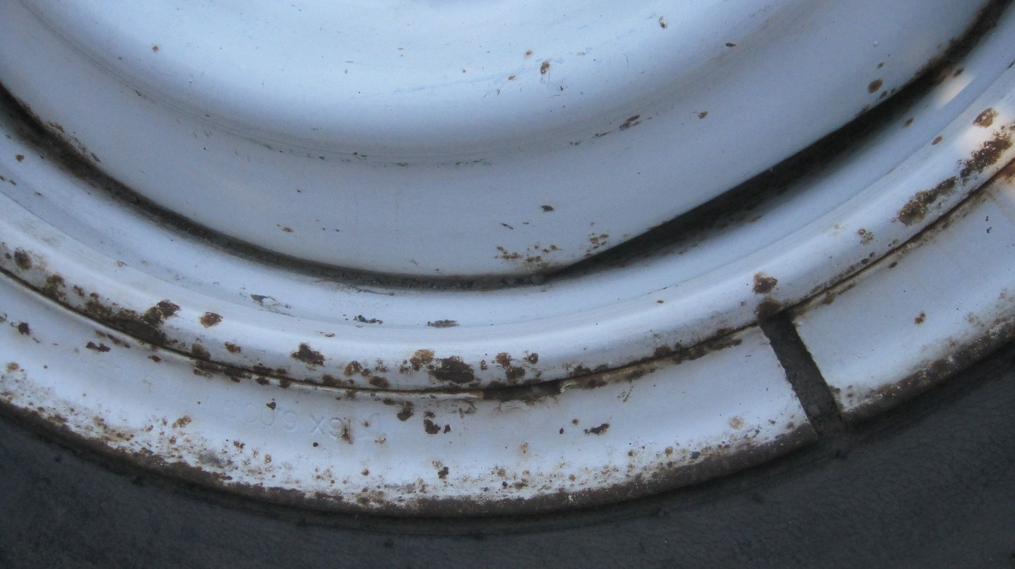

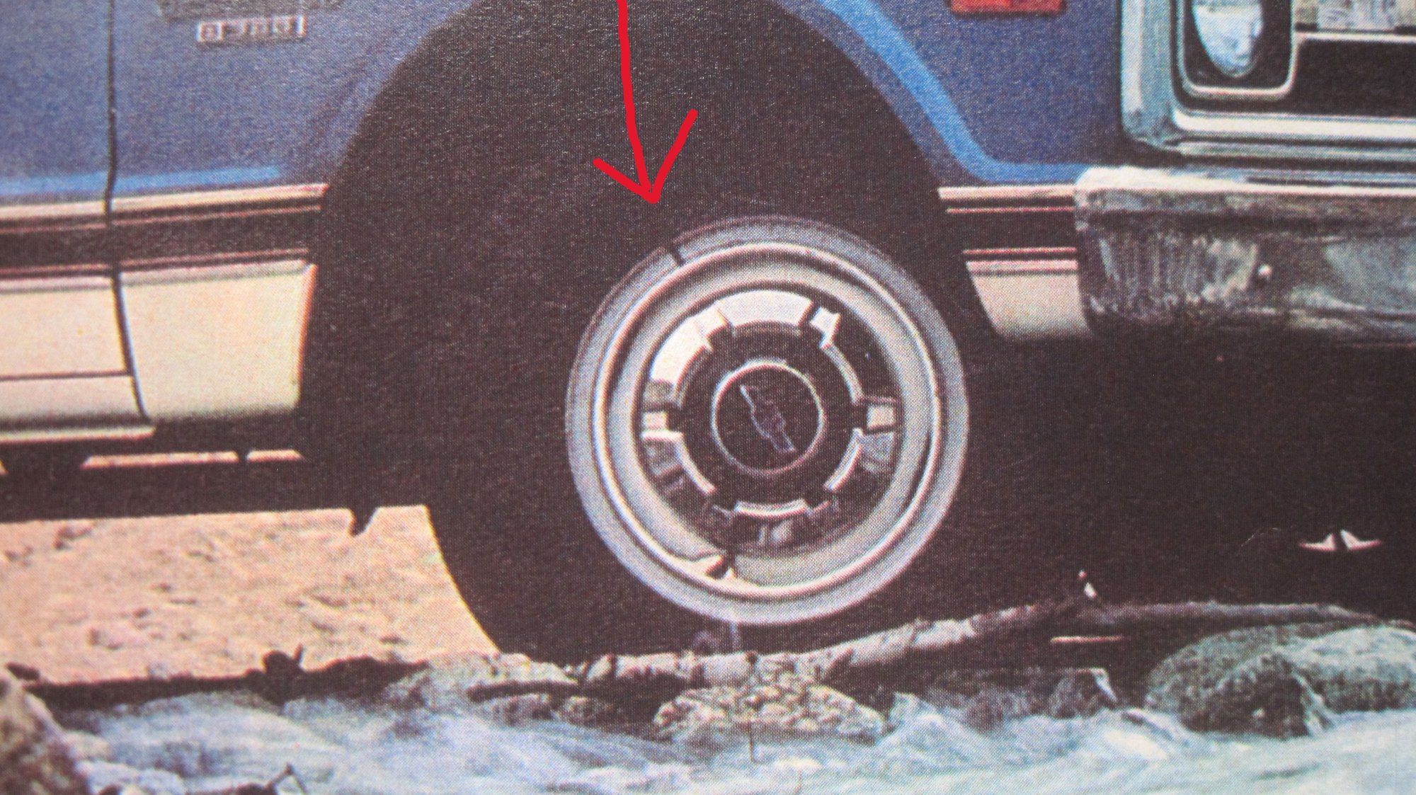

Some 16" 2 piece wheels were made with a continuous solid lock ring ( first photo '66 F 250 16" 2 piece lock ring) and some were made with a physical gap ( split) in the lock ring ( second photo '69 Chevy C 20 2 piece lock ring). Probably due to manufacturer, Goodyear, Firestone etc. Both considered lock ring type wheels, not spilt rims. Again they were considered the heavy duty option, not a drop center design, but a flat base design, heavier construction and by having tubes, held air pressure much better when heavily loaded in off road rocky terrain.

Some 16" 2 piece wheels were made with a continuous solid lock ring ( first photo '66 F 250 16" 2 piece lock ring) and some were made with a physical gap ( split) in the lock ring ( second photo '69 Chevy C 20 2 piece lock ring). Both considered lock ring type wheels, not spilt rims. Again they were considered the heavy duty option, not a drop center design, but a flat base design, heavier construction and by having tubes, held air pressure much better when heavily loaded in off road rocky terrain.
Yes, the first photo is what I have on my F250. Thanks for all the information. Since they are not the dreaded split rims, I might as well just leave them alone. It's comforting to know that I can count on them to hold their air...

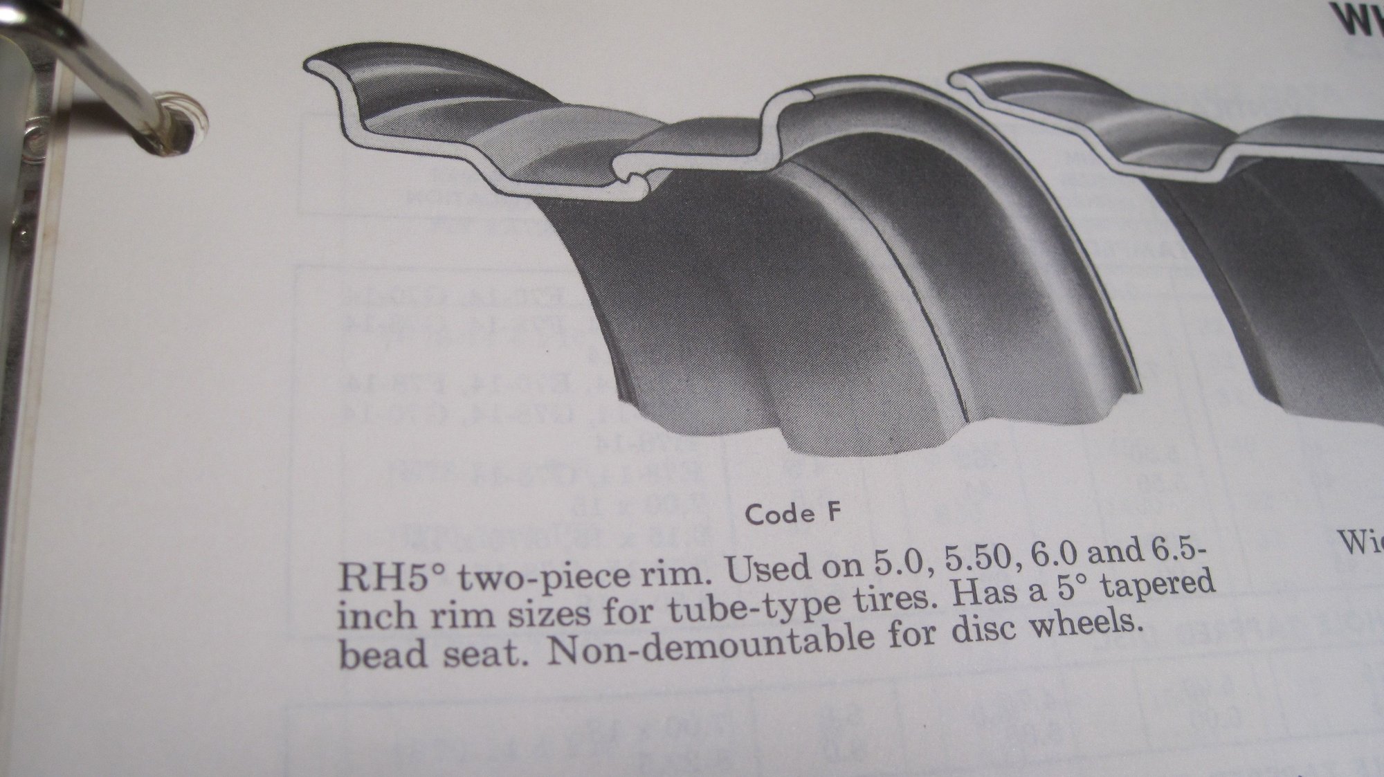

Originally Posted by tripleframe
Split rims were more commonly found on 50's and 60's 2 ton trucks with 20" rims, they were a bad design and are considered dangerous by many, the 2 pieces connected in the middle.
A visual of the wheel that gave multi piece wheels a bad name.
