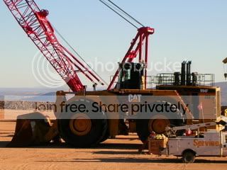

Split rims on steroids:
There is nothing wrong at all with a split rim, other than being archaic technology that few today are capable of properly servicing.
Proper bias tires are still out there, you just have to search for them. An industrial/agricultural supplier would probably be the most help.

PS: Catskinner...what model cat loader is that? 992? It's big enough alright!
Looks like a 994, typically they run 57"x44" 5pc Wheels with 55/80R57 Tires.
