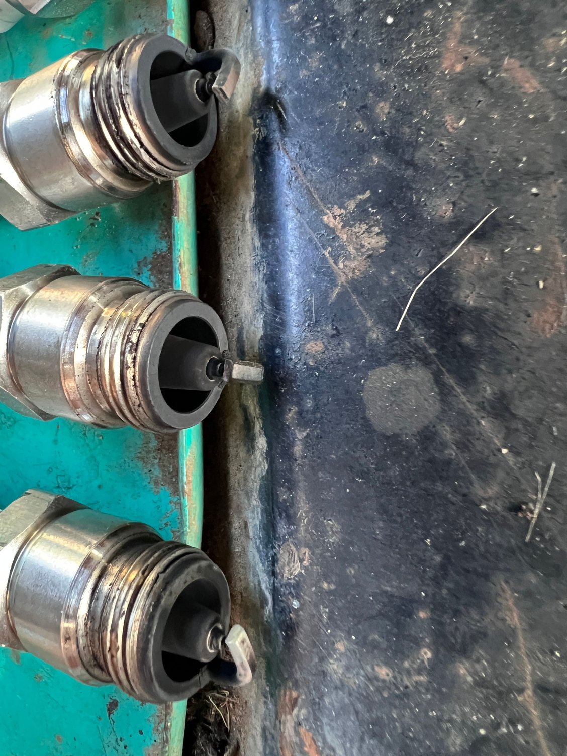

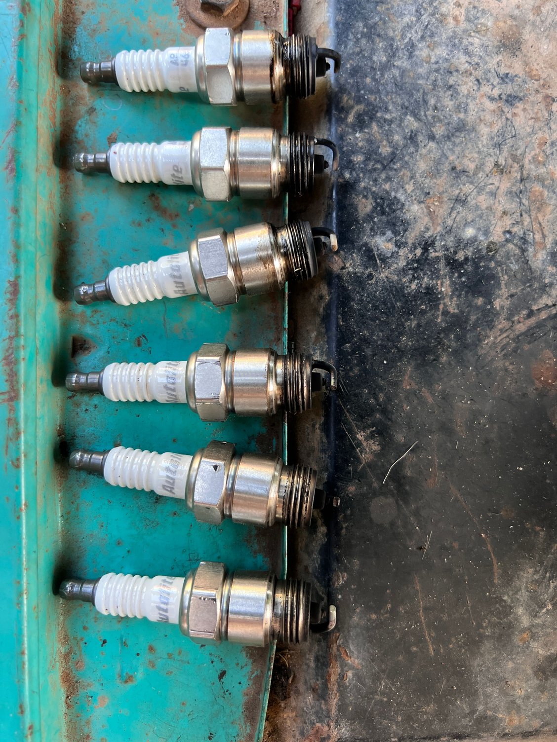

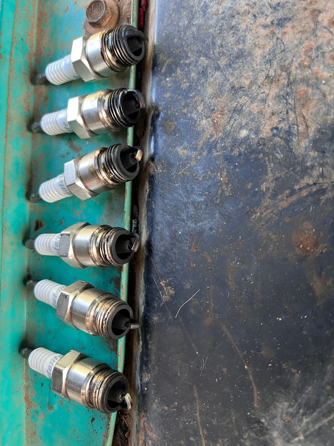

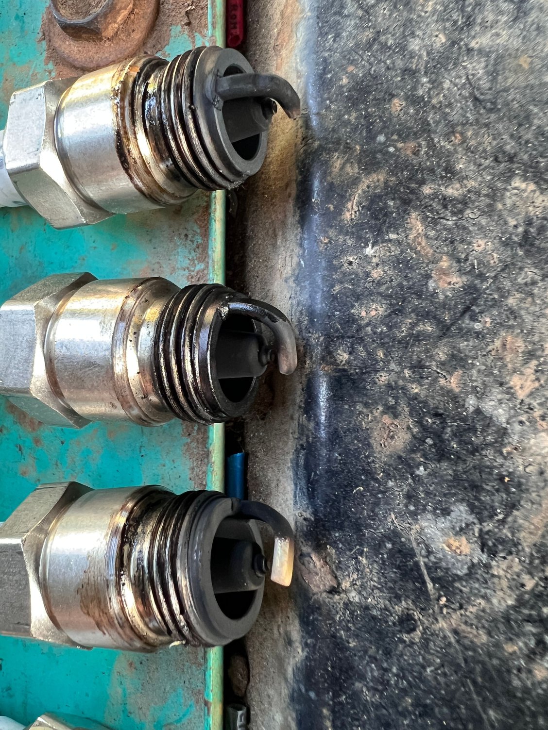

Update: fouled spark plugs
Life happened, finally got back to the truck for a bit and pulled the spark plugs. Can anyone help me diagnose these? I bought new spark plugs, cap, wires, and vacuum advance.
Bottom to top, 1-6
Bottom to top, 1-6
1-3 bottom to top
1-3 bottom to top
4-6 Bottom to top
4-6 Bottom to top
