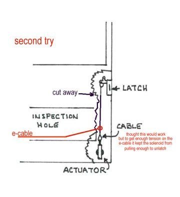

I’m working on a problem I discovered accidently. I have electric solenoids that open my doors.
Press the button…solenoid pulls the cable on the latch and the door pops open. One evening out with my wife we encountered a dead battery. Not a problem if you are outside, but for some reason you were inside…
well, we’re too old to climb out the window. I have a somewhat claustrophobic wife and this is a BIG problem for her.
I’ve tried several fixes including the original door hardware but nothing is doing the trick.
My first attempt is to mount a hood release cable on her kick panel and route the cable thru the kick panel and lower hinge to the inner door, but I haven’t found the right combination to trip the latch.
I tried anchoring the cable housing to the inner door face and attaching the end to the latch where the solenoid cable attaches. I’ve also tried mounting the cable so when actuated it pulls the solenoid cable
But if I get enough tension on the emergency cable it prevents the solenoid from pulling enough to actuate the latch. I’m two days into this and getting frustrated. Looking for alternatives…
surely one of you has solved this problem. You also have to consider I’m working blind behind the door panel by feel and mirrors WITH all the window stuff to contend with…

I did it very similar to your bottom illustration . Outer sheath of the e- cable is secured in line with the cable pulling the latch, just keep enough inner cable out of the sheath so it flexes enough so it doesn't interfere with the unlatching function.. This what i did on my panel because I have the shaved handles on the outside only and needed a means to get in if I happened to lock myself out. Not a problem if I'm inside because I have inside handles. I thought you installed something already for the inside...
I did try adding the original hardware but couldn't get actuator bar to connect directly to the latch...used a spring between them and it was hit or miss on working...wives don't like hit or miss
I might look back at that and fabricate up a new actuator arm that will work properly... big obstacle is working blind inside the door. I'm about ready to cut out a section of inner door

I didn't take pictures of my setup simply because it's my secret entry. Couldn't you use a choke cable mounted under the dash then run through a wire loom to the door and then anchor the outer sheath to the turned up vertically in line with the cable from your actuator . I used thee brass fitting from an electrical Mar connector to tie the cables together which allow some adjustment if needed..
